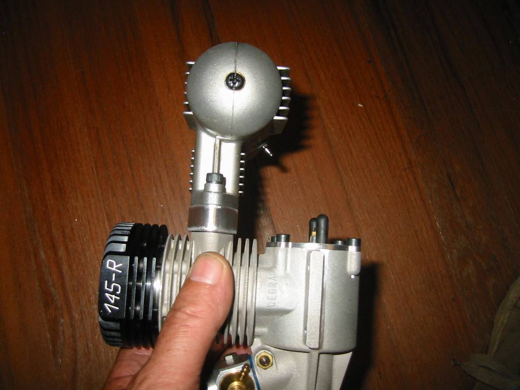

I have a pair of new/old webra speed .40's these engines are abc, wtih dynamix carbs, and need strap on type mufflers. There are no muffler mount lugs cast into the cases.
Can anyone tell me more about these engines? What vintage would they be? I know the later speed 40's came in ABN and ringed flavors, these are chrome bore with no rings (abc) and I can find very little info on this configuration.

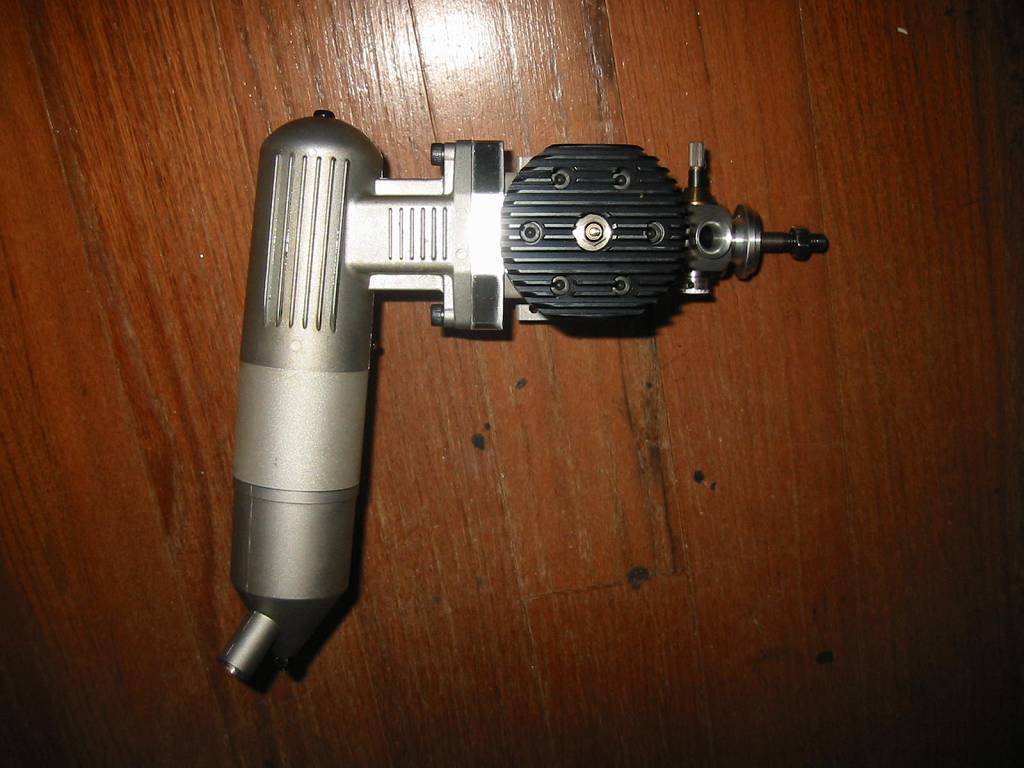

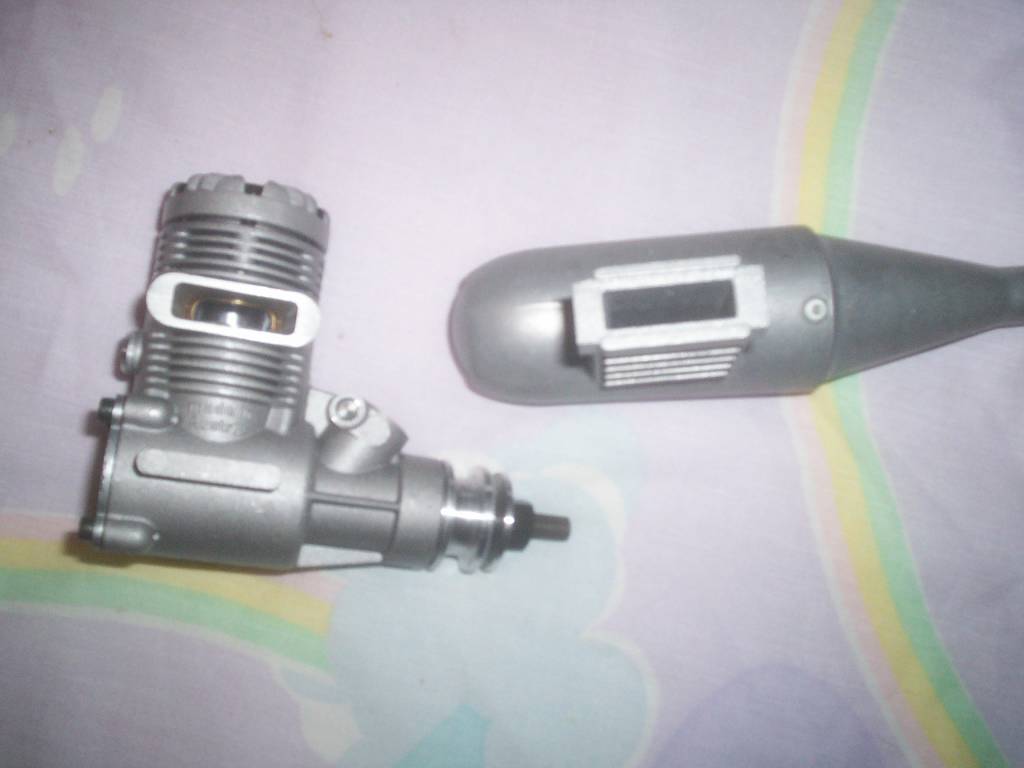

I guess I should have mentioned that I do have the webra strap-on mufflers. BTW, the mufflers have a large outlet, I hope I can get enough tank pressure for the dynamix carb to function properly.
Here is a (poor) picture of one of the engines and a muffler.
Those true ABC Webra's are fantastic engines. I have never had a problem using the strap-on Webra muffler like you have. Just don't over tighten them. The muffler is loud. I have used them as strap-on's with my OS fsr's and MVVS and really like the muffler.

Hi, anyone of you had used one of the newer Webra 40 Speed GT (ABN)?
Its a nice engine?
I heard excellent thinks about this engine, like a excellent carburettor and fuel draw and nice power.
Its a nice engine?

Yes, they are very nice engines...great power and throttle response.

I haver just acquired a WEBRA .40 Schneurle from an estate sale, my first Webra, very impressive.
However, it has no muffler and no way of mounting one with screws. It must have used a "strap on" muffler. Like the onse shown earlier in this thread.
It also has a boss and screw at the back part way up the cylinder ... can't imagine what that would have been for.
Now that Webra are gone, is there anywhere I can get a "Strap on" muffler to suit it? Does anyone have a spares inventory?
It's far to nice to keep in box. I want to run it.
