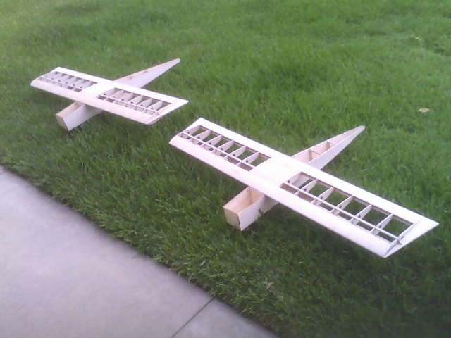

We did get some work done this weekend. One wing is framed up and #2 is on the bench. Its nice to build a whole wing in one piece, I've never done this before! I was lucky to have some 48" 1/6th balsa sheet stock on hand for the leading and trailing edge sheeting but I did have to buy the 1/4" sq and the 1/8"sq spar material My LHS had both in 48" Ed's Covina Hobby Rocks!! Some slight mods, we eliminated a few ribs and added some sheer webbing for strength. I'm sure there is less wood in this structure than stock yet it is very ridged. As for the kit, things are going very smoothly! I went ahead and seperated all the parts from the sheets and am very impressed with the wood quality. Nice straight grain, lightweight stuff! And the the laser cutting is outstanding as always. I had to laugh at the "extra" sheet that Eddie thru in (obviously a set up piece) that had a big hole burnt through it.....I guess the laser was on volume 11!!

We made some progress this weekend. Wildtang and I worked side by side finishing up the framing of wing #2 and added the tips to wing #1. We also started on the fuselages. Construction couldn't be more simple, I can see why this was such a popular kit "back in the day" and I'm sure the Lazer-Works kit is much better than the old "die crunched" Midwest kit! I decided to go with a rubber band on wing just for nostalgia but I did want to mention that this kit does provide parts for a cool bolt on wing set up that is an easy mod. I will be using dual aileron servos so that I can eliminate the stock bellcrank setup. Other than that, both planes will be built stock. And of course, tail wheels not nose wheels!

RE: Dos Little Stiks
Thanks for you post, we fly a Little Stik routinely - a real crowd pleaser. It has been in active rotation for about 3 years.
It was built from an original Midwest kit, nose wheel configuration with an OS .25 LA, 9x4 prop. It flies very well, and the .25 LA has ample power, but long or thick grass on the field can make takeoff dodgy. It's not super fast, but it is very aerobatic.
I am posting because I am thinking about builiding another Little Stik as a taildragger for winter use (with skiis), and have an OS LA .40 going spare - it seems a logical combination to me. However, to use a .40 LA, think about the following:
1. The nose wheel takes a lot of space in the forward compartment, so you have limited fuel capacity - therefore you can expect short filghts with a .40. If you go taildragger, you will have quite a bit more space under the hatch.
2. We mow grass with the 9x4 prop on a .25 - longer props e.g. on a .40 will make this worse, at least for a nose wheel setup
3. The stick is fairly heavy anyway, and while a .40 LA will give you plenty of power, you are adding quite a bit of weight vs. a .25 motor.
We've just finished a Sig Kobra and inherited another .25 scale plane, and based on the Little Stik experience are planning to get an OS .25 FX for the Kobra. The .25 FX would probably be ideal for the Little Stik as well.
Please let us know how you project goes, and good luck - you will enjoy this plane!

Nice looking stik! I think I've decided what we're going to power these babys with. I did some homework and it seems that the GMS .36 has as much power as the OS .32 yet weighs 2 oz less and costs only $57.99 vs the OS at $124.88. I've had great luck with GMS motors in the past so I think this is what I will go with. I was going to go with an OS LA .40 but after comparing the two I think the GMS will be a better chioce. I do have an LA .40 so I might just buy one GMS to see how they compare in the planes before I buy two

Thanks for your update - the GMSs will have plenty of power. I would be very interested to hear how your Stik behaves at full throttle, as the stik wing is relatively thick.
Your plan to buy one GMS and try the other with the .40 LA is good, I am still planning a 'winter stik' powered by a .40LA, so would welcome a report on the .40 LA if you try it. With our nosegear setup and small fuel tank it just isn't worth the time and trouble to swap out engine mounts and try it myself!
I saw from your other post that you are going taildragger (good choice), and also duel aileron servos. We built ours with a single servo and bellcranks (partly because we wanted a 'period piece'); it is a good setup but 2 aileron servos is a better plan.
We are getting an OS .25 FX in any case as the Kobra engine bay is tiny - no room for anything bigger. We may break it in on the Stik, if we do I 'll let you know how that works.

Thanks for the compliments! This has really been a fun project. I'm amazed how quickly they're going together. Another cool thing about this kit is that it has some updates. I mentioned the bolt on wing option but the mod I like the best is that the fuselage is 1/2' wider than the original. Eddie @ Lazer-Works explained to me that this was done to make mounting a larger engine mount easier and it also it gives you more room for radio gear.
For pushrods, I opted for the solid rod thru a plastic tube setup for the elevator and rudder, anchoring at each former. I like this setup better than the suggested wood dowels because theres virtually no way for it to flex.
You mentioned building a "winter stik" I think thats a great idea! If you don't already have a kit, I highly recomend this one. You can't beat the price($37.43) or the service. As for how it will do at full throttle, I don't think I'll be doing any high speed passes, I mainly want the power for verticle manuvers. I'll post more pics next time after I get some more work done. It was over 100 in So Cal today, so I don't think I'll be sanding balsa in the garage tonight!

Using our already built Little Stik fuse as a base, I measured off the prop offset for a .40LA taildragger, with a ski height adjustment, a few fudge factors, etc, and it still looks fine.
I've also reviewed the ski plans from the winter fly guys in Colorado, they have a very nice layout for birch ply skiis; I have worked out a simpler plan for similar size coro skis with a 3/32 bent wire upturned ski tip, 3/32 main gear, and venetian blind/ or yardstick skegs that would/should also work. Weight ought to be comparable, with no performance penalty (at least vs any other plane with skiis).

Well I got some work done on the stiks today, mainly working on the wing servo mounts. I'm going with dual aileron servos so I had to come up with a way of mounting them. Not a big deal but its amazing how much time you use up trying to figure out the easiest way to do this! I will post some pics tomorrow, I plan on spending most of the day working on these babys. I'm hoping to have them ready for covering by tomorrow nite
