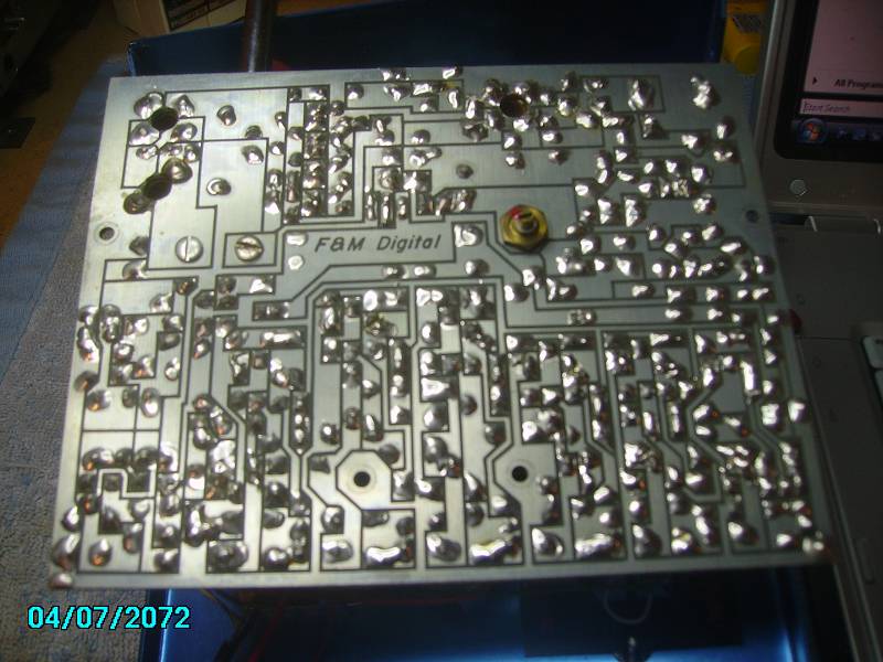

I have been folowing the F&M transmitter/Futaba Reciever incompatibilites. I have an F&M transmitter/Futaba Reciever. And know enough about electronics to be dangerous... I am an engineer and like to learn as much as I can. Ok...I know the transmitter "pots" feed into the encoder, the encoder puts the signal into pulse train with a sinc pulse then a varible time pulse for each channel depending on the position of the transmitter stick. This gets transfered onto a carrier which goes to the reciever. The reciever detector gets the signal and sends it to a decoder section and then syncs with the sync pulse and decodes the information. This decoded information is then sent to the servo by a signal telling the servo where to go. (If this is wrong let me know). For a new style reciever this is a dc pulse of .5 Volts that varies from 1ms to 2ms with 1.5 being the center that pulses every 6ms(I looked at it on my scope). If I am wrong on this please let me know.
Ok, from what I can tell the sync/pulse reset time is basically the first signal from the transmitter to the reciever. So one could either change the timing on the reciever or the transmitter? Also the Neg vs Pos pulse could be changed by reversing the diode detector in the reciever. So basically I would have to change one cap in the reciever changine the frequency of the detector and then reverse the diode making the pulse opposite from what it normally comes off. Is this what you guys think it would take to make them compatible?
Are there points in the reciever to pull the signal off the reciever so I can look at it? I guess I can just probe around but was wondering if they had factory points between the rf section and the decoder section.
Any help would be appreciated.

#72
RE: Some early digital proportional history
There were also two different modes that systems operated with. One was a fixed frame rate, while the other had a variable frame rate. Both systems had advantages and disadvantages. Here are a few:
Fixed frame rate systems gave better servo performance. This was because the pulse stretcher circuit in the servo could be optimized for an exact frame rate. However, the receiver had to contend with a variable width sync pulse, and if all the channels were giving the minimum pulse outputs, this could be quite a long time (especially with more than 4 channels) or a very short time with maximum pulse widths. A large part of the problem is getting the time constants correct so the receiver can properly reset.
Variable frame rate systems always had the same length of sync pulse, so the receivers were more stable. If minimum pulses were send out, then the frame rate was quite short, and servos might start to buzz a bit because the pulse stretcher inside the servo would not have time to completely discharge before the next control pulse reached it. This caused high current drain (shades of digital servos). If the pulse stretcher was configured to avoid this one condition (all minimum pulse widths), then the servos tended to be very slugish when the frame rate slowed down (all maximum width pulses).
Thanks for the information on converting the F&M transmitter to work with the futaba reciever. I opened up the transmitter and this is what I saw. Of course since I am an aero engineer and not an electrical I am as normal confused. A couple of questions. 1. Where is the diode that you are talking about on the board? 2. Where are you hooking up the oscilloscope? Er..this may be a little off topic but I think it would give at least me a place to start to figure out these old radios. Thanks for your time.
Steve
I don't think ukengineman will mind if I answer this since we collaborated on it.
The diode is the rightmost one directly under the left antenna mount screw.
I just snipped the lead off the top of the diode and then down flush with the back of the board.
Oh- You should be able to get similar scope traces by just placing your probe in the proximity of the antenna.
