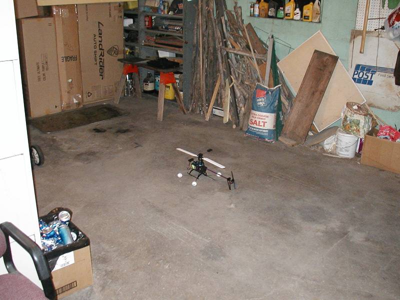

Well, here is another totaly new nOOB in this Heli thing. I was given an Axe for work on my friends truck. I couldn't pass the smog test so I had to actually pay for the Heli. Bummer. :-)
This is the most fun I have had in a long time! I can't hover but am close. I can get about a minute off the ground in my garage. More out side with no wind plus lots of sim time. I think that I am hooked. I can fly airplanes but this is so much more taxing on my brain. This thread is great. I haven't read all the posts yet but I am happy with the Axe.
Here is a pic of my practice area:

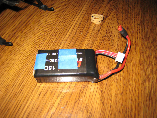

My problem is that the batteries won't fit in horizontal, the frame is too tight. Then when I try them in vertical they don't sit right due to the cut out on the frame. I guess I could glue something over the cutout but then the stock battery wouldn't fit anymore. I was hoping someone had an easy answer that I am not thinking of.
Thanks again

I use to put some soft foam around the LiPo so that it would sit upright and not alter the balance of the heli too much. Then I started to rubber band the battery to the bottom of the frame under the original battery 'hole', but the the canopy wouldn't fit. Now I just put the @#$mn thing in there and let it sit however it wants. All that trouble and it made no difference at all.

I had problems with Li-Po fitment as well. At first I used foam like Alien, but it also kept in heat. A big no-no. Now I use a lexan tray and some cardboard spacers taped to my batteries. The batteries now stay much cooler. Here's some pics.

Thanks alot Heliko,
That is exactly what I hoping to here and see. Your pics were a big help. I made a similar "tray" put of lightply. I am also going to use velcro and a strap. The other way I am considering to make this better is to attach a small weight to the battery tray and then put my batteries under the main frame behind the motor. This would make it sooooo much easier to change the batteries. For proper balance the heli would only weigh the weight of another battery. I think that this will work.
Thanks again for the help.....this forum is great.

Glad to help Johnny.
A word of caution though. That extra weight your talking about will probably have a pretty big impact on flight dynamics especially at your altitude. The heli will most likely seem more sluggish and the added weight will also have an effect on flight time. Give it a try I guess, but I'm pretty sure your not gonna be happy with the adverse effects.
That said you're right about changing batteries. It can be a little cumbersome, but here's the way I see it. It gives the motors a little rest between packs. I know this really doesn't seem like a big deal with the 4-5 minute runs we get with the OE packs, but the 12-14 minute runs that li-po's give us can get the motors pretty warm.
Also since I'm on the subject of caution, be careful with the cheap Li-Po chargers. They're cheap for a reason. Do not leave them unattended during charging and check the Li-Po's temp during charging to make sure it's not heating up. If they build up too much heat during a charge the best case is the pack will be ruined and the worst case is a cell or cells may burst and as soon as that Lithium hits the air it will catch fire.
Remember,
it's all fun and games,
till your Li-Po bursts into flames.
Seriously though these batteries demand our respect.
