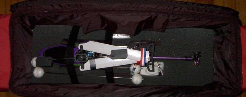

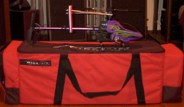

ORIGINAL: strtykrincognito
Hey folks.. Thought someone might appreciate this:
If you want a pretty nice tote to carry the AXE CP around in, for the price I recommend this:
http://www2.towerhobbies.com/cgi-bin/WTI0001P?&I=LXMNZ2
Just waiting on the replacement GY240 now from Tower on a swap.. already have the mini-ESC to snap in too..
