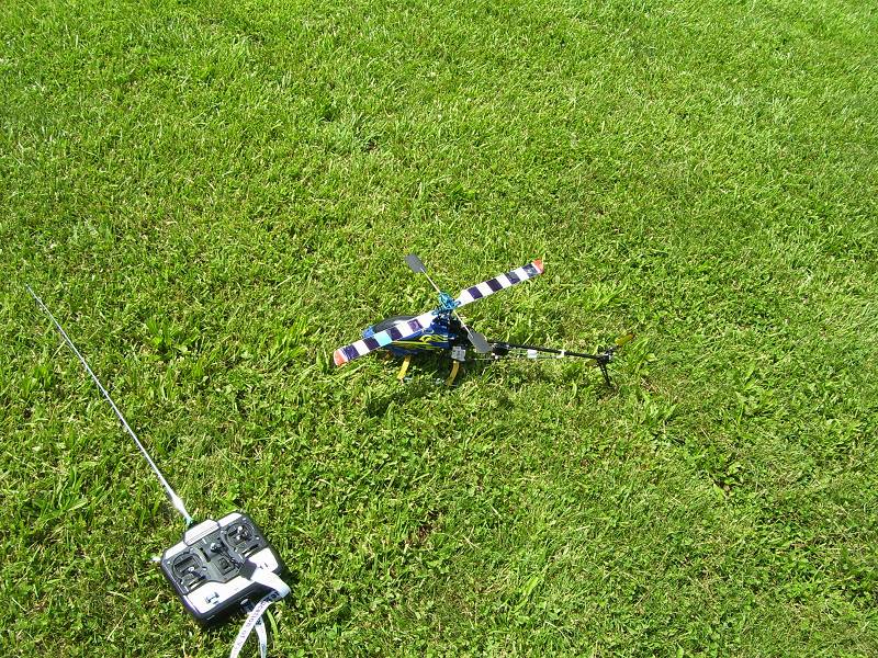

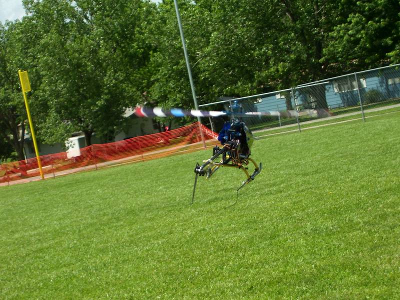

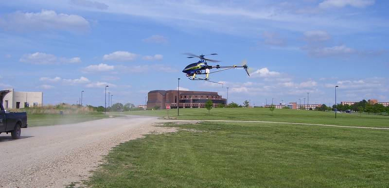

So I thought I'd post here. I just joined this forum a few hours ago and I was looking for some place to post some pics of my Axe. Tell me what u think. I also have vids up on youtube just look for dragus359 and u can see all my vids.

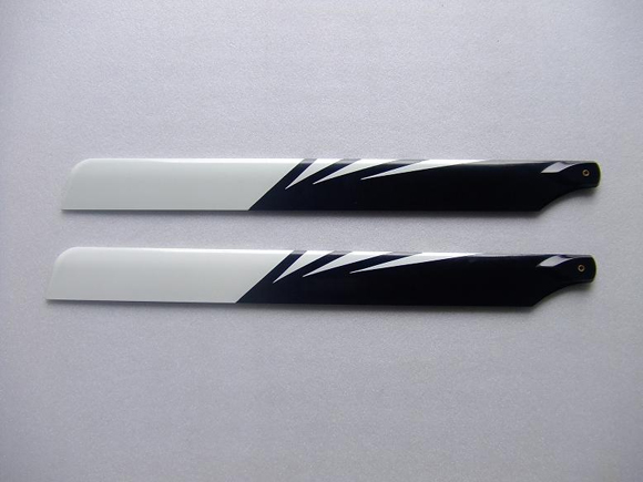

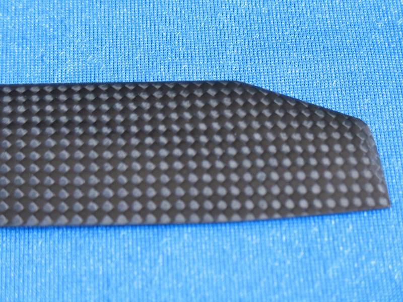

hello everyone,
we made the carbon fiber blades and fiber glass blades.
www.lz-star.com

Please post prices & exact dimension from CL of pivot to edge in inches.
