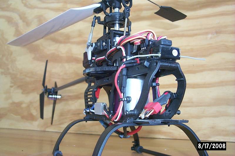

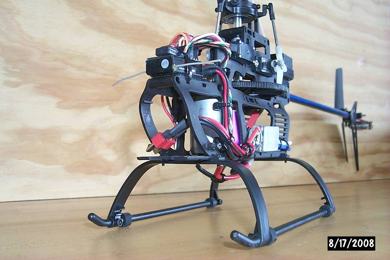

I recently removed the 3 n 1 and replaced it with a GY240, 25A and 12A brushed ESCs.
A few months earlier I replaced the radio gear with DX7/DS285s/AR6100 and added ball links to the servo control horns.
For me it completely changed the feel of the copter and was well worth it for me. It is much smoother now and fun to mess with the programmable Tx features.
I have the bell/hiller parts waiting but it flys so well (light sport style) I'm not sure when I'll put it on.
Over time I sold ALL the stock electronics on Ebay and applied that to the cost of the "separates" components.
Too bad you can't buy the Axe without the "electricals".

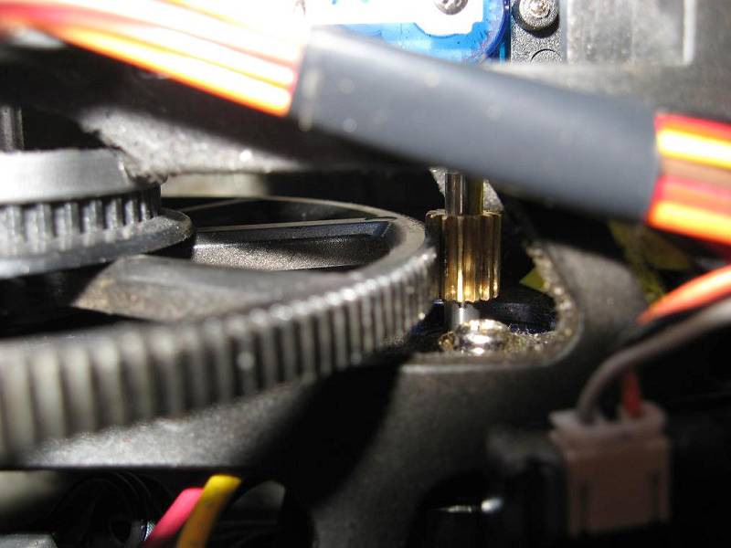

Well its been really windy and rainy here in S. Fla so I had time to take some photos of the "total separates" (brushed) conversion. I have about 40 6min. hovers/light sport flights since the conversion. (Edited for spelling.)

r william,
Your work looks very neat.
I'd like to know what brand of esc you used for the tail and main motors.
I notice you have not cut a "notch" in the sides of the main motor heat sink to uncover the motor's cooling vents. My experience has been that the main motor runs much cooler with the cooling vents exposed. Any reason you have left them covered up?
Thanks.

Thanks for the complimetns gents,
The Axe and all mods were bought from Tower H.
Stock CP-L w/$25 discount coupon Jan '08
25A ESC (Main), 12A ESC (Tail) both ElectriFly w/decals removed (June '08).
Futaba GY240 (June '08).
~$130.00 in: damaged/crashed blades, main gear, main shaft, f. spindles, tail boom, and blade grips.
3 additional 11.1v, 910 maH batteries.
As soon as I have to replace the main motor I will modify the heatsink!
