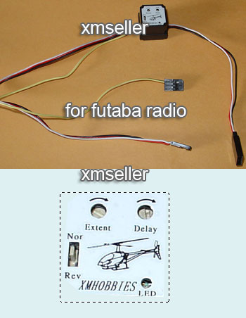

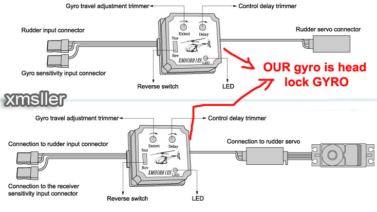

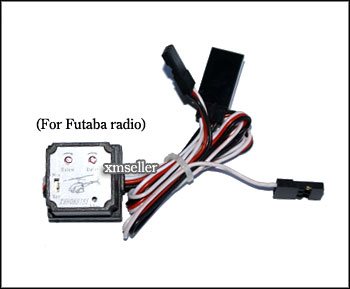

I have ordered a gyro at http://www.cnchelicopter.com/servlet...yro/Categories and am now looking for a cheap compatible esc unit, for the heli max of course. Do you have any suggestions? Gyro below.
