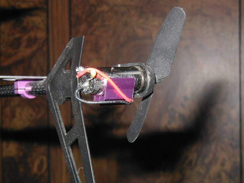

I just burned up my second Heli-Max LPM E-board Axe CPv3. I need help figuring out what is wrong here before spending any more time and money.
The first Heli-Max LPM E-board Axe CPv3 likely burned up after I had replaced the tail motor (loose connection) with a new motor. I replaced the motor again (3rd), then realizied the first Heli-Max LPM E-board Axe CPv3 was badly burned up, not the motor, when the 3rd motor did not work. Then, I replaced the Heli-Max LPM E-board Axe CPv3, and again did not find any tail motor operation, as this Heli-Max LPM E-board Axe CPv3 also starting burning up in the same spot.
I welcome all suggestions here on firstly figuring out what is wrong, and secondly how to correct it from reoccurring.

There is a screw that holds the tail motor mount to the tail boom which has caused problems in the past. The wire for the tail motor runs through the plastic tail mount and some have found that the screw has penetrated the wires inside. Have you pulled the wire from inside the tail boom to be sure its not been shorted?

Given that the screw that holds the tail motor mount to the tail boom has caused problems in the past, I visually checked the wire for the tail motor runs through the plastic tail mount . I removed the screws at the tail motor mount and removed it from the shaft, but did not observe any damage to the wires inside. I have a DMM and will measure the resistance of the leads to the motor to look for a short.
I tested the 3rd (as well as 1st with loose connection and 2nd) motor with a 6V battery pack to see that it operates as expected with power. Thus, it was not a bad 3rd motor.
Perhaps, heating of the motor connections during soldering/replacement damaged the E-board resulted in a short internally or to the case. In hindsight, I should have removed the connection from the E-board to the motor before soldering the new tail motors to the wiring. However, I thought that the motors were burning up, not the E-board until yesterday.
How do I check that the capacitor (on the motor, right?) has not somehow shorted or it's leads have?

This sounds really strange to me. If your smoking a fuse instantly on startup, there must be a short somewhere in the tail motor circuit. I have an Axe CP that I've upgraded to the V3 version, and I also had to desolder the tail motor to install the carbon fiber boom. After finishing the upgrades, the bird works perfectly, no tail motor fuse. I'm attaching a photo of my tail motor showing the wiring & setup. Does yours look like mine?
You mentioned extra heat during your soldering. Did you replace the capacitor on the tail motor as a test? Capacitors 'soak' up current to provide a softer start to the motors. Maybe yours is damaged from heat. Components are made to take some heat for a short period of time, but not a very high temp for a long time. You may have also melted something internally in the plastic motor brush holders. Did you try a different motor? If you did, did you also solder the different motor? Are you just touching the connections with your soldering iron just long enough to melt the solder and make the connection? What type of soldering iron are you using? Also, you can see in my photo how the wires touch the heat sink. Perhaps you have some damaged wire insulation that is grounding out during the startup / vibration of the heli?
Hopefully I've given you some things to look at / think about. Good luck!
DrS
DrS
Joined: Aug 2005
Posts: 285
From: West Chester, PA
Does yours look like mine? Yes
Did you replace the capacitor on the tail motor as a test? No, as Heli-max said this is only a filter for noise, not impacting the amperage.
Did you try a different motor? No, two EFLH1322 are on order to try.
If you did, did you also solder the different motor? This is my 3rd motor that I have soldered - it works, but blows the 3amp fuse.
Are you just touching the connections with your soldering iron just long enough to melt the solder and make the connection? Yes
What type of soldering iron are you using? Resin core type from Radio Shack for hobbiest.
Perhaps you have some damaged wire insulation that is grounding out during the startup / vibration of the heli? While I did not remove the entire, it looked fine when I removed the motor for its replacement. I will replace the wiring that has zero ohm resistance using DMM, if nothing else is found.

...Can you post a photo or get a friend to help you post some? We all want to see you flying instead of fixing and could be more helpful if we could see your equipment.
Mr bdelmonte,
The first flight of approximately 10 min went fine, but the second flight ended in a crash due my loss of control with nose in hover. No fuses blew during these flights, but I need to recheck after the crash. The parts for repair are on order for those not already in my stock on hand.

My pic would not upload due to its size, but all it showed was hot glue on the connections to the tail motor.
I flew my Heli-max AXE CPv3 three times this week with no problems. I suspect that the loose bushing connection in the tail motors after a crash or roll-over was shorting and causing my prior problems with burned up E-board.
