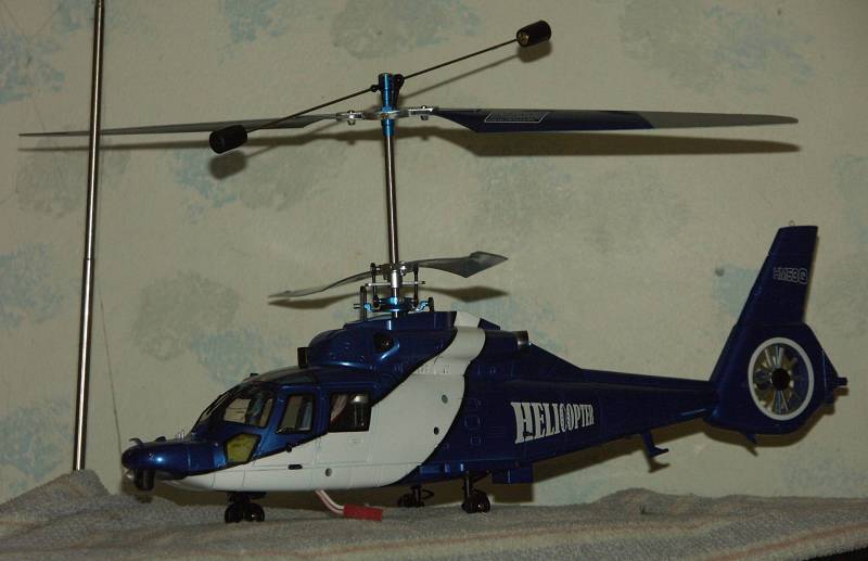

My first rc purchase was the Axe CPV3,it would never act right,no matter what I did,after a crash,I took it to a LHS repair center,they "fixed" the damage for about $38.00,not bad I thought,but when I got it flying again,it was a wild bird indeed,just as before,so I searched around,found out about hobbyservices and sent in the heli,after 2 weeks I had a brand new CPV3 with the note saying the 3in1 was defective,so it was better for them to just warrenty the whole thing.If I had it to do again,I would never have bought the CPV3,I order the Esky CP v2,I have a feeling that will be a more stable friend with my Walkera HM53Q heli,which is a good flyer as well as a GREAT shelf filler,I am learning that this can be an expensive,hobby wont be proper here,so I will use the word "undertaking",but hey ,call me demented,even the crashes can be funny......................gotta love em....................
Just the thought of one single not tooo well adjusted person...............
Photo is of the Walkera HM53Q...........
