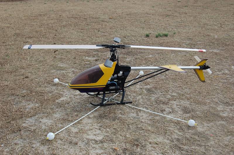

Just a quick pic of her in one piece.
After removing and examining the damaged piece, I found that the bottom (grooved) side of the top portion of the belt was rubbing the top of the plastic link. I have the belt as tight as I can by pulling on the tail boom. When flying, I wasn't paying attention to the tail rotor (just the movement of the helicopter), but another club member was. He told me that at certain points, the tail rotor would almost stop. That is most likely the point at which the belt is rubbing the link. I noticed it doing this when spinning it up last week, and set the servo travel to stop it. Upon arrival to the field today, another thing that I forgot to mention in my earlier post that I noticed in addition to the flybar issue, was that the tail belt was a bit loose. I loosened the tail boom mounting screws on the frame, tugged on the boom as much as I could and tightened the screws to secure the boom. After this, I checked the belt tension to find that it was now nice and tight. I now realize that my fatal error was in increasing the range of the rudder servos travel to the left (where I had reduced it before to prevent the rubbing). I had increased the travel only until I saw daylight between the link and the pulley at full left rudder. What I should've done, however, was to have the blades turning just enough to keep the tail rotor spinning, then adjust the left travel until it no longer stopped or slowed down the tail rotor. As soon as the rain clears up (hopefully tomorrow afternoon), I'll take her outside and get that adjusted. If it dries up early enough, I'll take her back out to the field and finish trimming her out and move on to getting comfortable with hovering her in all orientations.

Went back to the field today after the repair. Checked for the tail rotor stopping (didn't seem to be doing it anymore), and attempted a couple of hovers. Didn't get her up but for maybe a couple of seconds at a time due to the wind [:@]. I'm not quite to the point where I can handle much wind, and it kept wanting to blow the helicopter around quite easily. I'll be back out there sometime this week to try it again. Hopefully there won't be as much wind.
My wife got a couple of decent shots while we were there (we were the only ones there). The first is of me checking the tail rotor with the blades spinning. The second is of one of my hover attempts. At least I got her down in one piece.

Well, got several decent hovers in today, and one BIG scare.
When I got to the field to pull out the heli, my airplane, and my field equipment, I realized that I didn't bring the training gear. Rather than drive the 30-45 minute 25 mile drive back to the house to go get them, I just bit the bullet and hovered without them. Much more stable in a hover, I do believe. My fist couple of flights had me very nervous, and couldn't get to far into the flight before I had to set her down to take a quick breath and go again. After about the 3rd flight, I was feeling pretty good about my tail in hovers, and wasn't quite as nervous as the other flights. I even started working into side in hovers. I was doing OK with the side in hovers, but not quite comfortable with them.
Towards the end of my last flight of the day, it was starting to get dark, and I had already had her hovering for longer than the earlier flights. I moved into a side hover as I had been doing, then it happened. I lost it. I don't know how it happened, but she took off and started flying out of control over the bean field opposite the runway, as well as over the runway. About this time, everyone in the pits watching ran for cover, scared senseless. Since I was not going over the pits (if she did, I would've bit the bullet and ditched her) and did not want to have to foot the repair bill of her again (not this soon after getting her back together anyway), I continued trying to regain orientation and control. There were a couple of points in the flight where I had her somewhat stabilized and began getting oriented to bring her back in by backing her up over the runway to put her in a tail in hover to set her down. The first couple of attempts at this failed, but she was still over the field and runway, not going into the pits, so I didn't give up hope. Then suddenly, I had gotten her to a point where she was stable and oriented tail-in, nearly in a hover. I krept her back in front of me, got her in a hover, and set her down gently. That incident was enough for me for the day, so I shut her down to start packing up to head home.
I don't know what caused it, maybe mental fatigue from the increased duration of the flight over what I'm used to, maybe the dimming daylight, maybe disorientation, maybe my noobness, or a combination of these. I had been doing some OK side in hovers on that flight, but as the flight drew on, their quality began to degrade each subsequent side in hover that I performed. I noticed that when doing some of those side in hovers, I was sending commands that I thought were the right ones, but were not. Not really disorientation, as the direction was correct, but I was thinking it was tipping one way, when it was actually stable. I also have a tendency to overcorrect in orientations other than tail in if I'm not right on top of it, or have kept it in that orientation longer than I'm used to before moving back to tail in to stabilize.
At least she's down safely without going over the pits and injuring anyone. I'm looking forward to giving her another shot tomorrow if the weather permits it.

Got to burn about 3-4 more tanks of fuel through the Shuttle this afternoon.
My theory on the battery being undercharged was partially correct. After over 12 hours of trickle charging, all servos were back up to full speed. Upon initial startup at the field, I noticed that the engine was falling out of the power band at just over half throttle. Tuned up both the HSN and the LSN and she was running great.
I did, however, notice that her tail does not want to hold very well. I get it trimmed to maintain straight with minimal adjustments on the left stick, but after a couple of minutes, the tail starts drifting in the direction that I just trimmed it to. Get it trimmed back to center, a couple of minutes later, it does it again. I have to do this 3-4 times per flight. It's not flight stopping, as it is controllable, but is annoying nevertheless. Maybe it's time for a better gyro/rudder servo. This same problem also occurs on my 2 coaxial helis, but is less of a problem due to their vastly easier flight characteristics and virtually hands off hover.
Despite all the little "quirks" that I'm experiencing and trying to work out, I'm still loving this heli. So much so, in fact, that despite bringing an airplane to fly as well, I didn't even break out the plane. I just flew the shuttle. Besides, I need more stick time on the Shuttle to get at least good enough to comfortably break into forward flight. Especially if I want the EVO 50 EX in a year or so.
Happy flying.

One more thing while it's still on my mind. Every time I start her up, the main blades turn at idle. If I bring the idle down, the engine dies. It's not a huge issue at the moment, since I can still keep the heli under control until I go to walk away from her to fly. I have just modified my prep to accomodate the issue. Instead of grabbing the rotor by the blade grip at the front of the canopy to see where the tail is going, I grab the rear blade grip to allow the tail boom to rest against my leg while walking to the runway. Once she's on the ground, I maintain a grip on the rotor while ensuring that the blades somewhat straight instead of on cocked off to the side and throwing her way off balance on spool up.
Also, if I hold the rotor head for to long at idle (sometimes just the time it takes to get from the pits to the runway or less), she dies. To temporarily remedy this, I allow her to warm up for a minute or to before going to the runway, then keep the throttle just above idle while carrying her, bringing the throttle back to idle when I release the rotor, then back to just above idle while walking backwards (to keep an eye on her) back to my flying spot.
At hover and above, she has plenty of nice thick smoke coming from the exhaust. At idle, there is no smoke, but she's spitting plenty of oil onto my finger when I hold it a few CM away from the exhaust outlet for a couple of seconds. I haven't performed the "pinch test" to verify the low idle setting.
Once on the runway and just above idle, she runs great now until I shut her off by plugging the exhaust with a covered (for protection from the hot muffler) finger (method I've used successfully for cars and planes that won't shut off by a radio kill switch).
Thanks for sticking with me and helping this poor glutton for punishment out.
Happy flying.

Glad to hear you were able to fly today, I was able to get a few flights in on my Shuttle Plus as well today, got the governor dialed in at 1800 rpm and she's flying sweet!
Your gyro drifting might be caused by any number of things. Do you have the manual on the gyro your using? I've had real good luck with my JR gyro manuals and they've performed quite well once set up. I've had drift issues when the gain was set too low or if I moved the helicoter before it was able to properly initialize its neutral setting. Heat and vibration will have dramtic effects on gyro hold as well. I did a dial indicator check on my Shuttle ZX with an OS .32 and found alot of runout on the fan hub. After realigning everthing the engine was smoother and the gyro held better. Most heading lock gyros dont like to have any trim on the rudder channel. Mine is always in the neutral positoin on the radio but once again, my experience is mostly with JR. What kind of gyro are you using again? I'd like to see the manual if its available online. Its sounding like your gyro is acting more like a rate gyro rather than a heading lock.
As for the idle issues, I have the same problem to some extent with my OS .37. It just seems cold blooded when you first start it and when the idle is low enough to keep the clutch from dragging it tends to quit easily. I'm now using an Enya #3 plug that seems to be a bit warmer than the OS #8 I had in it. I found that once its warmed up after a flight there are no further issues. How does your engine idle down once its up to operating temperture? If the problem still exists you might have an airleak somewhere that's causing you problems or the mixture might not be quite right at idle. You just dont want to have to run the engine so high that it really starts to wear on the clutch lining and over heat the clutch shoes. What % nitro are you using?
Hope tomorrow is good flying weather,
Tony

The gyro is an old Arcamax PEG-S1. These were being used in the 2002-2003 time frame, if not earlier. The company is now out of business. Their website is gone. I don't have the manual, and it seems that no one else has one posted on the internet to view/download. That's one reason I'm thinking about getting a new gyro. If I can get this one to work well, I might hold off until I get into more advanced flight, such as acrobatics (not 3D, not for a long while).
As for the engine, after a flight and I go out to shut it down and bring it back in, I can put the throttle hold on (brings the engine to a lower idle than low throttle stick) and the blades still want to spin again if I release them after stopping them by hand (reaching over the blades, being careful not to get caught in them, and using my palm to stop them, then grabbing one blade grip to hold it from spinning again). Like I said before, I still need to do the "pinch test" for the low end to try to get it better dialed in if possible. I'm running 30% Cool Power Heli fuel (pink in color).
I'll try the pinch test to try to tune it better than by ear/sight, then look through the fuel system for possible air leaks.
