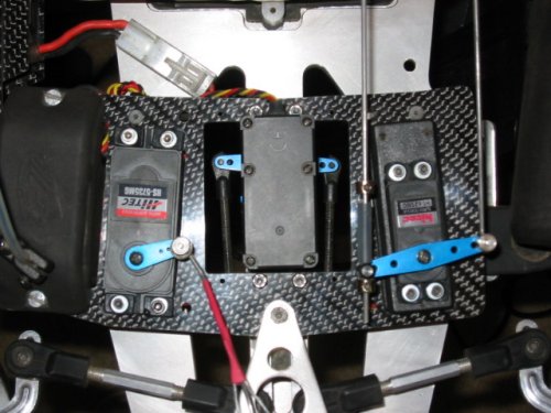

The servo that failed is the one on the right, in this picture. It was set up on channel 3 (front disk brake) which was mixxed with channel 2 (throttle/rear disk brake). at 88% of ch. 2's 100% full range. Sub trims are all at 0. ch 1 is set at the middle on the main trim, the steering is at 4 clicks to the right. Travel adjust on the steering is:L=85% R=78% throttle F=73% B92%. Channels 1&2 are reversed, and channel 3 (aux) is in the normal position. I am using the SPCM modulation.
Anyone see any red flags as to possible problems with my setup?

Todd- Sorry to hear about the problems. The Hitec service info is posted at the top of this forum http://www.rcuniverse.com/showthread...27&forumid=149
Here is my take on this as I have experience in 1/5th scale as well as all other types of R/C cars and racing. A 22 pound car going 60mph+ takes a lot of braking power. Sometime the load on the servos is so much that their life is greatly reduced. The digital servos do have more holding power but they also draw more current. In 1/8th scale on-road where speed and traction are at their highest the standard coreless servos are lasting up to two seasons, but when people started switching to the digital versions from any manufacturer, 3 months was about it. In that class now almost everyone just runs coreless (non-digital) only. This is what we currently recommend for throttle and brakes in all gas and nitro applications.
Hitec is looking into ways to make the digital servos more durable for throttle and brake use in the larger size cars like 1/8th and 1/5th and hope to have a new line of digitals out in the future specifically for that market.
Mike..

Todd- The digital servos are holding up well in 1/8th off-road steering because there is not as much traction as 1/8th on-road. Our team driver Gene Hickerson used 5945's in his 1/8th buggy to finish 13th at the IFMAR World Championships in 2002.
I would use the 945's http://www.hitecrcd.com/Servos/hs945.htm for throttle and brake in your 1/5th scale race car. The 5735 is still OK for the steering, they have been holding up well.

It looks as though according to Mike Mayberry, the problem with the 5945 isn't the servo......its my application. Something I hadn't found out until 3 months after the purchase upon failure and this thread.

The 5735 has a much beefier motor and a heatsink so it should be OK. That is what I have set up in my car but I don't have much track time on them to know for sure.

OK, I also switched out the 5945 for a 625 on the rearbrake/throttle, and to be honest the rear disks dont need much grip and the throttle is easy to operate, so it seems to work fine. Maybe the 5945 was just over kill on the rear brake/throttle, I just dont need 180ozin, 100ozin is fine....and the 625 is quiet too!

Will do Mike, I think the difference with the 5th scale is the fact that when the front brakes are applied, the servo really doesnt have a movement to apply the brake, it simply pulls the cables and as soon as its tight, its like having a steering servo end-point incorrectly set, and the servo is using almost full power against the stop. I think any servo would yell "uncle" at some point.......
