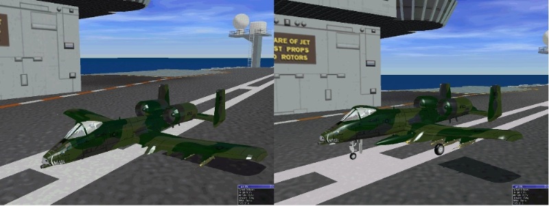

I'm just learning, STRUGGLING I should say, to convert Microsoft Flight Simulator models into easyFly models, for use in AFPD. Apparently it's much simpler to convert them to easyFly than to true AFPD planes. I'm having some <span style="text-decoration: underline;">fantastic</span> results with some models - I've got a few helicopters and planes that I haven't seen ANY AFPD or easyFly models for yet, some very unusual aircraft. If I can get this all worked out, I will upload any aircraft that don't have copyright restrictions and/or that I can get permission to Post.
I have two major, major problems, and wonder if someone out there can help. After I convert a model, I find the closest equivalent model in terms of size and type, and borrow it's DNS file. Invariably, every model I do this with starts out half-submerged into the ground. And no amount of fiddling with the wheel variables seems to get it above the ground. I'm trying to use AOA to find the correct positions, but it seems like I get different numbers every which way I rotate things in AOA. Can anyone describe how to find the RIGHT settings for the wheels, please please???

<h3 id="postTopic82514"><span>the answer</span></h3><div id="postText82514" class="messageBody">Okay, once again I'm going to answer my own question, since I figured it out, in case it might help someone else down the road looking for the same answer. Pardon me for the long explanation, but the short thing I read before confused me, so I'd rather give too much info than not enough. The ONLY piece of info I had found on this subject was on Rodeo's website. But it wasn't at all clear to me.

Now, what confused me was the statement "Positive Z value moves object upwards". I was starting with some numbers like "-0.455". To me, if you ADD to a negative number, you get closer to -0-, right? Not in this case. In order to raise the model up, I simply had to add to each of the variables by the proper amount. And you MUST change all 3 of these variables properly, keeping in mind the formula stated above, or else the model crashes on the ground, before you even do anything, etc, etc. Note that I have put the critical numbers in BOLD to make them easy to see.

After I increased each variable correctly (the math doesn't look right to me as I review the above - but it worked!), the model was raised above the ground to sit on it's nice wheels, as intended. If you only knew how much time I spent figuring this out!! I'm sure there's an easier way to determine the proper setting, but at least I can accomplish this now thru trial and error, and maybe this information and example will help someone else.
