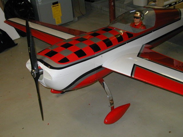

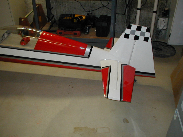

It's been a long time since I posted any pictures, so here they are.

That is a nice looking Extra. If you haven't flown one, you are about to find out that there just isn't much better for precision flying. What servo setup did you decide to go with?

Thank you. I'm going with 8611. One per elavator, three on rudder and two per aileron. I have the servo bays cut out on the stabs for a second servo in case I need it .

You won't need the 2nd servo in the tail. Just don't go over 1.25" on the servo arms and you'll have PLENTY of power.

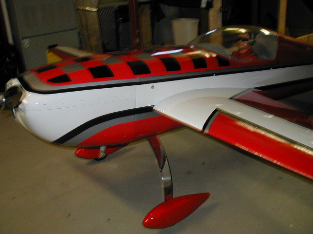

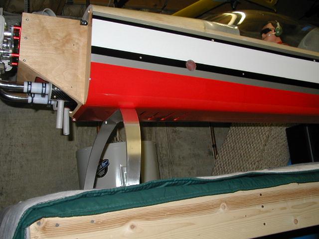

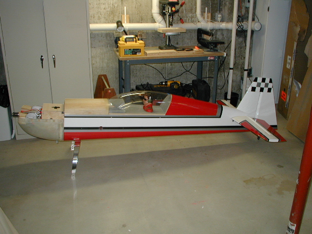

More Pictures.

Looks awesome! When do you plan to maiden it? Or have you already?

Thanks shortman. I'm waitimg for my 8611. Just need to install radio gear.

Just Got back from the JR chalenge. Now I have to get to work to catch up to your carden. Looks very nice man. Love the way you polished the gear . . .

Look at that pretty chrome landing gear. I like it.

What's your technique for polishing aluminum? I worked for four hours the other night, trying to polish a True turn spinner, and it still looks like crap. Any info appreciated!

Hi Pete, try using a piece of threaded rod to chuck your spinner cone in a drill press set to low - medium speed. Starting with 600 grit al/oxide paper you work on removing the fine machining marks in the aluminum. As the finish progressively improves you move to 800, 1000, and so on until you can switch to rubbing compound. The rubbing compound will begin to bring out a mirror finish, once you've got that you finally go with an aluminum polish like Mothers to top it off. One word of caution . . . watch the prop cut outs if you use the drill press method - they'll bite.

Hi, Pete. I stated with 220 to remove all the scratches, then 320 and so on all the way up to 1500. I then used rubbing compound. But even after that it wasn't as nice as I'd wanted it to be, so I took it to a place that polishes harley parts and they gave it the final polish for $30.00. Best $30.00 I ever spent. It looks like a mirror.

Hi, Rob. I didn't fly it yet. The only thing left to do is install the aileron servos. I will be flying it either during the week or I might take it with me to the seminar next weekend and test fly it at shawnee after the seminar on sunday. So far I'm very impressed with the 8611s. They have lots of power and they don't buzz as much as 8411s. It looks like the airplane will come in at around 38.5 pounds. I had to install the batteries and receivers just in front of the turtle deck.
