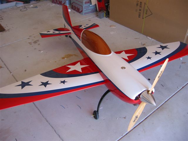

The best setups I have seen are the electric conversions..!!
The ailerons do get tight downward, I did not remove the overhang, but I have made a small slot to clear the aileron horn when going to full deflection.
Attach some pics.
There are some posts on here by Buzz Lightyear who used a OS140RX and is flying IMAC, he setup is really good.
Tony
