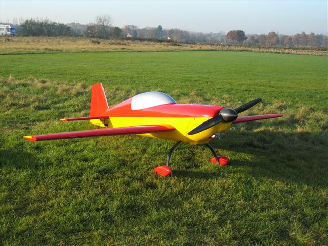

After much faffing about, many ‘diversions’, losing interest…losing flying sites…
I have finally completed this model…….!!!!!
And made the first flight yesterday......
For those who like details
Engine – ZDZ 50NG
Muffler – JMB ‘ Pitts Style’
Radio
5 x Hi-Tec 5945 Servo
1 x Futaba 3001 Servo
1 x Futaba 149 PCM RX
1 x SM services Engine Kill Switch www.smservicesuk.co.uk
1 x 6v – 2400mah Sanyo SC RX pack
1 x 4.8v – 1700mah Sanyo KR Ign pack
1 x 6v – 900mah unknown NiMH Smoke pump pack
3 x Futaba HD Switches
Smoke System – Pete Tindal www.petetindal.co.uk
Smoke Injector - O/D
Tank – 2 x 20oz Du-Bro
Prop – 23 x 8 Mejzlik Carbon
Spinner – Glass / Ali, Czechovakia origin
Fuel Dots – O/D
First flight was the usual mixture of nerves which turns into 'major grin mode' after a few minutes, despite all the 'cargo' of nicads/smoke system etc, which has made this 2x2 a heavier example, it does not fly 'heavy'.According to my scales, its just shy of 15lb 8oz, The ZDZ50 performed faultless, very serious 'grunt' will go vertical forever......
Good flying
Tony

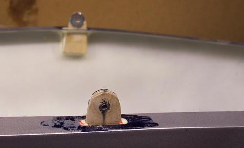

Has anybody had any problems with the canopy coming off in-flight. It happened to me today and I was wondering if you guys and any suggestions on how to fix that problem. Thanks
Old 01-27-2006 | 05:12 PM
  #163
devcon9's Avatar
Joined: Aug 2004
Posts: 74
From: Hanworth, CA, UNITED KINGDOM
Default RE: Extra 2X2
No canopy problems ( saw that coming with the ' instruction installation' I used the 'hook' at the front of the canopy, and used the same mounting method as the cowl, one either side, about half way along the canopy, the rear of canopy same princible, one hold down.
Can post some pics tomorrow.
Good flying
Tony
Old 01-27-2006 | 05:39 PM
  #164
Joined: Apr 2005
Posts: 15
From: Felton, DE
Thank you! I'm pretty sure I know what your talking about, but pics would be great.
Old 01-27-2006 | 06:03 PM
  #165
devcon9's Avatar
Joined: Aug 2004
Posts: 74
ORIGINAL: jlellis
Had to go to ' the hanger' to charge up...
Some pics -
Good flying
Tony

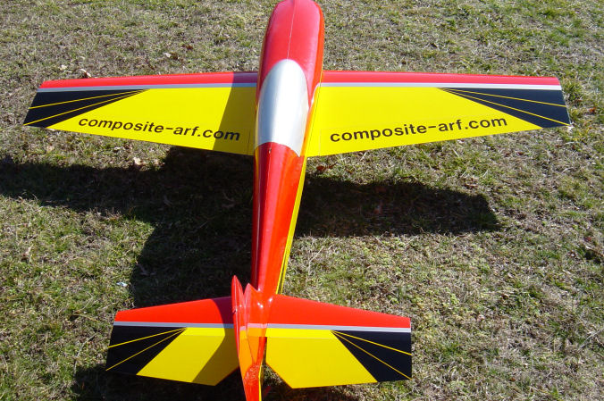

Hey Guys and girls... first post to this thread.... I am about half way through building mine and thought you all might like to see the scheme I am putting on it. It looks a lot like a Yak because this is my "back up plane" to my 2.6 meter yak =0) Let me know what ya think!
Scott
