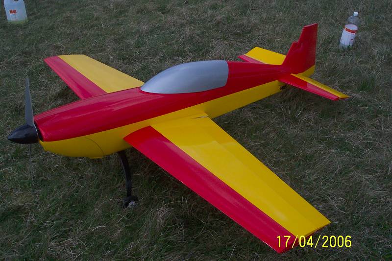

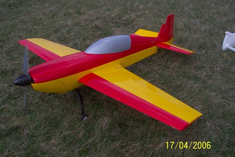

Finally got mine done. Hacker C50 15XL Evo20 5000mah lipos Acro 90 ESC 22x12 APC-E.
After a few CoG + thrust line + UC issues is now flying well. Makes me look far better than I am[8D]

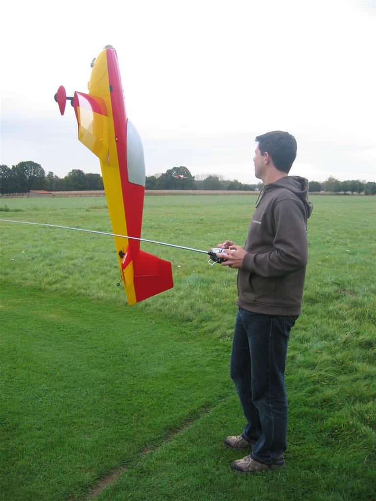

Just put a DA50 on it...it needs the weight in the nose. Or else you got to move the elevator servo's upfront like Buzz lightyear with the 140rx. The wingloading could be less, but it's not really a problem, you can still have a lot of fun with it!
Are any of the 2X2's in this thread still flying? Seems a bit quiet lately
Anyway, i had some fun with mine this weekend!!!
Greets Gaaaz

PLEASE TELL ME WHERE ARE YOUR CG, HOW MANY INCHES NEXT TO THE FUSELAGE.
150mm, that's about 5,9 inches, it's where red meets yellow on the wing.
You can check your CG by flying a 45° upline (crosswind, so that the wind has no effect on your upline) do a half roll (invert the plane).
your plane should now keep on flying the 45° upline or descent a little bit without elevator input.
If your plane goes up, the CG is too far backward, if the plane goes down, the CG is too far forward....

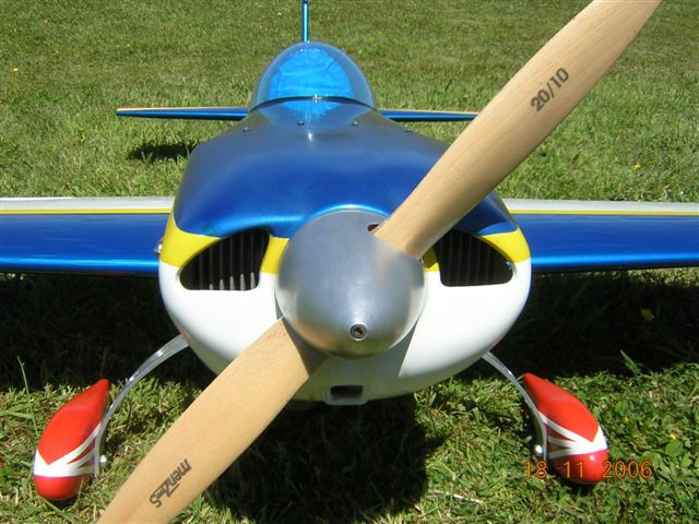

sorry, my english is very bad,,,,,
i'm sunday flyier to, but you can do the hover very good, thees weekend i move my cg 1inch rear and i can do hover ,,, BUT my problem was when i whant to land,,,, the plane stay about 4 feet and dont whant to land, i have to put elevato down and it get land.
when i put inverted the plane go on line, anything down, now im put only 1/2 inch rear the "tube or fenolico".
here some pictures of thees saturday
mine EXTRA 27%CAMODEL BRISSON 3,2
JORGE LEZANA MIDWEST 3W 48 BI
