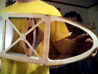

I built a tank mount in my Sukhoi and now my tank is over the CG. I did have to remove the canopy brace that was over the tank. No problems with that though. Of coarse there's not much wood left in my canopy hatch anyways
