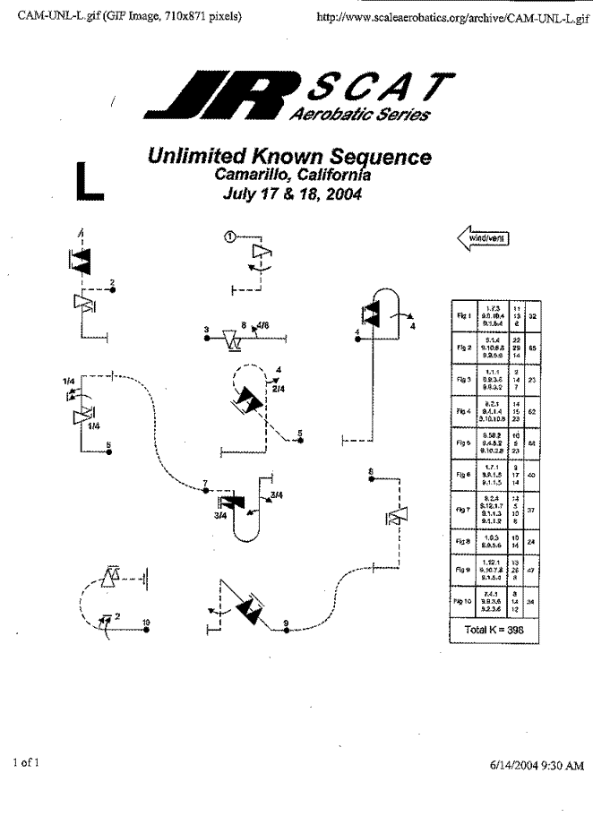

I mean both. First, sequence designers have simply gone snap happy to a fault. In the '06 Unlimited proposals, 2 of the 3 have multiple snaps on 9 of 10 figures. I am sure if they could have there would have been snaps on the rollers as well. The other only has multiple snaps on 8 of 10 figures. This is silly. It shows a lack of imagination on the part of the sequence writer and it places far too much emphasis on the snap roll. When you run the chance of zeroing nearly every figure in your sequence due to the all or nothing nature of a snap roll I think it is time to step back to assess if this is the right direction.
Secondly, the result of design like above is that pilots spend too much time focused on snaps. Judges too are spending all their time worried if they have made the right call and it places a significant burden on the judge to focus in on the snap and perhaps not be paying as much attention to other things.
So, why can't we roll back the snappiness of the sequences?? Beats me, but it seems like they are the new religon in sequence design so you better get them right.

Hi Wayne. Nice to see you were watching so closely back then!!!! However, I did not write that particular sequence and I did not particularly like it so it has no impact on my point. And even if it were written by me, perhaps I have learned something since then and have changed my attitude about snaps. Lots can happen in a year.
So I take it that you feel my comments are unjustified or incorrect? Since you took the time to dig out and post a sequence that was flown at a contest I happened to CD over a year ago, that is all I can surmise.
