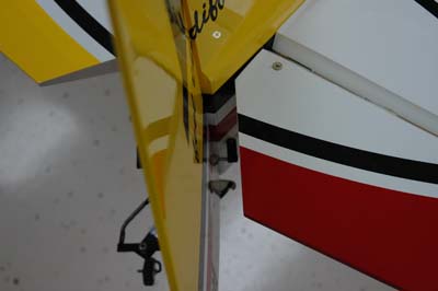

Here are the pics. Tiller arm is 41" from hinge line. Balances ok there, just a little nose heavy, balancing at the wing tube with no wings. I used the Dubro heavy duty connectors in the rudder. It helps get the connection at the hinge line. If you can see in the picture, the connector hits the fuse before max travel, still get a lot of travel though. Looking for any ideas to solve that problem. I believe my tiller arm is 4"

Edge, I believe you must be the guy SWB mentioned when I called as he said he had just sold one for a Panzl. I guess the only thing you could do would be to shorten the black arm but that will throw out your setup on the hinge line unless you re drill the hole closer to the hinge.
I just had this discussion with Scott at SWB the other day. He didn't really seem to beleive me when I said the control horn would hit the fuse side on the Panzl... he said that I had to use a 4" arm... a 4.5" arm wouldn't work because the distance from the tiller to the hinge line is too short. Well... I have a Radiowave Extra that has the same size fuse/rudder, and I used a 4.5" arm in it... it works just fine and the horn doesn't touch the fuse sides like it would with a 4" spread. Scott's a great guy and he's spot on with his stuff, but I think this plane is just a little different than others out there.

Nova spinner from airwild. Standard gear, however I will probably replace with carbon fiber. That in itself will probably put the balance dead nuts. The stock gear is very stout. 8611a's all the way around, kind of a pain because they don't fit in standard slots. SWB titanium turnbuckles and ball links. Hangar heavy duty links on the surfaces. 5" dubro lowbounce light weight wheels. I am also thinking on getting a 4.5" tiller. That should push the rudder linkage out far enogh not to hit. But, I will see how it flies it first. Might be worried about something I don't need to. Fromeco peerless batteries with badger switches. Nice, nice stuff.
