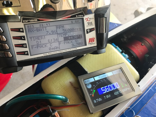

Got my Telemetry unit today. No instructions but they are not needed. I plugged in the 2 leads one to ecu one to my sensor port on my receiver and then added all the telemetry sensors to my screen and it worked. the Fuel consumption is on the f-pack capacity sensor. I'm sure it will have to be calibrated.

Old 05-17-2017 | 11:55 PM
Springbok Flyer's Avatar
Joined: Jun 2006
Posts: 1,480
Received 27 Likes on 25 Posts
From: Gold Coast, Queensland, AUSTRALIA
Has anyone worked out how to get 'Fuel remaining' on this yet?
Jan
Old 05-18-2017 | 02:21 AM
Joined: Jun 2004
Posts: 138
From: Houston, TX
Yes on JR it just uses the capacity function of the flight pack. Not sure how many ML equals mah I'm set at 4000 with 20% reserve from r my alarm to go off.
Old 05-18-2017 | 03:47 AM
Joined: Jun 2006
Posts: 1,480
So does the 4000 relate to the tank capacity?
