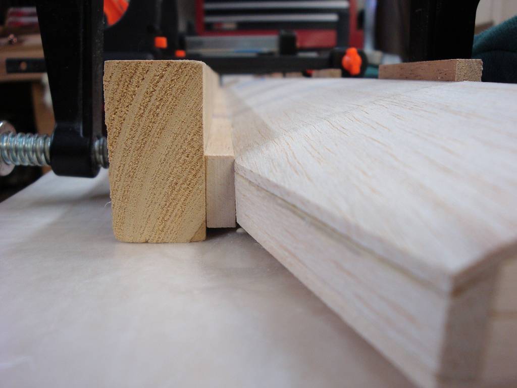

YES, a flat leading edge will make a difference in the way your plane will fly.
I posted a few pics of a wing being built. There is one pic where the leading edge has not been shaped. If left at this stage and not rounded over, when the air meets that square, flat leading edge surface the air passing over the wing would be quite turbulent and not provide the smoothest airflow over the top of the wing which provides the lower pressure on the top of the wing as compared to the bottom (generation of lift). In other words, leaving the leading edge square is preventing the airfoil to do it's job efficiently and effectively.
You did not mention at what stage you're at in building your wing that you are considering not rounding the leading edge. Pictures always help and clear up any conjectured cures and advice.
If the leading edge material of your wing is balsa, it won't take much time with a block plane (or sanding block, 80-grit if you don't have a plane) to bring the leading edge to a rough rounded shape. Use 120-grit sandpaper to bring it to final shape, and then 220-grit to smooth it out.

I don't see why there is so much discussion on this.
It's easy to sand the leading edge. Why not do it ? EJ's pics illustrate how to do it, so just do it.
Your model will perform much better, if you do.

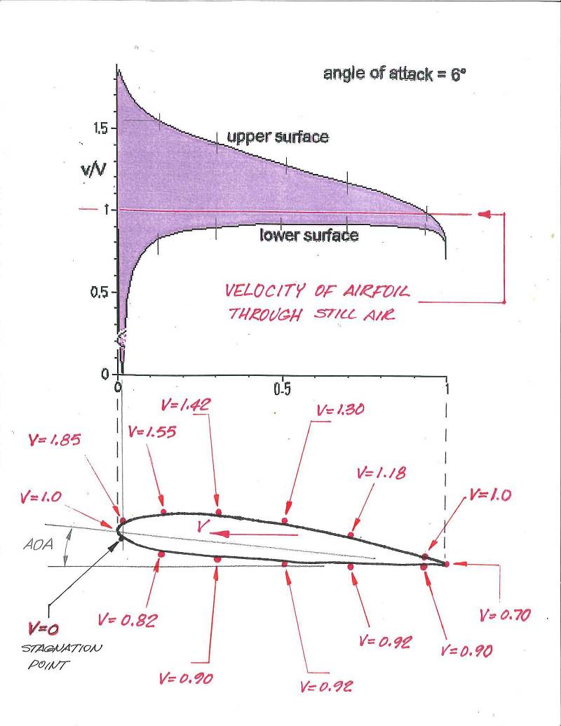

Quoting from the first post ___
<span style="color: #339966">Its flat on the bottom then 90 degrees up the front then about a 30 degree slant across the top.
</span>Unquote.
This shape is not far off from being close to a fully sanded and rounded cross section of a leading edge.
Perhaps few modelers realize that the air separation at the leading edge of a wing takes place NOT at the very leading edge but some distance ahead. Even a nicely sanded and rounded leading edge has a fair part of its curvature just about 90 degrees with the flight trajectory.
Looking at the airfoil countour at the leading edge the forward point of the chord is where the leading edge present a surface that is 90 degrees with the trajectory and that is pretty well true above and below that point for up to 45 degrees above and below that chord point.
It is a gradual change until the flight trajectory line become tangent to the top camber of the airfoil.
So it is not surprising that any effect of a leading edge as described in the first post of this thread is not really noticeable on its flight characteristics.
Anyone claiming a big difference or even any noticeable difference can keep on dreaming or spend a bit more time studying aerodynamics.

Round LE makes the transfer of air from the bottom surface to the top surface smoother.
Is in that critical area where the acceleration of the upper air flow happens from zero (at the stagnation or separation point below the LE) to maximum speed (area of lowest pressure) on the forward portion of the upper surface of the wing.
This is more pronounced as the AOA increases, reaching a max just before stall.
A foamy with flat wings has perfectly square LE and still flies.
However, proper streamlined airfoils are more efficient regarding lift/drag.
