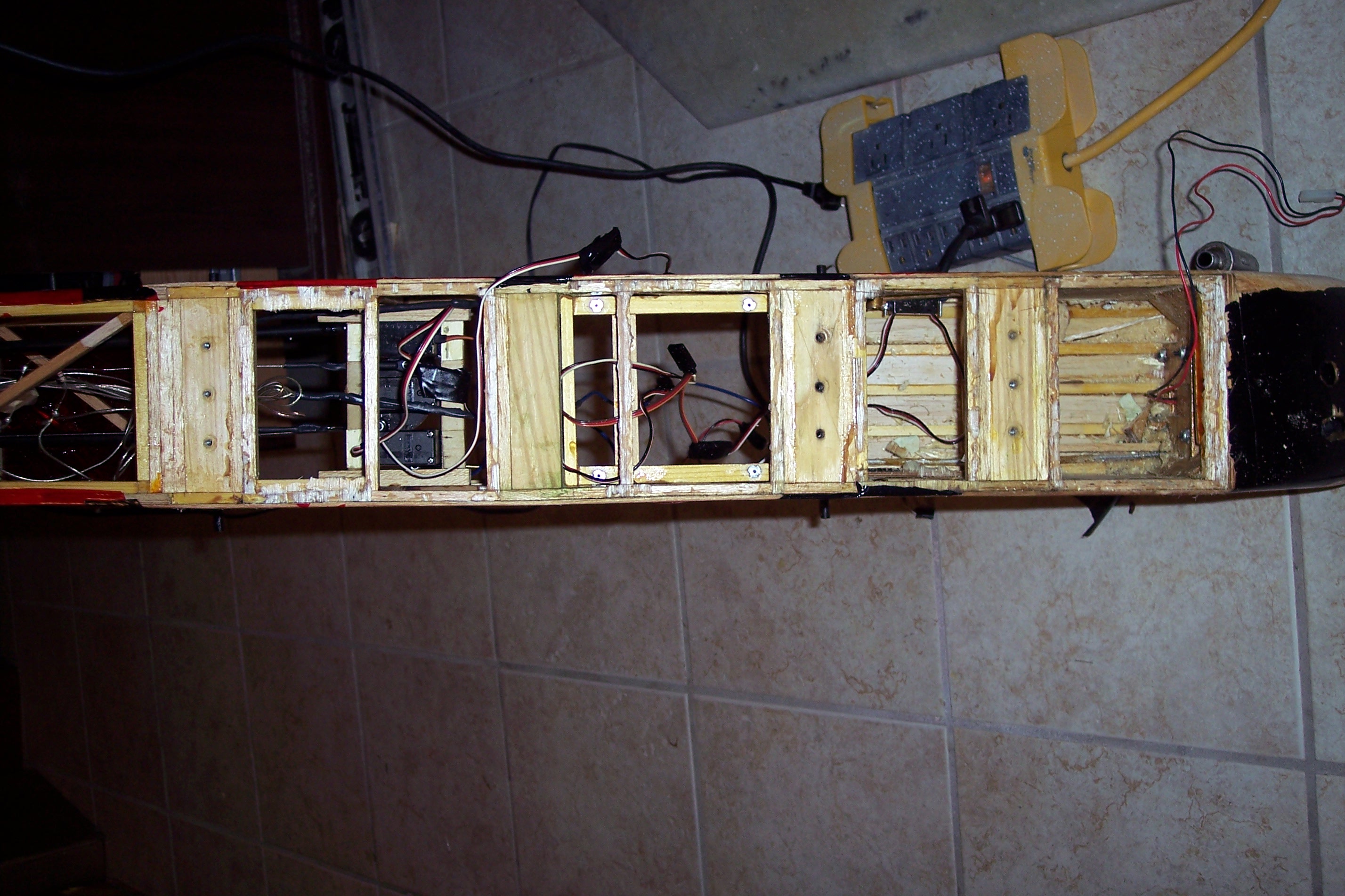

Hey gang, enjoying the building season? Question on fuel systems with a header.
I set my Sig Senior up with a header tank fuel system. A 40oz dubro main tank under the CG and a 4oz dubro header tank. I installed a third line into the main tank to fuel/defuel it. The header clunk line went to the Saito fuel "intake," the vent line on the header went to the clunk line on the main tank, the main tank vent went to the press. tap on the Saito's muffler. Does this setup sound correct?
I flew the airplane maybe half a dozen times and spent a long time tuning the Saito (I broke it in for about 45minutes using the manual instructions and the same fuel setup) . The tuning stuff I think was inexperience on my part. I got a tach and some help and we eventually got her sounding the way a good running Saito sounds. It is a sweet sounding engine. I wound up having a lot of trouble fueling and defueling it. The third line to the main tank never worked. I eventually got the fuel into it via the header clunk line. I couldn't ever defuel it more than a drible though and wound up using a bicyle pump to push the fuel out. This eventually forced the cap on the little header loose (I'm guessing) and it sprayed glow fuel all over the inside of my Senior. I've been spending more time than I want replacing/sanding out the soaked balsa.
My questions; Is this setup correct? Does a third linke to the maintank work on this setup? What is the proper way to fuel/defuel this setup? I'd love to set it up this way again. I think I can get 40minutes plus on this setup, probably more with that Saito tuned in right. Its a blast to fly and with the long flight times its super easy to get my stepson some sticktime. He tends to like his pz trojan though

Well, first off, it's not the best of setups.
Let's do a little "Tank 101" here. The reason you want to keep the tank close to the engine is so the engine doesn't have to draw fuel from a long distance. This is not so bad when you're plane is level, but when it's nose-up it's having to lift a long column of fuel up through the fuel line.
So in your case, the header tank is doing virtually nothing - You should even consider removing it.
You see, even though it is close to the engine, and the engine is drawing from it, IT is drawing from the main tank. So in esscense, the engine is drawing from the main tank. In other words, imagine having a long line directly from the engine to the main tank and then having a large bulge in that line just behind the engine. That is basically what your header tank is. (I'm working on a computer without Photoshop or I'd draw a picture).
What this boilds down to is: If your engine runs fine with the tank back at the CG, you might as well pitch the header tank as it is only complicating things.
As to your fill problem, check the lines inside the tank, sounds like something is plugged

Running a header tank is bad news and problematic. Yes, you can find such practices in some full scale devices, but you will invariably find a pumped and pressure regulated fuel delivery system that has been well engineered. Not a purely suction fed carburetor, like the types we use in modeldom.
I'll bet I can get an hour or more of flight time while flying a four-stroke .70 glow engine and using a 12 ounce fuel tank, simply by throttling back. A 40 ounce tank is way too large for a suction fed engine and the problems that such a large fuel tank will cause are not moderated with the use of a header tank.

If you were going to run an 8 oz. fuel tank, having the fuel feed line exiting the centerline of the fuel tank up to three or even four inches below the carb's spraybar would probably work just fine. However, as we both know, that is not the situation that you are in.
The problem I see is with the 40 oz. fuel tank as it burns off fuel, or as you climb and dive the model. As stated previously, in other articles, your engine is using suction feed with no regulation other than that provided by the SIZE, SHAPE and LOCATION of the fuel tank. Your little Saito .72, while a fine engine, lacks the sophisticated carburetor/fuel system that your ultra long duration flights require.

I wouldn't go over 12 ounces without going with a pressurized/regulated fuel system, such as a Cline or the other brand, which is safely tucked away in my brain, but which will not surface to the fore so that I can type it for all to see. Ah, I remember, the name is Iron Bay.
Some folks have even used a Walbro carb's fuel pump and regulator function to accomplish the same trick. With such a large, light weight model as the Kadet Senior, the small additional weight of the Walbro carb will be negligible, but you would be hard pressed to find a better pump and regulator. Some of the folks on this forum have mentioned the fact that they did hijack a Walbro carb in this manner for use with glow fuel. Anyone?
With the Walbro set up, your 40 oz. tank would work, but I would look into baffling the innards so that your model doesn't suddenly find itself very tail heavy when you raise the nose to climb. Good luck.
