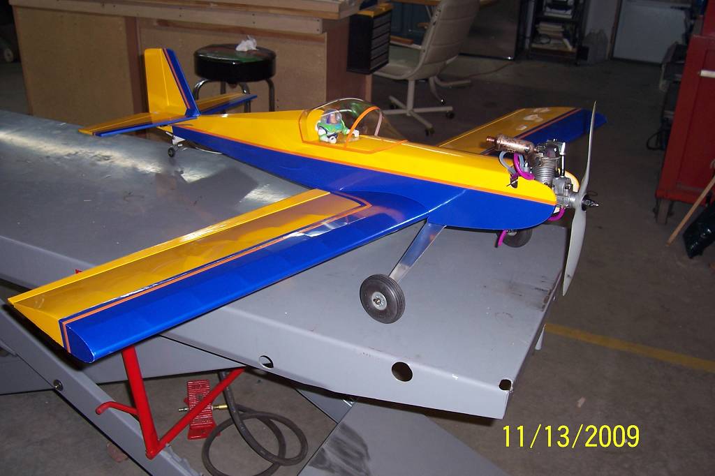

Gary here's a pic of my second 4* with a saito .56. It has 1 bay removed on each wing and the rudder enlarged 3/8 to a 1/2 on the taper. I also went with the stock single aileron servo to keep it lite.
The Saito 56 is perfect for my plane, plenty of power, sips fuel and sounds awesome without being loud. Have tried a lot of different props and for my style of flying , an APC 12x7 seems to work best.
I find it hard to build in the summer, just so much other fun stuff gets in the way. lol
