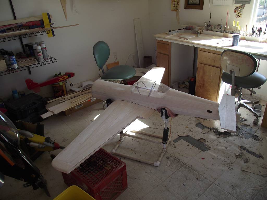

So far it's just a lazy build, not in any hurry. Did some sanding yesterday and I started to epoxy the tail feathers on. Just put the Hor Stab on a while ago. Sheeting the fuse was a kick. A bit of thick CA and a squirt bottle of water. Last one I built took 6 weeks, so far lazyass has spent 3 months so far. Other then the 2 ounce bottle of the thick CA nothing else has been spent on my kit. The wing took a lot longer then the fuse. with glassing and painting I figure I will be flying it before the summer is over.

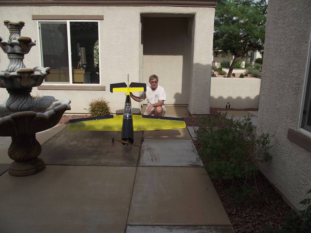

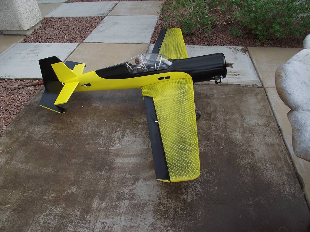

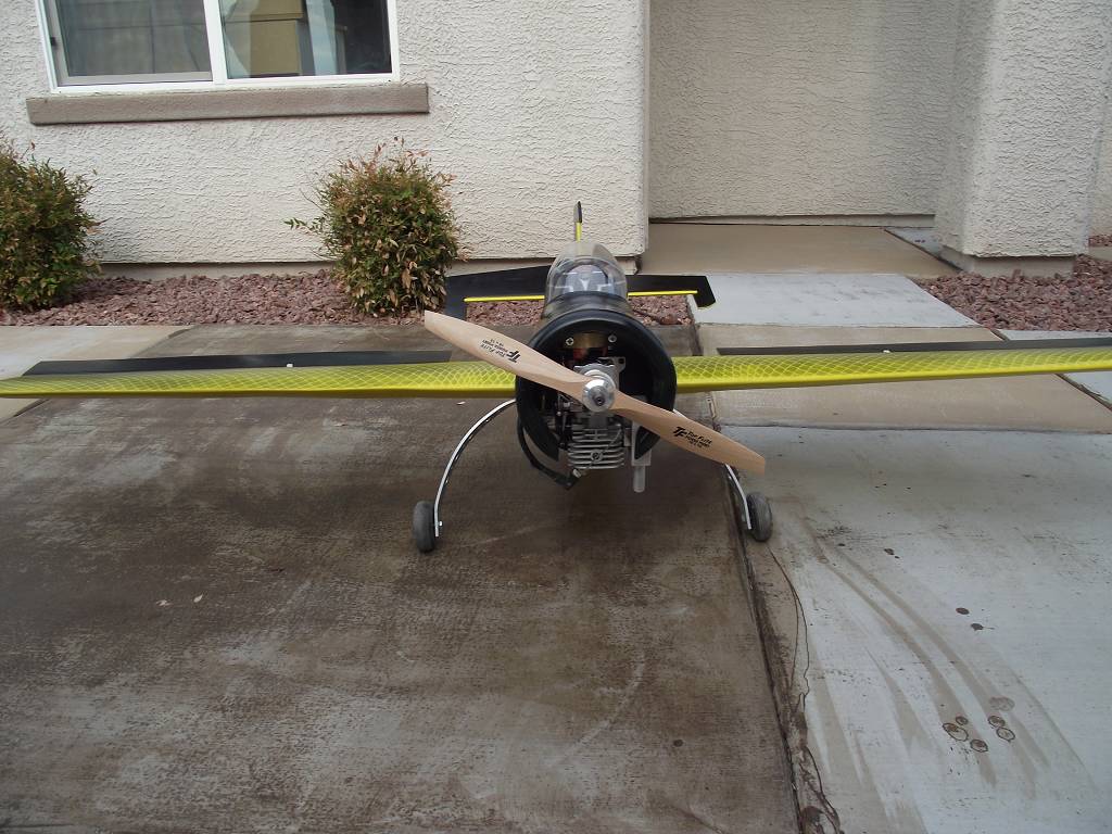

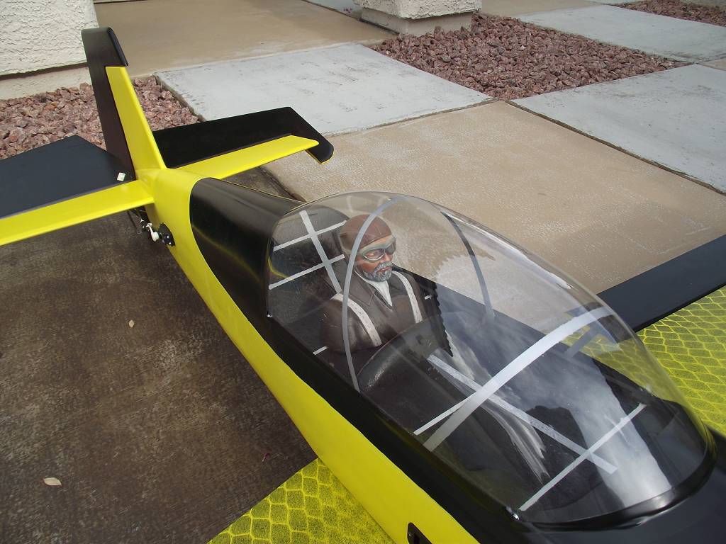

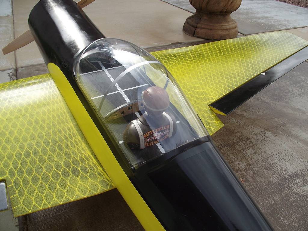

Finally finished except for the detail work, I need bigger tires, spinner and batteries. This was built in my spare time, I no longer spend 10 hours a day out in the shop. Last time I built this plane it took me about 6 weeks. Total cost for an 80 inch Sukhoi 29 1/4 scale, right about $200.00. It pays to build from plans!! Weight of the plane was 6 pounds, then it went to 7 after glassing then up to 8 with the paint. Plans are an open bay wing, I sheeted the complete plane. The plane was designed for a 1.20 four stroke glow engine. I did some design work on the plans and went with a Brison 2.4 40cc gasser. It can be built cheaper if you just build as drawn.
A kit today for a little 60 size plane is $200.00+ so buying plans and cutting your own kit makes a lot of sense.
WHERE HAVE ALL THE KITS GONE???? They are as close to you as any plans service.
Gene

This is the second Sukhoi 29 mini me has piloted He has also flown a 35% extra. I don't throw anything away, it can be used in another plane sooner or later like this canopy and landing gear. I guess I could have gone to the toy store and gotten a nice dolly to use as a pilot.

Thanks, it took weeks to mask off!!! I went to the Halloween Store and bought a cheap pair of fish net stockings, put them over the wing then did a light shoot of black over the wing. Still can't talk the wife into wearing them though.
Because the engine is gas I was able to use cheap Latex paint bought at any hardware store. I still have to stripe the bottom but I haven't decided to use a small roller or feather it ion with an air brush. I'm thinking of a silver pin stripe between the yellow and black then rivets too. I have time until I get the money for the batteries and other minor things. All it takes is time and money!!
