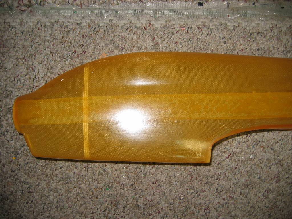

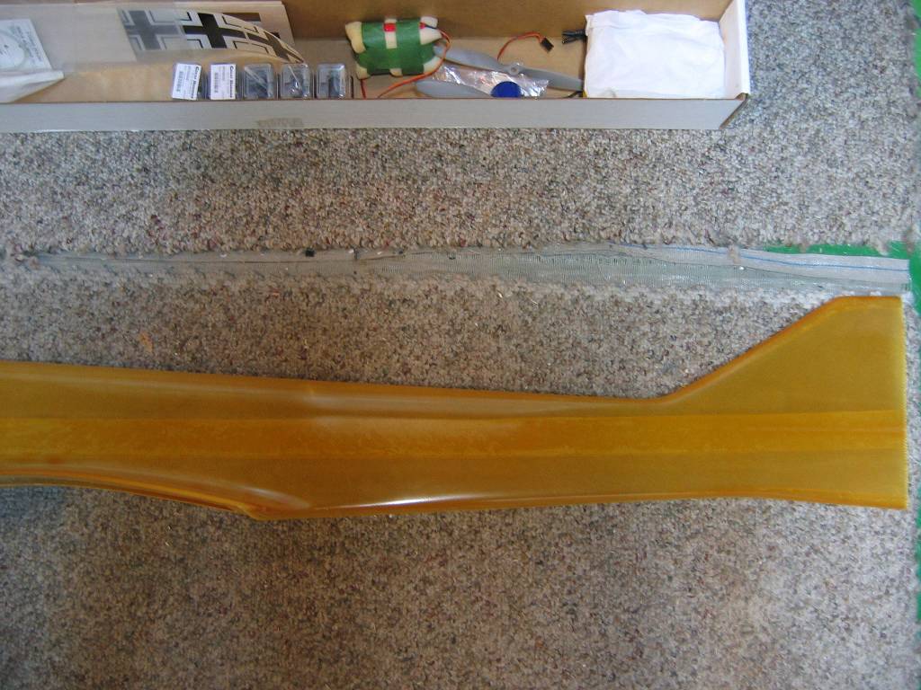

That original left wing discentegrated when I tried to use polyester resin installing the spars. The resin absolutely melted the foam and I could find no recovery for that. I plan on getting near the final shape on the fuselage from the canopy back today and installing the motor mount if all goes well.
I will aply some model magic on the areas where the surfaces are low on the stab panels and final sand in the anhedral angle. If all goes well I might even get the back up material in the engine housing so it can be rough shaped .

Where did you find a glass fuselage for a .60 Tipo? I searched all over for one.
I have finally mounted the motor mount and as you said it will take some more internal balsa backing to shape it to its final form.
At the moment the fuse weigh 1 # 4 7/8 ounces with motor mount. Lots more to be removed from the fuselage yet.
I have created the horizontal stab tips but have not attached them. Still fighting that fuselage shape. Just a lot of stock to come off yet. Does the tuck line create the lower contour for the upper fuselage blending into the canopy? I cannot get a clear understanding of that line. Maybe a head on photo might clear my head. Us engineers (mechanical) can read drawings but there is nothing there to read. I hate assuming.

Actually they may become available in the near future once again. Not from the original source of course. We'll see.

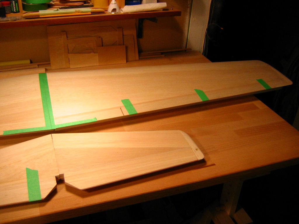

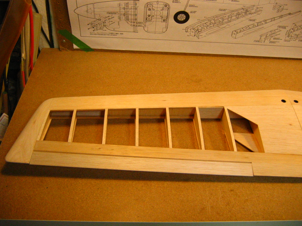

I managed to get some shaping and sanding done this morning before mowing the lawn.
The horizontal tips are rough shaped and need some fine sanding. The elevators are close to being finished. Maybe I can get this task done tomorrow along with some more sanding.
The replacement wing is still in Arkansas because of the terrible rain storms going on there.
I might set up the main landing gears tomorrow and set them aside for later. Still in a quandry about the nose gear since it is a rail mount, I will just have to think on it some more.
This build has been a challange but with help of folks like David (Doxilla) it has not been as difficult as it could have been.

Nice work Jim.
Your fuse is starting to really take shape now. In the process of building the little Pico (where not much material is available to work with given the size) I learned that the production of those smooth transitions in the tuck lines can be more easily created with the aid of a flat "S" shaped sanding tool. For the tuck line the convex part of the S is used while for the edges of the tuck line where the tuck transitions back to the fuse side, the concave part of the S is used. A 6" length tool strikes me as being long enough provided you use reference lines drawn on to the fuse. I have considered building a large 120 size 6' span Tipo (for which I have cut cores) and would build such a tool for that purpose. At the moment though that model might be 2 or 3 years away.
You have an unusual and interesting building style as you work in reverse order to the way I would go about things. I always learn things by thinking outside my "box" and your thread is providing such a perspective.
Keep up the good work!
David.
