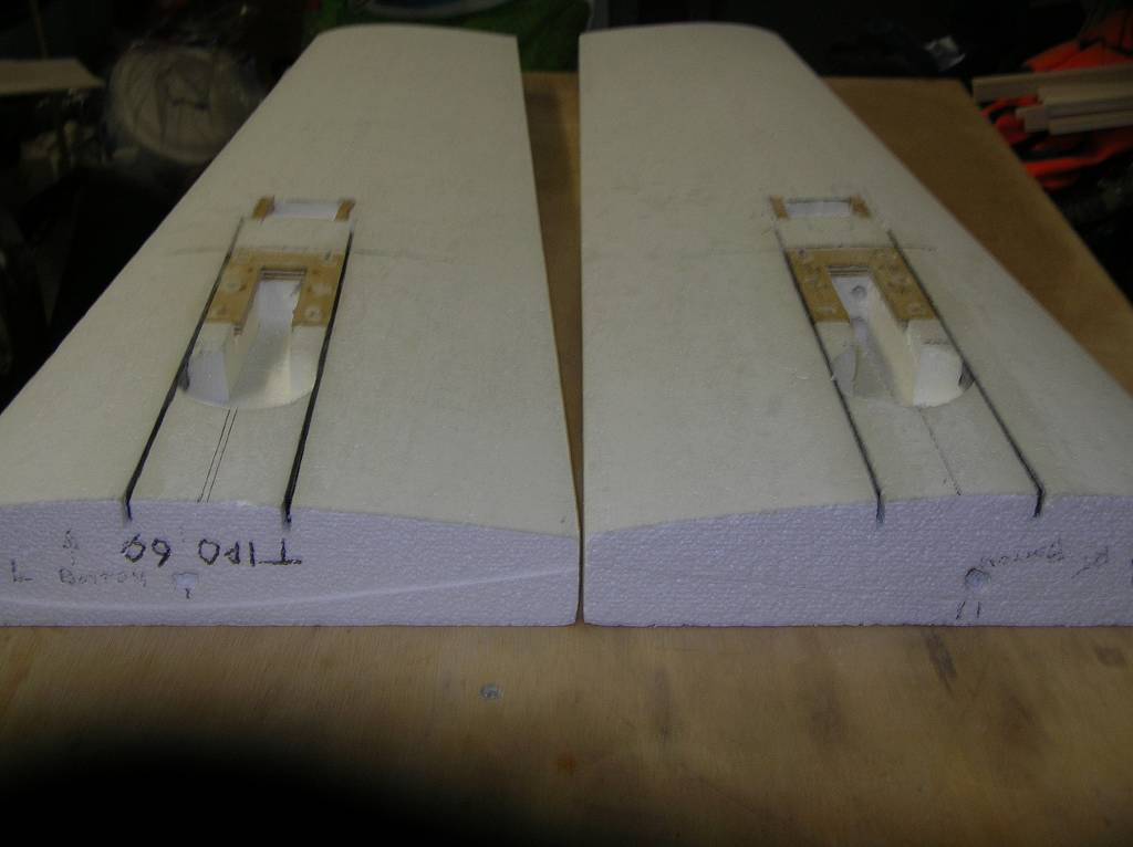

Between yesterday and today I managed to get the wheel wells and retract mounts opened up and sanded flush. I have one wing ready to install the carbon fiber spars but when I cut the spars I had a mind lapse and only cut two and as we all know four are required. I will try to cut two more tomorrow.
Does someone have a picture of how robart wire main struts are installed? Can I rotate the strut so that the coil of the spring just clears the air cylinder? Its just been too long to remember.
I will make a template so that after the wing is sheeted I will know where the wheel wells and servo mounts are to make it easier to locate. That is for later.
I would have never thought of using sandpaper to smooth out the retract area without comments from David. Thanks.

Spars are epoxied in place as is the retract blocks. Also installed a servo rail in each wing.
I started joining the planking for the wings and found that each piece of sheeting needed to be trimmed to be straight. While cutting those straight I had a thought from the past. I remembered that we used to put dowels (1/4 inch dia.) through the retract mount and into the foam for additional support for the gears. Good thing I remembered, so I accomplished that task today also.
All four wing skins are joined and sanded and it looks like the lamination might be next.
I answered my own question about the location of the axle for the retract. I have that resolved.
Wound up ordering an extensoin for the Macs pipe so the the round part of the header clears the fuselage in the front. This tells me that the nose width is too wide but its going to stay like that.
Pictures attached of the wing assembly prior to planking.
