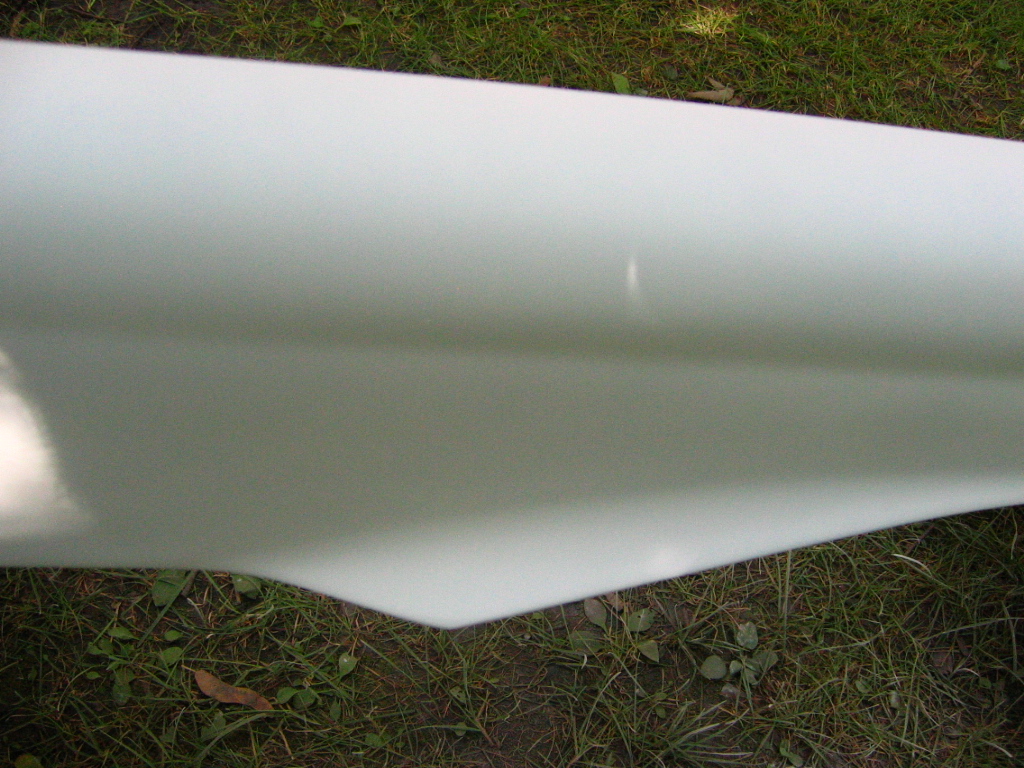

got your email and thought I would reply here. The closing off of the nose gear retract bay is not mandatory - some people like to do it others don't. If you don't need access to the nose gear from the inside, you can close it off and do any maintenance from the bottom. Some like to make a rectangular cutout for the NG which makes maintenance easier others prefer the tailored cut look with either a hatch or simply insertion or removal from the wing LE bulkhead.
Using Hobbico wood filler is a nice way to fill the glass grain but you don't really want to be priming directly onto this stuff - the substrate in my opinion would be better if it is "filled glass". You want it to be hard - if you paint on to a certain "thickness" of the soft wood filler, it will crack and cave in eventually. The filling does take some brushing, drying and then sanding until the grain of the glass looks uniform. I wouldn't recommend filling and priming the wing in stages - fill it all first and then when its smooth, filled and hard, prime it. You're basically priming filled glass which should be hard.
BTW, the same goes for the primer. Prime it thicker after a couple of "mist" coats so the primer aids in producing a smooth, and mostly, uniform surface. You will want to fill the primed surface with automotive type filler (e.g., Bondo) in the low spots prior to sanding it out. You pretty much want to sand away all of the high build primer and filler at first in the aim of producing as smooth and uniform a surface as possible. Once you are satisfied you can then proceed to a final uniform primed surface allowing the paint to adhere. All of this also depends largely on what type of paint you are using but, in general, that's the typical approach.
If you can, take more pictures, it's easier to follow and enjoy your thread with them!

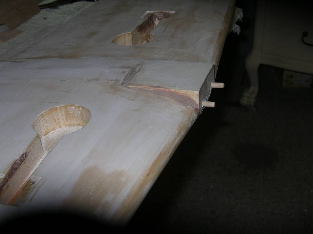

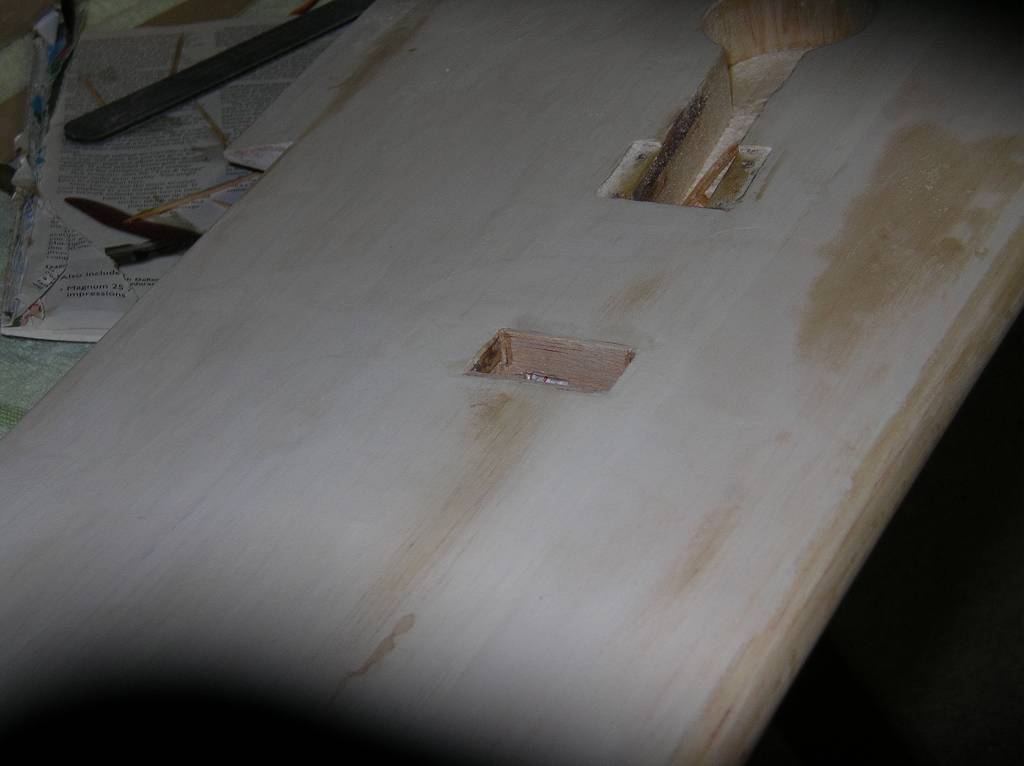

Attached are pictures of the lower part of the wing. I have sanded it down as can be seen. My next step was to prime but after reading Doxilla's statement I am not too sure about that.
Should I coat those surfaces with either epoxy or polyester resin???
On hold awaiting some comments.
Jim

Jim,
as long as you have a filled glassed surface, you should be in shape to prime. I was just commenting on the fact that you don't want to be priming on a substrate of filler on top of your glass work. If it seems too soft to you, you can always brush on a thin layer of resin (polyester, polycrylic, epoxy or whatever else it is you used to glass your wing) and then sand that down. Just keep it light, otherwise the model will wind up weighing in excess of 9 lbs.
David.

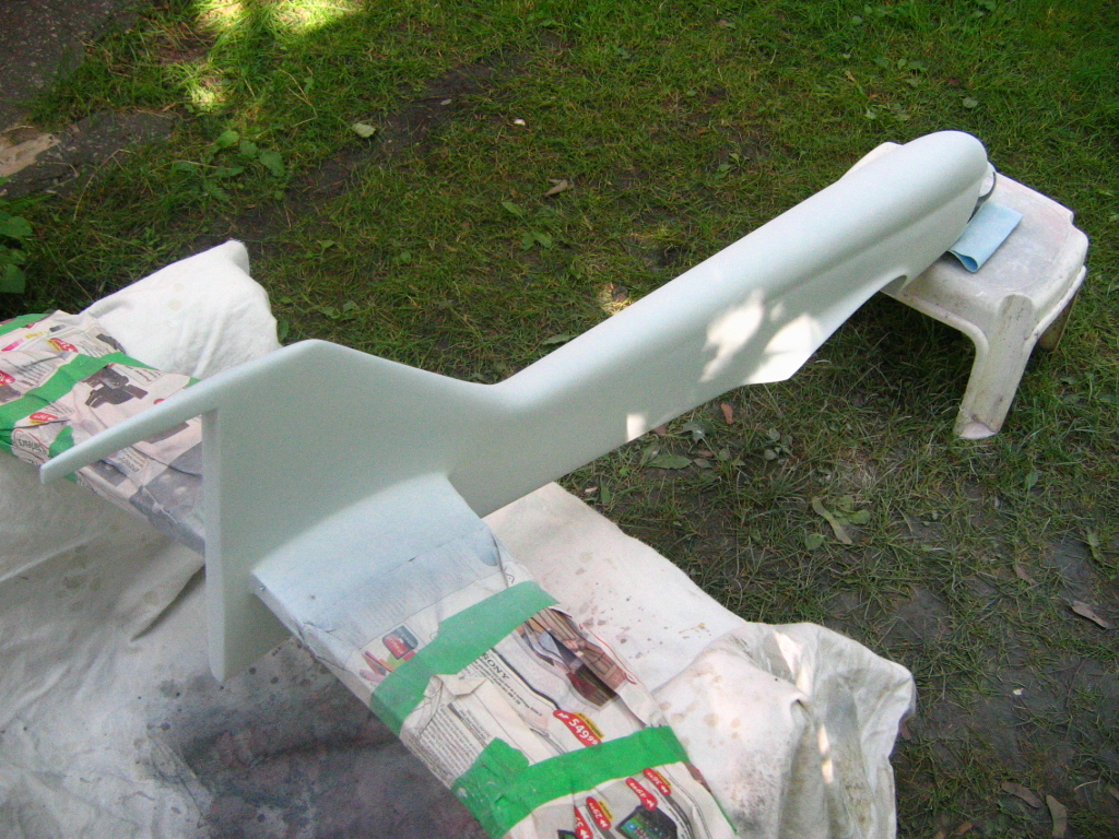

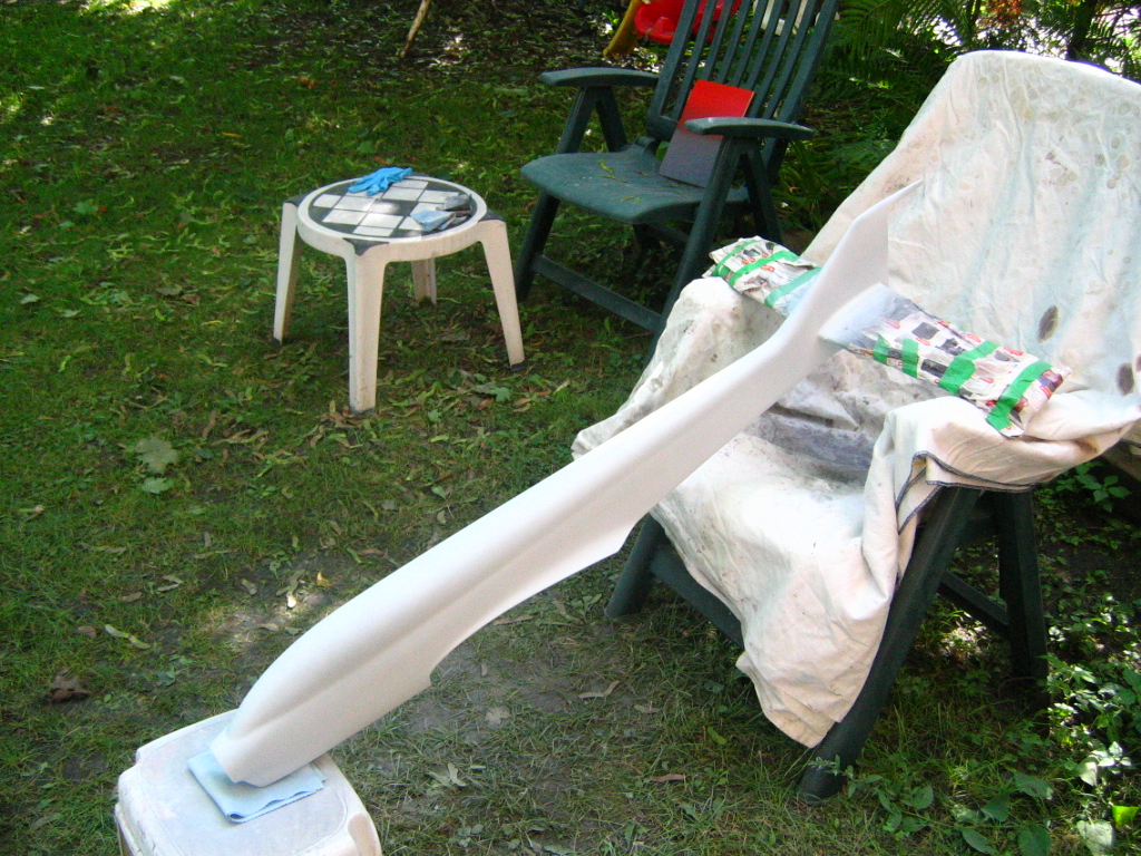

I have been creating the fillet radii on the tail feathers and sanding and sanding the wings and fuselage. It seems like I have a long way to go on the sanding of the fillet radii on the tail feathers. I will post some pictures when I get completed.
I did pick up some primer yesterday but I still think that that is at least a week away.

while you are working on fillets, I found that making a fillet on either side of the wing chin block makes for a nice fairing into the wing. In order to facilitate the finishing of the wells, I also brushed on a couple of coats of finishing resin. Being balsa, you'll also want to fill those and sand them down. I used 1/64" ply to line them which makes for a slightly easier finish since it doesn't have to be filled.
A couple of other thoughts:
The ventral fin and bottom of the fuse in the glass version (which was made from a wood plug) is considerably rounder than the picture below. The bottom of the rudder is also sanded to that contour so it seems one continuous line. I think your model will look nicer and will take primer and paint better with more pronounced compound curves. You are still in time to sand the bottom round - you'll have to sand through the glass work but the small area shouldn't take too long to re-glass and fill.
I see that you used the cool Robart hinges. You'll want the centerline of the control surface (base of the V-form) to touch the model at the hinge line. A larger groove into the control to accept the hinge point until the hinge line is snug takes care of things. Air passing through those hinge lines won't be a good thing.
Last little detail that you might want to do is to add some 1/16" sheet around the servo wells down to the hardwood blocks on which the servos mount. Pretty straight forward and makes for a nice finish. Your wells are likely wider than the servos so the smooth wood will look nice compared to the beady foam.
Man,... that guy David, what a pain in the... Gets me to do all that unnecessary work!
I'm looking forward to seeing the primer! I was hoping to prime my wing center section today but humidity is up there - tropical thunderstorms all day yesterday. It's like being in the Caribbean up here in the summer these days!
David.

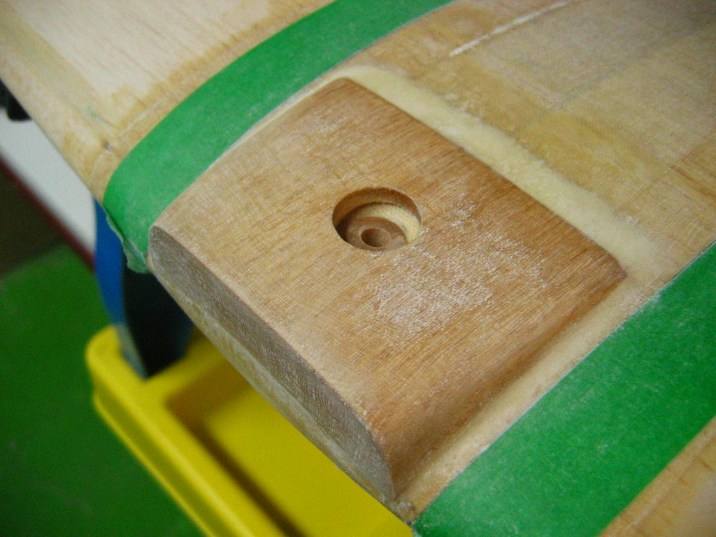

I have been able to do a little this week.
The radii at the lower part of the wing chin block has been added and almost sanded to final form. The servo pockets have been lined with balsa and sanded flush with the airfoil.
The radii at the tail feathers is rough sanded in and some places need more material. I have added some pictures to show where I am in the process.

I probably mentioned it above but I've been using a very cool automotive Dupli-Color polyester resin based primer. It flows on like butter and wet sands like a dream - leaves behind a light paste residue which can easily wash off. Then again, if you have a compressor you have the luxury of all kinds of paint.
Below are some shots of where I'm at with the fuse - for inspiration. Tomorrow I will sand lightly to 400 grit (and remove the little fly caught in my primer... [:@]) and then it will epoxy white time! The wing center section is done - rest will be MK. Killed a little grass in my back yard. [:-]

Thought you might also like to see where I started with the wing center section. Although it felt smooth and continuous to the touch, it required plenty of prep work prior to the final coat of primer. It now looks like a single continuous smooth area so I'm a happy camper. White is done. Flash for 48 hrs. I'll post some pics once I've got the red on the underside.
Last pic is LK Missile Red test - no where close to MK. It's more orange than red. Will have to substitute for better match.
David.
