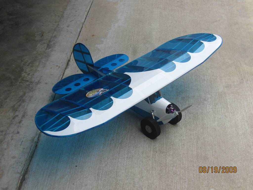

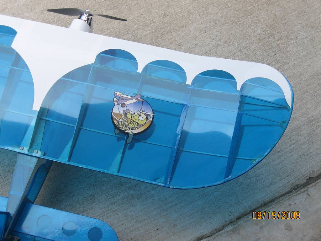

What are all you Bee guys up to ? Haven't heard much for awhile. Finished my 48" Bee and it's been flying real well.

What motor and battery are you using?
Did it balance ok? How about flight times?

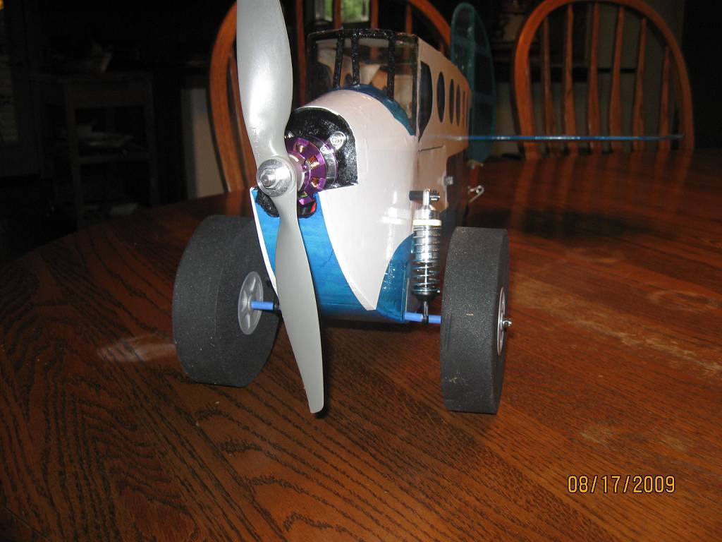

This is what I'm using, got all of it from Headsuprc.com. Bee came in at 32oz auw, balanced right on using 11.1v 2250 Getting 25 minute flights with battery to spare.
Setup for the Lazy Bee:
3530-10 motor
32A ESC
TP 10x5E prop
11.1v 2250 20C Lipo Battery

What prop? Any problem with it hitting? Really like the shocks, were did the you get the shocks?

No problem hitting the ground with the prop.
SHOCKS TOWER HOBBIES PART # LXWZ75
WHEELS TOWER HOBBIES PART # LXB914 (4 1/2 " LITE WHEEL)
PROP TOWER HOBBIES PART # LXZK95 (10X5 THIN ELEC PROP)
