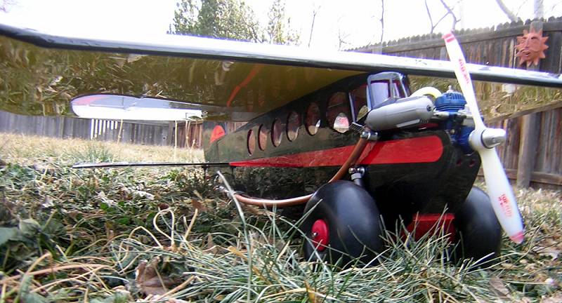

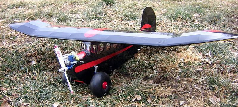

ORIGINAL: RCBOATMANIAC
I figure that if I can get the rudder made the rest of the plane will be a snap.
I thought the laminating was the easy part once the forms were cut. This plane looks small and simple, but took almost as long as any larger plane to build. The hard part was getting my fat fingers in there to hook up the servos, and I made a few modifications to the front cuz I thought even the little .15 was big. And all those frickin windows. I haven't flown it yet as it's been windy every time I go to the field. I had been wanting a LB since I got in the hobby about 7 years ago, but I waited too long and had to buy a kit off ebay for too much. I can't wait to fly this thing.

RS, looks real nice ! What did you use to attach your wheel shock to the fuse ?

The instructions actually had directions. Put a 1/16" or so wire all the way through, then a washer, a wheel collar, the shock, and another wheel collar. the axel is similar, but dont let the inner wheel collars pinch the fuse, so it can ride up and down.
Look at post 214 in this thread for the directions.

How is your exhaust pipe working? Losing any RPM?

I don't think I am losing any RPM's from the exhaust extention. It's inside diameter is twice the muffler outlet. One thing I did that seemed to make a big difference is I drilled four 1/16th " holes on the perimeter of the center baffle section which has one little hole in the center. It almost doubles the flow and also allows the unburned oil to run out the exhaust. With an 8-4 wood prop I'm getting 14,700 rpm static which seem real good. I'll be looking for aluminum to replace the copper as it's about 3oz. extra, and I'm at 2.75 lbs. now. With fuel I'll be at 3 lbs. which seems high for a .15 engine. The Trexler wheels are 3 oz. also, so may look into something lighter there too.[X(]

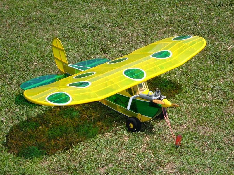

I have a .10 in mine with the muffler extension. It helps a little, just a little. My Bee is about twelve years old now. I gone through two sets of Trexlers over the years, and got tired of trying to keep them inflated, especially the tail wheel. I got some Dave Brown 4" wheels put them in my drill press and spun them to take the edges off to make them round like the Trexlers. I put the Trexler hub in and now I have fake Trexlers that I don't have to inflate.

Your Bees always make me smile Bolar. I love that Bee and looks light as heck!!!! I like your Trexler conversion idea.
Soo good hearing from you.
PS.....I too used to do the extension tubing for my Bees. It seemed to work a little better for a 4 stroke. Two strokes I tried it with....the rpmss were low....the motors were hard to tune and heated up fast as trying to lean it out becuase it runs so rich witht he pipe. Just my thoughts.......

Thanks. I've never had any problems with the simple (small) muffler extensions. If I remember correctly, Clancy back in the day, rigged up something like what Flight Risk has set up. It sure looks like it would keep the Bees cleaner. Usually though, there is some sort of trade-off with something like that (loss of RPM, over heating...). Maybe when it get nice I'm going to have to do some experimenting.

Thats it.....the lang pipe going to the tail. I tried so many times to get that to work on my Bees. Eventually.....this is what pushed me into electric conversion....

The copper tubing I used is 3/8 OD about 5/16" ID, which I just happend to have on hand. It cinches up real nice with the little hose clamp.
I like the idea Bolar has with trimming down Dave Brown tires, as Trexlers can be a bit of a pain.

I went over the top a bit, with the wheels. I really like the look of the Trexlers and think the compliment the look of the Bees. So what I did was glue two 4" wheels together and spun the corners off. The Dave Brown wheels are a little narrow, with the two glued together they get fat like the Trexler wheels. Anyhow, I flew with them last summer for the first time, and it's turned out to be one of the best "Mods" I've done for my Lazy Bee so far.
