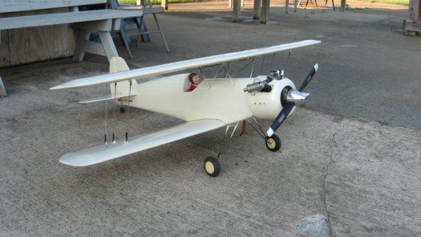

One question though, for folks who have flown or built this plane: It seems like most builds I have seen (two, Ithink...)use the longer double swept back wing configuration. Iwas thinking of building it with the short bottom wing because Ilike the styling. Any opinion on performance or flying characteristics using the different configs?
What about double aerilons with tie rods vs. just putting them in the bottom wing? I was thinkingthis could make a difference if a person flies around inverted some.

sweet. I have plans for this and was debating on building this one or the goldberg ultimate. Will be watching for top wing mod as that looked kinda weak to me also. Phil

I have flown an Aeromaster with both wings short, swept and four ailerons with two servos in the bottom wing. The plane I flew also has a Saito 100 in it. I really loved the way the plane flew. It was very acrobatic which you would expect with four ailerons and the Saito was a perfect match for it. Also, the man who built the one I flew made a slightly oversized cowl out of laminated balsa to help conceal the motor. He said it was quite a bit of extra work, but it turned out looking fantastic !
Good luck with your plane. You're doing a great job so far......

Covering the entire engine sounds nice, but the cowl would need to be on the order of an inch wider, maybe a bit more. It is already huge! Fortunately, it is easily detachable and if I don't like the way it looks I can easily build another one later. I am going to use liquid sheeting to cover it. First time to try that stuff.
I will follow up with wing progress soon. I have to figure out how to build both wings with aerilons as I have mostly decided to go that direction. Two servos, 4 aerilons.

My dad built the old lou andrews aeromaster and we just put a saito 100 it as well. He built it with 4 ailerons on the top and bottom and fully sheeted the wings. It was sort of on the heavy side but still flew well with a saito 100. Anyway the pictures show the cowl he made by using an old pot for a mold to lay fiberglass in. He then took it out and cut openings for the motor to stick out.

I built the same kit, but made both wings short with four ailerons. YS 91 for power. My wife called it my "happy" plane. She said when I flew that one it made the prettiest flights.
I went from the bent wire gear to the bent aluminum gear, worked much better.

I really liked that old Lou Andrews Airomaster, built 7 of them trying out the different combinations of wing sweep. I did find that all of the flew best with the upper wing at about 1.5 degrees less angle of attack than the lower wing was. Just a slight variation made quite a difference in how well they flew. They all also liked about 2 to 3 degrees right thrust and 3 to 5 degrees downthrust.
