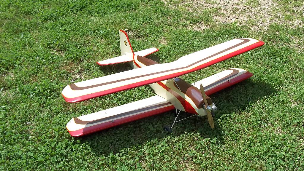

here is the gp aeromaster i did in the late 90's Mine had the straight short lower wing and the long swept upper with ailerons on only the bottom. The best flying airplane i've had yet. Supertigre .60 for power. When i do it again i'll be putting ailerons on both wings as the only complaint i had is i thiught rool response was slow.Watching you rbuild with interest. Phil

Default RE: GP Aeromaster Kit Build
Santini Air!!!
(Airwolf)
Dominic Santini would be proud to fly that baby!
