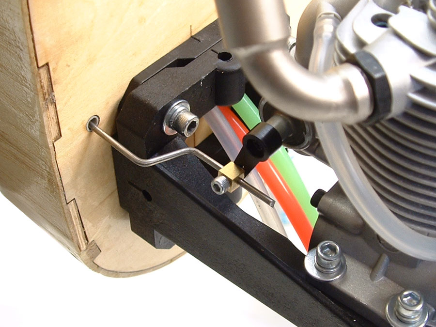

<span style="font-size: medium"><span style="font-family: Comic Sans MS">I have an extra 300s 60 size kit and i have installed the engine in the right position but the fuel tank is stopping me from running the throttle rod to my servo insinde the body.
pls i need help

What you may have to do is run the throttle linkage against the fuselage side & angle the linkage across after the firewall.
99% of model engines don't have a spring return on the throttle. The cable Huck mentions has an inner cable & an outer sleeve & is quite stiff & will pull as well as push. I find cables, either wire type or plastic type (known as snakes or Gold N Rods), the easiest for throttle linkages. - John.

Could i turn the carbi around the other way so the throttle is on the other side of the engine and just missing the fuel tank.

Can you bend the rod?

mallyOO Yes you can turn the carb around, note that fast/slow direction will reverse
