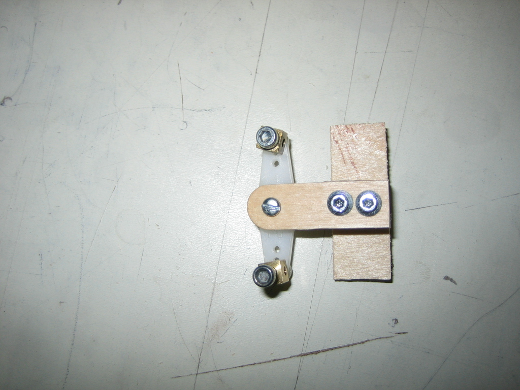

A lot of you have rotated the engine 90 degrees on you Somethin' Extras. For an OS 2-stroke that means moving the throttle cable to the lower left corner of the firewall when viewed from the front. The control needs to be routed under the tank tray, then up and over the fenolic (spelling) tube that acts as a bearing for the wing tube and back to the servo tray location for the throttle servo.
So, what kind of creative trickery did you use to make for a smooth, untensioned throttle control?
Thanks!

Ifutzed around with some popsicle stick ends, 1/8" tubing, an old servo arm, epoxy and some scrap wood ...
The ply cross arm can be CA'd to fuse just behind the former and then the rest can be screwed to the ply. This will provide a straight control arm shot under the tank tray to the firewall as well as a nearly straight shot back to the SIG-provided throttle servo location over the wing tube bushing tube.
Or, I can use a HS-85BBservo mounted upside down just behind the former, over the landing gear mounting plate and call it good ...
So many options ...
