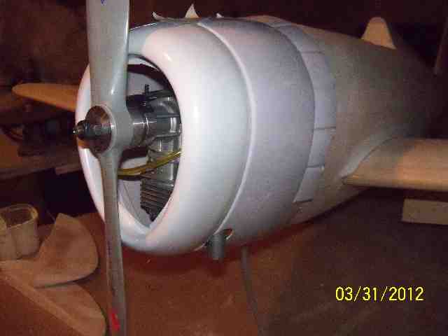

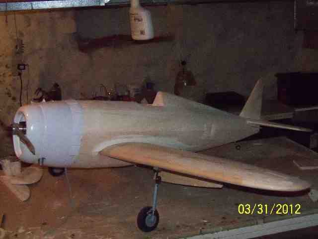

Default RE: Another TF P-47 Build

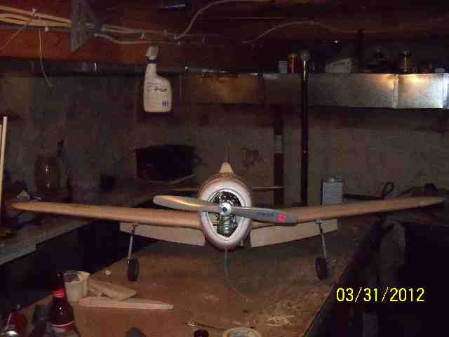

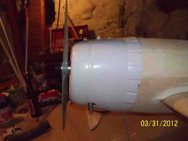

got alot done on mine have it all built now on to the finnishing sanding and more sanding filling and more sanding

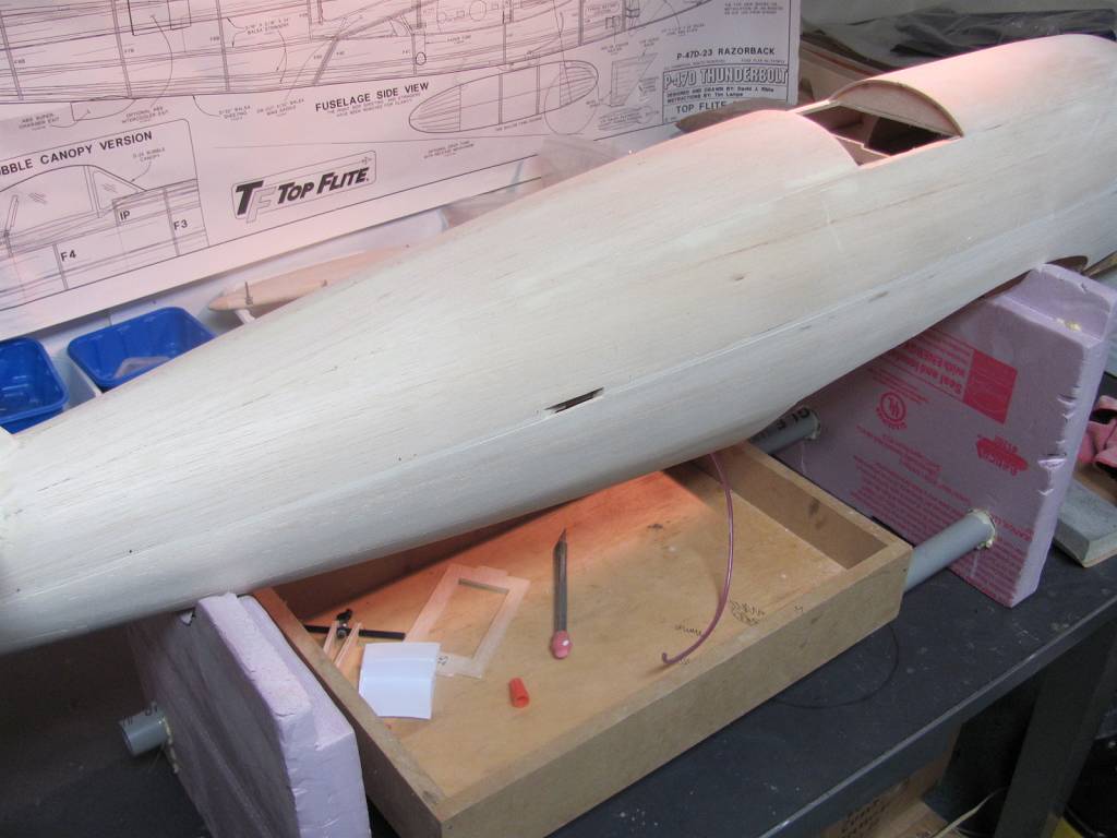

any one have any problems with the alerons binding with the flaos
Old 05-14-2012 | 11:09 AM
  #81
My Feedback: (60)
Posts: 7,688
Received 29 Likes on 27 Posts
From: Litchfield Park, AZ
ORIGINAL: charlesp
This is a common issue on Jugs when the aileron and flap hinging is simplified such as it is on most P-47 kits. The only solution is a larger than usual gap between the two surfaces.

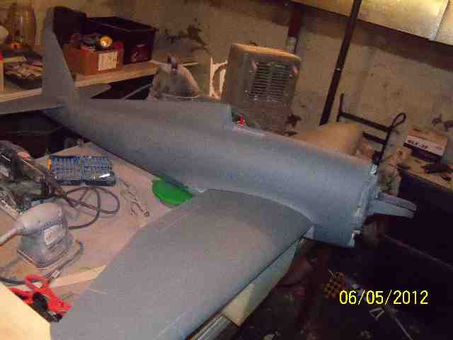

almost ready for paint glassing was better then I thought it would be but the sanding took forever lol

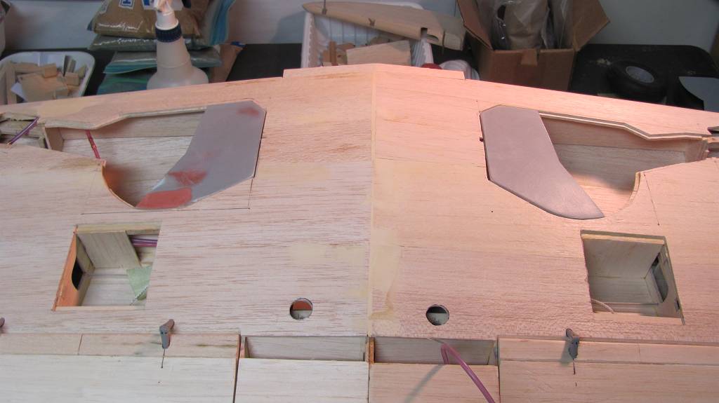

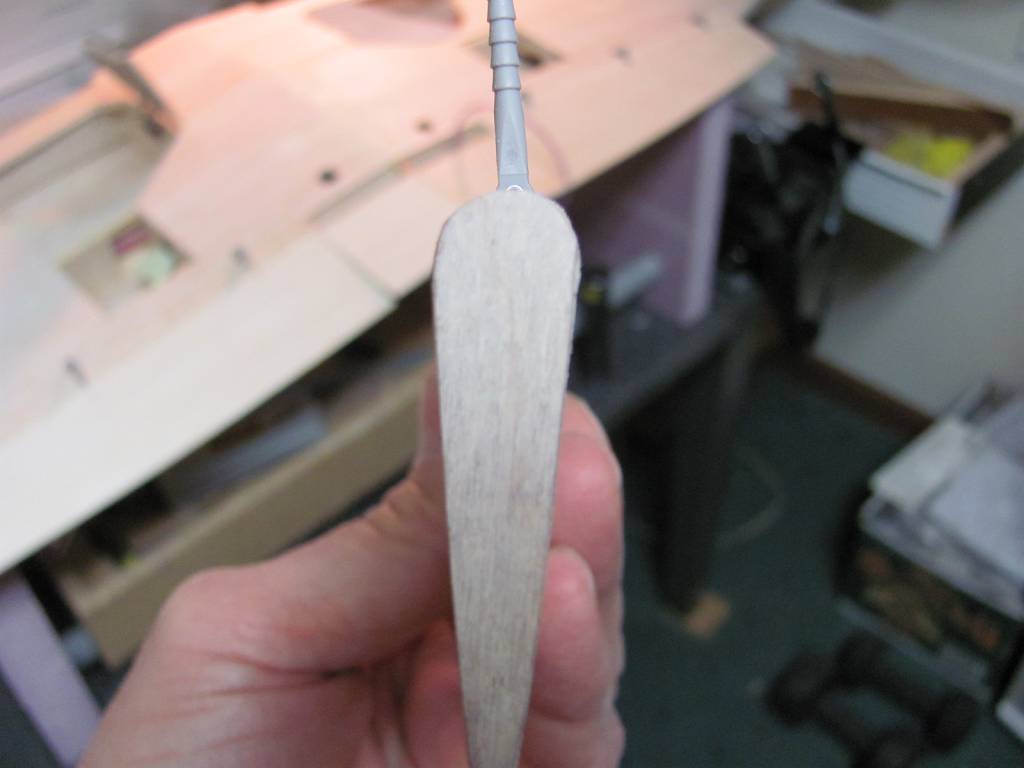

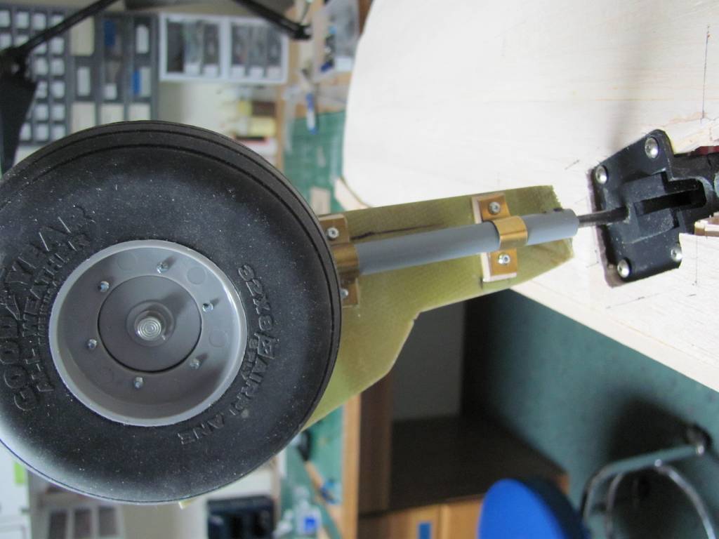

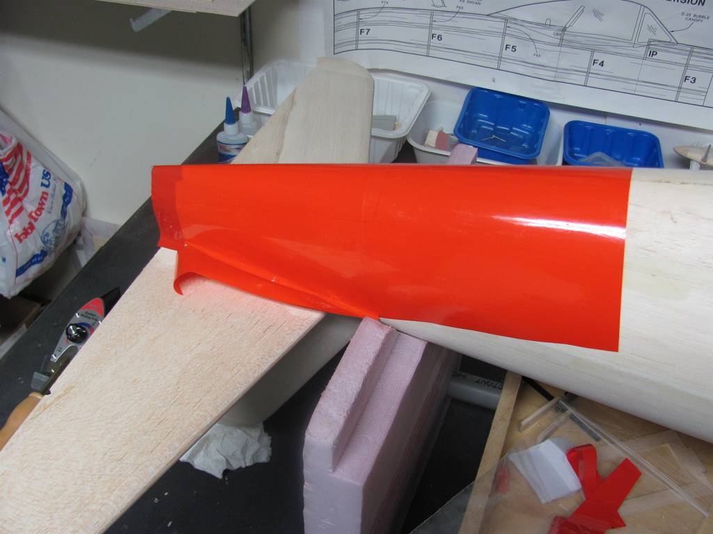

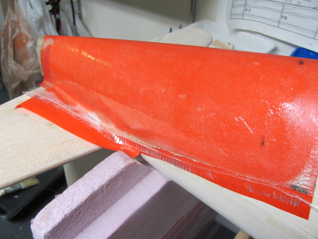

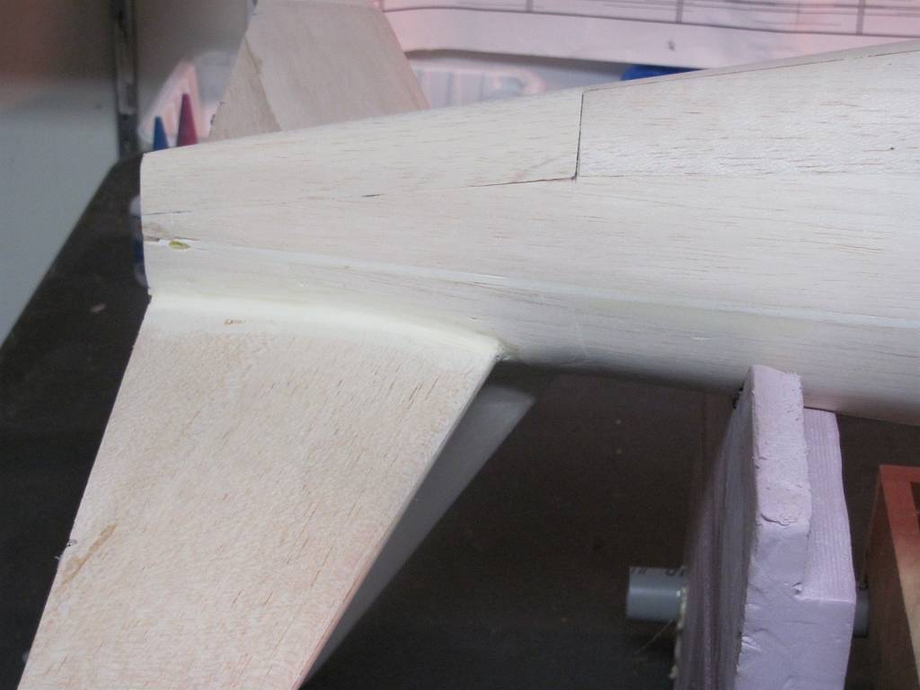

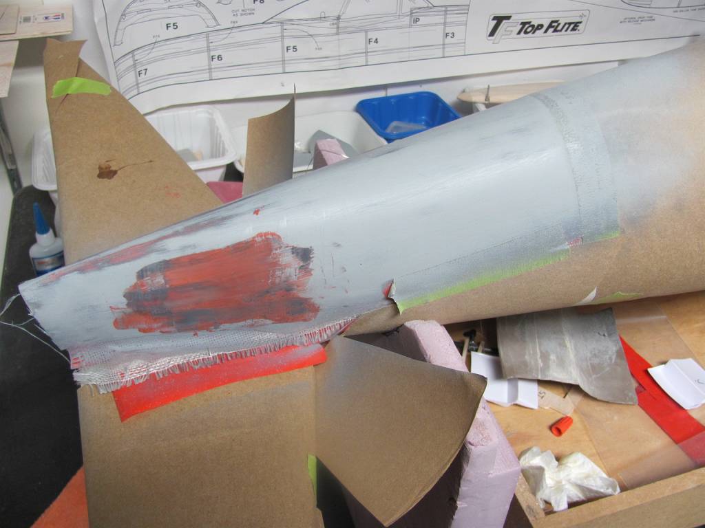

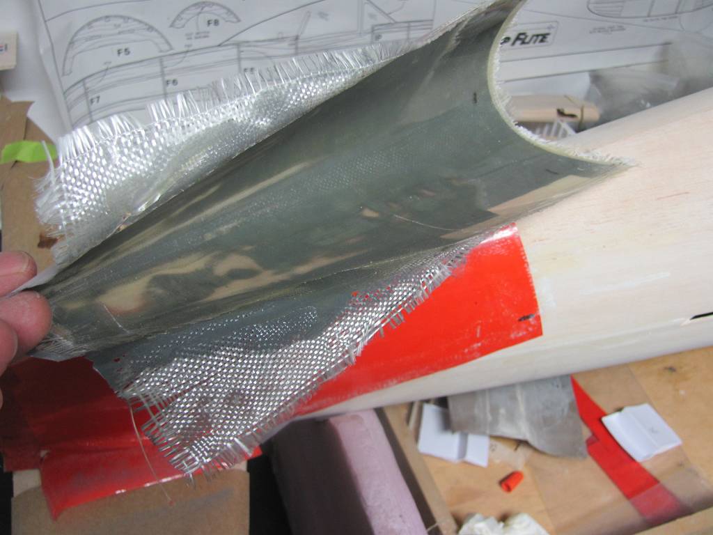

Next, Icut up some 5oz and 6oz fiberglass cloth and mixed up some zpoxy finishing resin and laid it down over the monokote area. Iwent a little on the oversize direction but I wanted to make sure I had enough area to work with so I wouldn't be short. Make sure you really work the epoxy in well to get it all the way through the glass. Ibrush it on then use an old credit card to squeege it in and then brush it out smooth. Allow it to dry 24 hours then start sanding in place. If you get all the excess epoxy offwhen you laying it up then it shouldn't be to hard to smooth it out. You just want to get the rough spots out. Next I spray it with primer filler, which is heavier than just primer and fills all the small imperfections and the weave of the glass. Sand again with 150 grit then 220. Most of it will sand off leaving only the low areas with primer. Hit it again and when dry sand again the same. Next I use auto spot putty to fill in the worst areas and allow to dry then sand again. Another coat of primer and then wet sand with 220 and it should be good to go. Now to remove it all you need to do is slip a putty knife between the glass work and the mono and it should pop right off.

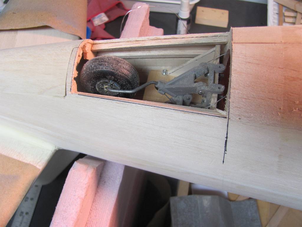

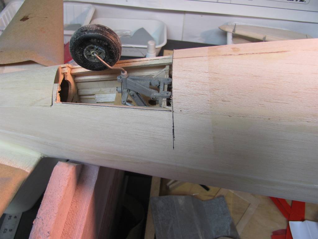

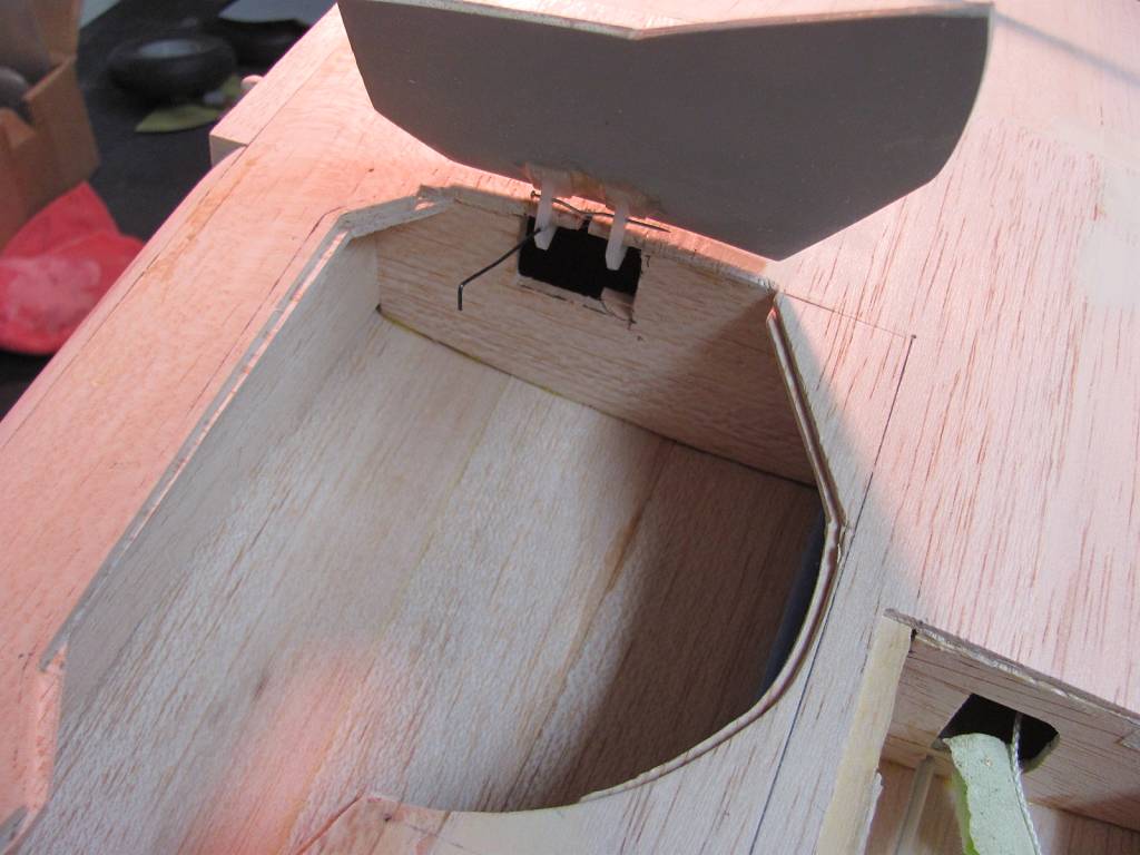

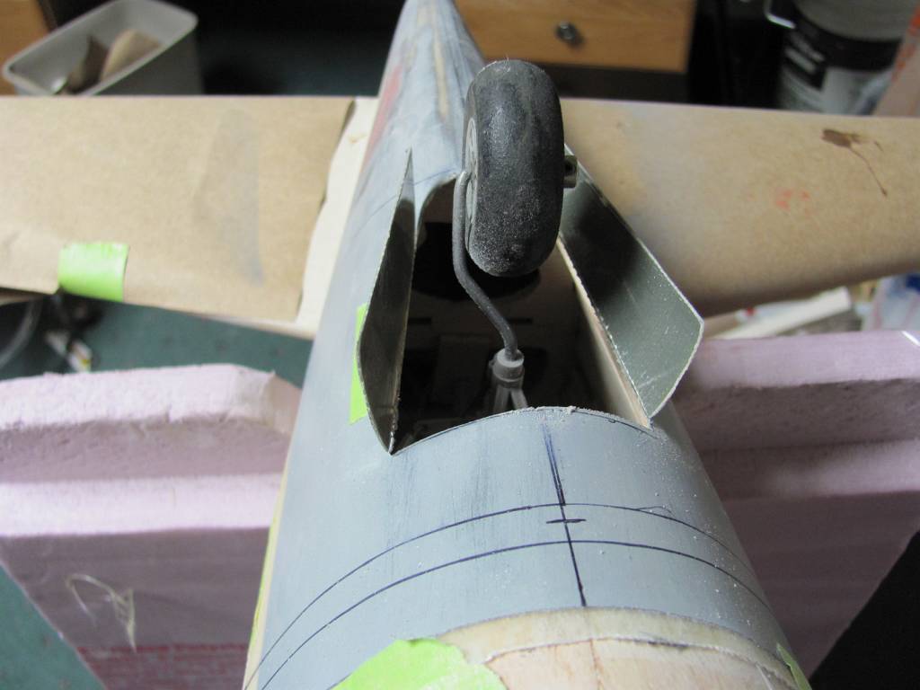

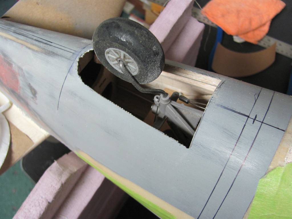

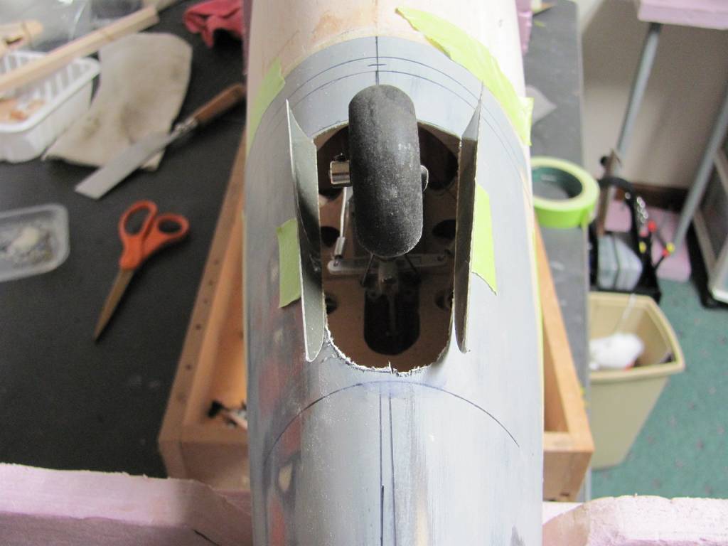

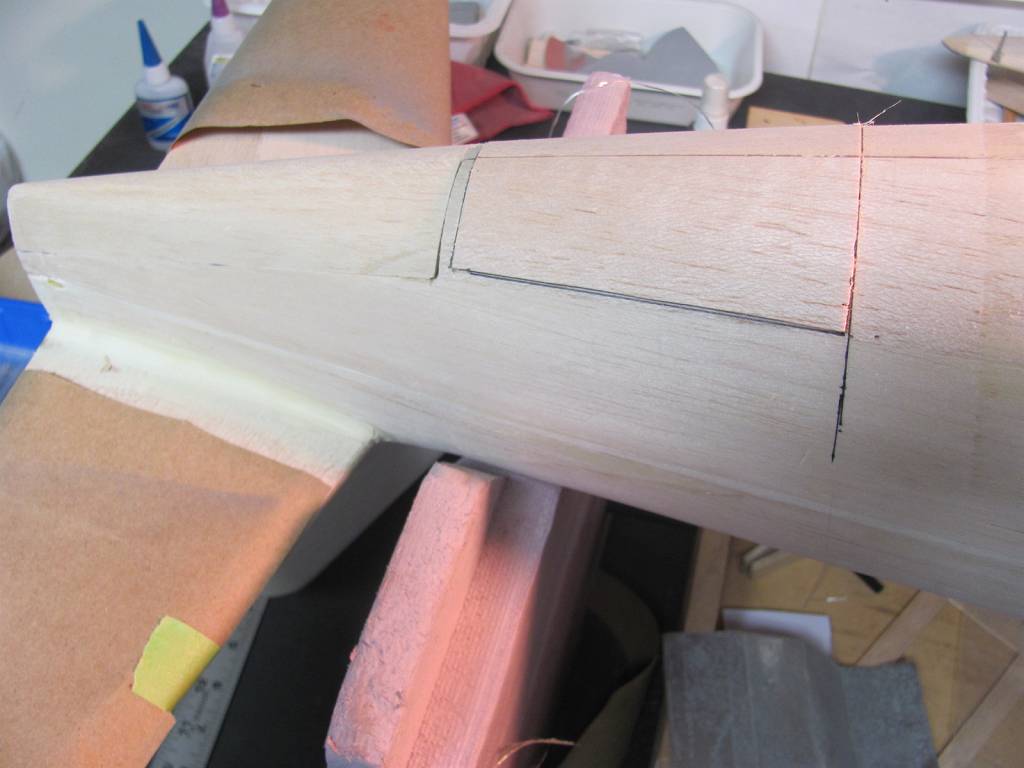

Looking good so far right? RIGHT? o.k so now it's time to cut into the fuselage and remove the area over the tail wheel. I located the stringers inside using pins and looking inside witth a flashlight and then marked the sides so I knew where to cut and then I cut down through using the formers as a guide for the verticle cuts. Next I drew the wheel oopening onto some heavy card stock and then cut it out and laid it on the fuselage over the tail wheel and lined it all up to center the tail wheel and to check for clearence. Make some reference marks on your template and on the fuselage so you can go back and check it again if you need to.

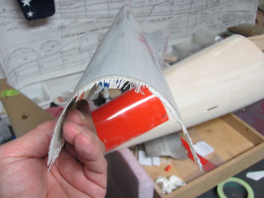

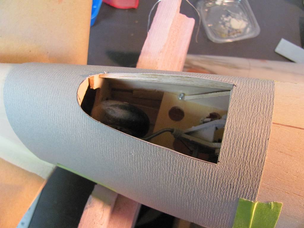

Now lay your glass tail cone back onto the fuselage and tape it down then using a ruler draw a center line down the middle, I use fine point sharpies for all my marking and if you need to redraw then you wipe it off with alcohol. Now lay your template back on top and line it up over the center line and tape it down then trace the wheel opening. I used my Dremel tool with a very thin abrasive blade to cut out the wheel opening because what you cut out will be your doors. Now very carefully( you only get one shot at it) cut down the sides, the end and the middle of the opening to create 2 doors. Ok so how did he cut so nicely around the curve end of the doors? Can't tell you, you'll have to guessJust kidding. Igot to that point and said the same thing, now what? Icould use my 1/8" rotary bit but that would make to big of a kerf then it hit meA long time ago I bought a set of these micro carbide cutters from Harbor Freight thinking maybe I might use these some day and today was that day. They are so small they hardly remove much at all leaving me with a nice set of doors. A little sanding of the edges and things look good.

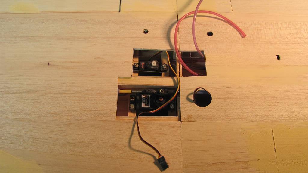

Well, I have been slowly making some headway and have finally finished the gear doors and the wing sheeting, and I'm now starting to create the wing fillets. I hope that AY is making some progress and can post some updates. I bought another arf over the winter, the TFP-51 hope to put that together by late spring and be close to finishing the P-47. Still having the server error msg so no pics yet
