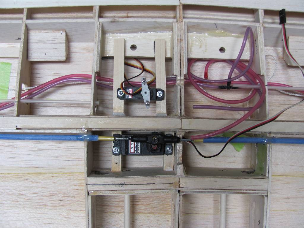

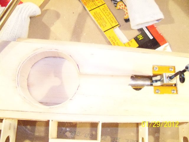

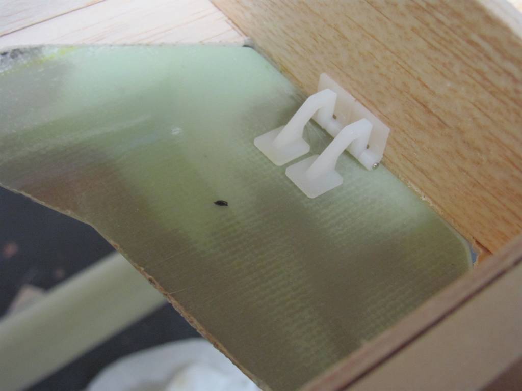

Well, hallelujah! It's about time. The pics are of my servo setup to actuate the cables to control the bomb drops on the wing pylons, I am using a micro servo. There's nothing like a fully loaded jug

I'm using very thin music wire inside the tubes to pull the spring loaded pins on the release mechinisims, just like my last one

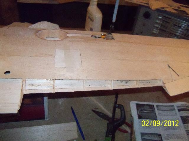

thought i would join your thread if you dont mind

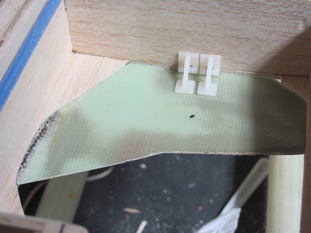

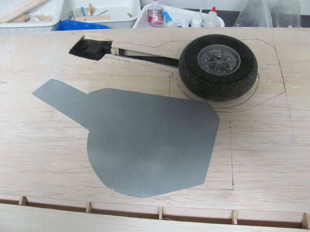

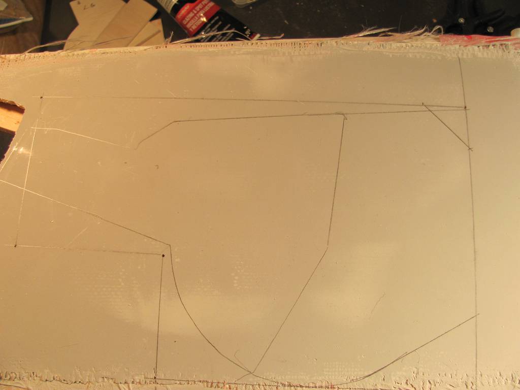

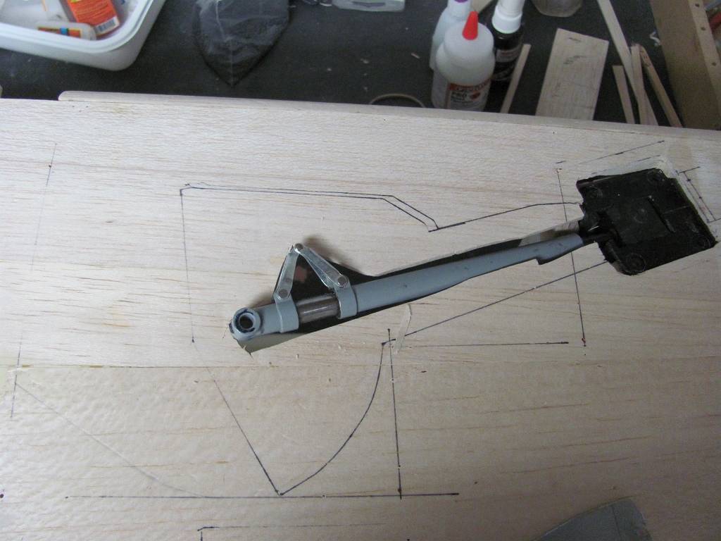

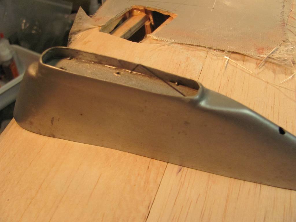

Back again with some more updates. I’ve been working on making gear doors all week, laying up fiberglass and fretting over some details. Not a lot to show for the week but I’ve had other things to do. I laid down some monokote on the wing in the gear well area and then put down four layers of 5oz cloth with epoxy resin to form the blank for the doors. I made a paper template of the wood gear door parts that come with the kit and then traced them on top of the fiberglass. I first heard of this process from the book RC finishing and detailing available from Model Airplane News, but it’s a pretty common technique describe here in the various threads. After laying them out I removed the fiberglass as one big piece by slowly prying it loose using a thin bladed plastic artist spatula. I will rough cut them out and then finish sanding them to the line, lay them on the wings again and cut out the balsa. I haven’t worked out how I will attach them yet or operate the inner doors. In the mean time I had to do something else because I needed to see some real progress so I spent a day working on my P-40 arf from Topflite. They really do a nice job for an arf.
ID:	1726241   Click image for larger version

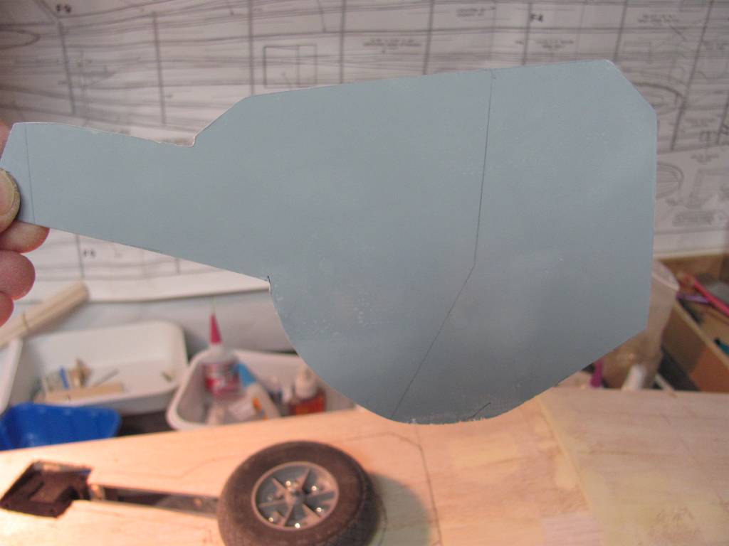

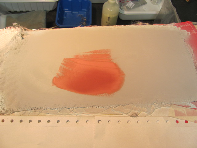

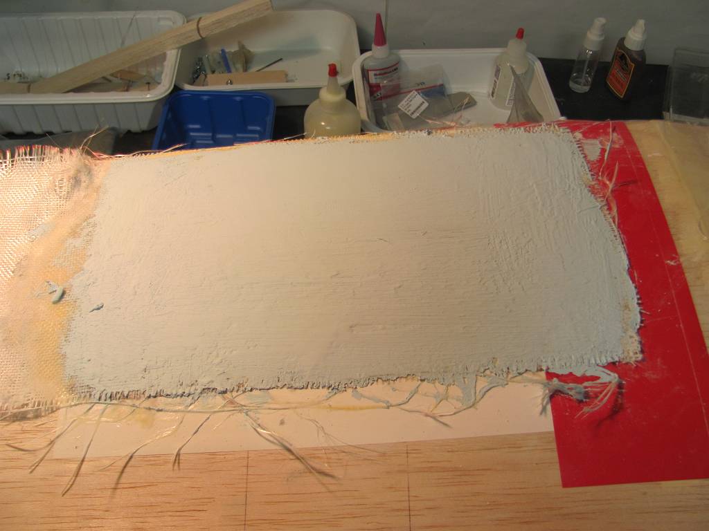

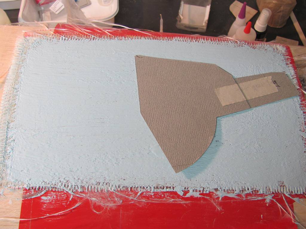

The blue stuff you see in the pictures is a autobody spot putty that I thin out and then brush on the fiberglass to fill in the weave after the epoxy has cured. I then sand most of it of with 80 gritt paper then wet sand with 120 grit and then finally with 220 grit. Hit it with some primer to show where th low spots are and then some more sanding and touch up with spot putty and then more primer and .... you get the idea lots of work[&:] but when your done it looks great. Here are the final results

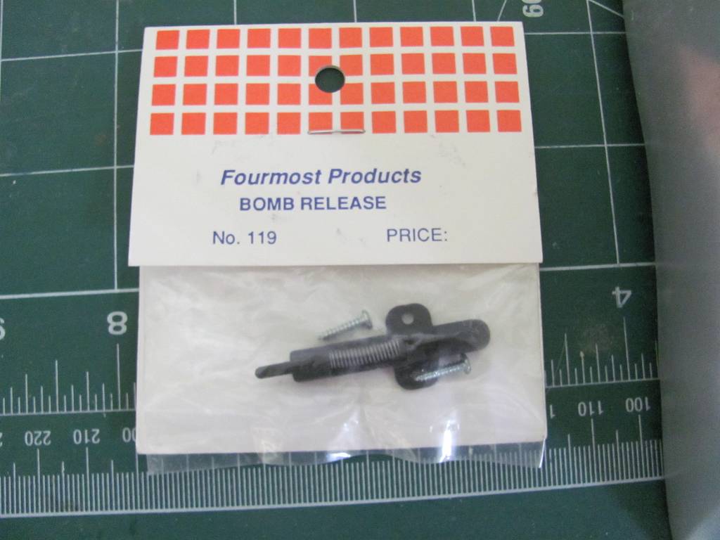

I had a PM from a fellow Jug builder wanting to know about the setup for the bomb drops so I'm adding a few pictures. If you are building yours stock you will see on the plans that there is a servo next to the aileron servo used for the drop tank. On my last Jug I used it to operate the bomb drops on the wing pylons, but since I modified this one for scale gear location I had to relocare the servo and I decided on a micro servo to operate it I used some left over inner nyrod to run some very fine music wire over to the pylon locations and then up through the pylons to the bomb release. Its really quite easy to do and adds to the fun factor

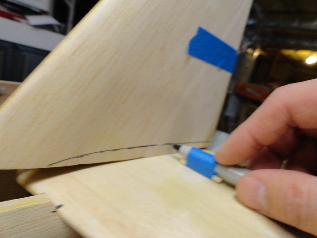

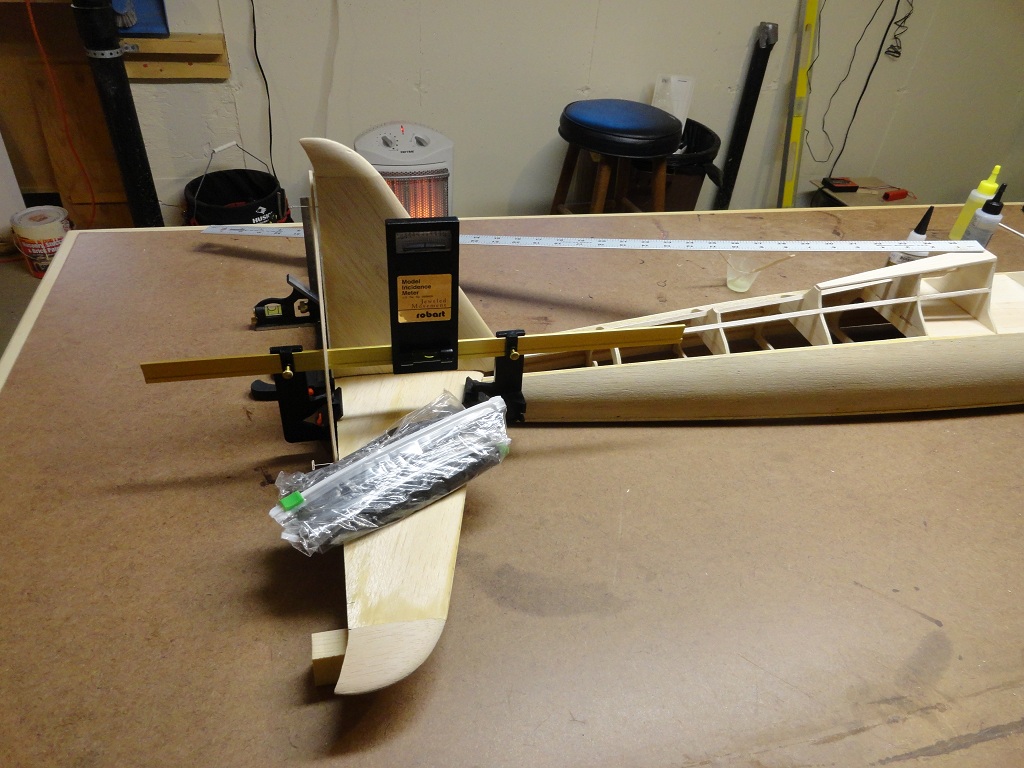

<font face="Verdana">I ended up going backwards today
I made great progress getting the stab and fin fitted to the fuse and aligned this weekend. I got everything true and square and ready to go. I even picked up a Robart incidence gauge and used it ensure that the stab had the proper +1 deg. incidence angle. I mixed up the epoxy and got everything glued up and fitted into place. Now I start to worry because after 90 minutes (using 30 minute epoxy), the epoxy left over in my mixing cup is still soft and tacky and shows no sign of kicking. I hit the cup with a little heat and the epoxy immediately turns runny, so </font><font face="Verdana">I convince myself that I did not add enough hardener.</font></p>
<font face="Verdana">I know that 30 minutes epoxy takes about 8 hours to fully set up, and that there is some forgiveness to the mix, but I decided that I&rsquo;d rather be safe than sorry, so I pulled everything apart. Of course, this leaves me with a big sticky mess to clean up. I got most of it cleaned off by heating it up and scraping it off using single edge razor blades. While doing this, I managed to cut my finger and did not notice that it was bleeding until I saw blood stains on the balsa!</font></p>
<font face="Verdana">I think I have everything cleaned up with only some minor cosmetic damage. I am off to North Carolina again this week, so I won&rsquo;t be able to try again until next weekend. </font></p>
