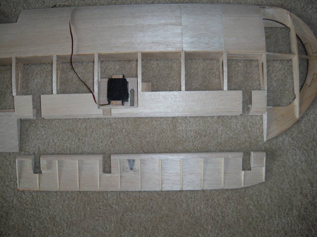

<span style="font-family: Comic Sans MS">so here's what i'm left with for repairs. the tip and leading edge are complete, now just for the hinges on the ailerons. i plan on cutting blocks as mentioned, filling them in place, doing a little putty and relocating the hinges over a little. going to be a bit of a pain re-shaping the trailing edges of the wing to the same contour as the rest of it. i can't seem to find the drum sander for the dremel.
still no sign of koverall and stix-it from sig, either, after 2 weeks. hmmm...</span>

Can you "pre-shape" your block before you glue it in? Just a thought.
Old 11-01-2011 | 08:39 AM
Joined: Aug 2009
Posts: 643
From: McChord AFB / Orting, WA
Default RE: unhinging control surfaces
<span style="font-family: Comic Sans MS">i'm pre-shaping it a little before glueing it in, but i previously had this bad habit of taking a 'little too much off the top', so i bought one of them little planer/shaper doohickies, and i have no idea at all why i didn't buy one of them when i first started modeling. i guess i used to like sanding, but heck with all the mess and dust. true, the planer does too, but it's a lot easier to track how much you're losing at a quicker rate. </span>
