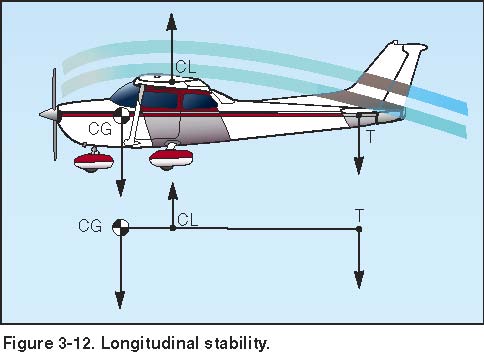

Old 01-11-2012 | 10:20 AM
  #63
Lnewqban's Avatar
Joined: Apr 2007
Posts: 4,057
From: South Florida
Default RE: adding weight?
ORIGINAL: rgburrill
Dumb, dumb. I did not get that is what he meant. You, and he, are correct, moving the wing back would move the required CG back.
Thanks for pointing that out.
Yes, that too, but more important: moving the wing aft will move the center of lift aft, increasing the distance between both centers.
That distance is the stability margin that every plane needs in order to be stable in pitch.
What the OP has now is a distance between the CG and CL that is smaller than ideal (more pitch control authority, but less pitch stability), zero (dangerously neutral) or negative (tail heavy or total instability condition).
Old 01-11-2012 | 10:21 AM

Old 01-11-2012 | 10:28 AM

Old 01-11-2012 | 10:49 AM
  #67
Zor
Banned
Joined: Feb 2009
Posts: 3,524
From: Ontario, ON, CANADA
ORIGINAL: speedracerntrixie
So a correctly trimmed 2 pound electric park flyer will fly well in a 15 knot wind? I don't think so.
At first I read this and thought what an over exaggerated example it is. But I thought about it more and the answer is a yes! A well set up and trimmed 2 lb airplane would fly better then a poorly set up and trimmed 2.5 lb airplane in a 15 knot wind. Again, the airplane sees wind as a change in airspeed. A poorly setup airplane will react to changes in airspeed so obviously it will react to wind. <span style="color: #808000">Ask yourself if your airplane's trim changes at all between 1/4 and full throttle. If the answer is yes then it is not trimmed correctly.</span> Does it really matter? Not if you are happy with the overall performance.
[/quote]
Icannot fully agree with the green colored highlighted above.
Just before take off the trim is set for normal climb.
On levellng in cruise the trim is reset for cruise.
On descent and approach to landing again the trim is reset for approach speed.
None of the above apply to a model flier just constantly executing changes in attitude (note att no alt).
Changes in trim with changes in power setting is normal and not an indication of not being trimmed correctly.
Zor
Old 01-11-2012 | 11:06 AM
  #68
Zor
Banned
Joined: Feb 2009
Posts: 3,524
ORIGINAL: rgburrill
ORIGINAL: HighPlains
Finding lead is easy.
http://www.rotometals.com/Lead-Sheet-s/31.htm
Do you people not think? Weight is not his problem, balance is. Adding a pound of lead at the CG won't do a damn thing for him.
A quick recap - There are two separate discussions going on, so reading comprehension is required.
1.) On the issue of an airplane being "two light", add weight and get back to us.
2.) Moving the wing back on the fuselage will balance the plane. Easy to do when it has a wing tube and simple mounting.
We return you back to your regular programming.
Dumb, dumb. I did not get that is what he meant. You, and he,are correct, moving the wing back would move the required CG back.
[/quote]
Careful guys.
Moving the wing back will move the CG back in relation to the fuselage but it will move it forward in relation to the wing and that is what counts.
Imagine the wing is moved all the way just in front of the fin. Where is the CG then ?
Zor

ORIGINAL: Lnewqban
ORIGINAL: cfircav8r
When flying full scale I love a light snappy A/C, however when I am flying full IMC with passengers it is far more comfotable for them and far easier for me if I am closer to the max gross weight.
Interesting!
Do full scale pilots have any control over the CG location, or do they have to fly in a different manner when that CG is way off the ideal location?
You have a range that you can safely operate in and can move passengers or luggage to help. Ideally you want to fly towards the rear of the the envelope for better range and speed, but it is better to stay more forward for turbulent conditions and when doing aggressive maneuvers. Some also have different ranges depending on the type of flying or configuration.
Old 01-11-2012 | 06:48 PM

Thanks, cfircav8r.
Again, very interesting to me.
During a time of my life, I was loading and unloading UPS planes at the local airport.
There was staff dedicated to perform calculations for us to relocate containers of the packages along the fuselage, just to keep the CG close to where it should be.
