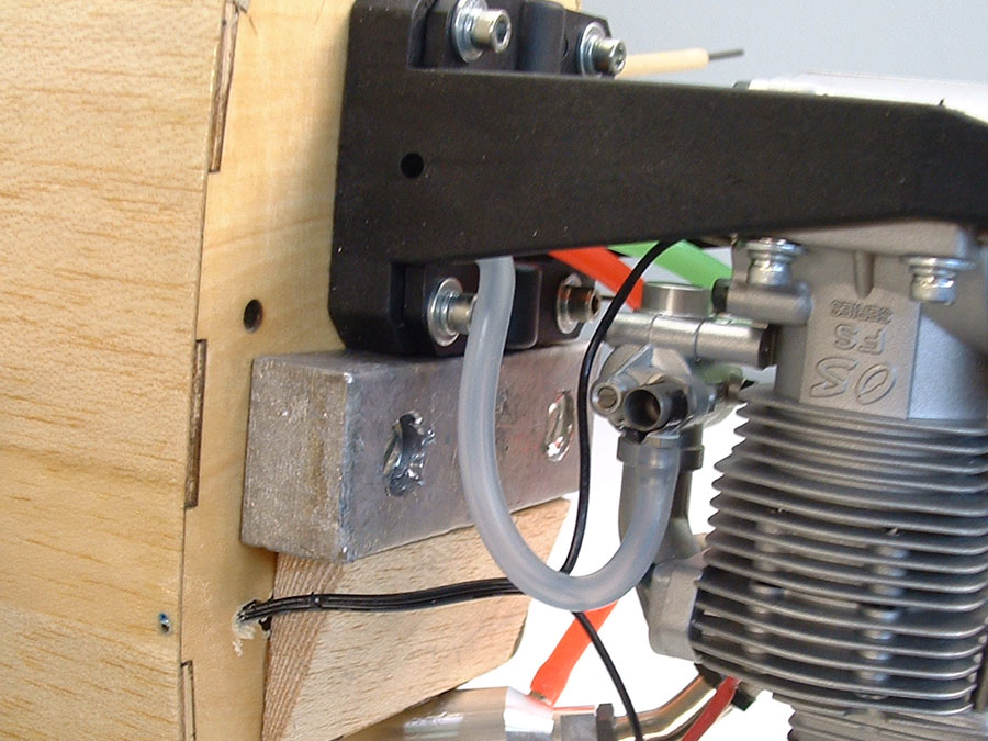

My sig complete minus fuel weighs almost exactly 6 1/2 lbs. However to balance I will need to add 6 oz. (roughly) to the nose. Would it be worth it to buy new engine mounts and slide the engine foward? I have it mounted as per plans. I just think 6 oz. seems like alot. Plus I was happy the plane came in at such a light weight. Be a shame to heavy it up just to balance.

Default RE: adding weight?
Here's about a pound and a half of lead in the nose of a P-40 - She flew great!

Has anybody ever installed the Rx battery next to the engine for CG balancing (over, under)? Or is that too stressful to the battery?

The weight of the struts on the tail and the tail wheel could make a lots of difference. On the SE you will have a heck of a time moving the radio gear. A pic of the side vew of the plane would really help!

My B-17 model takes 7 pounds to balance, and my Sig kadet LT-40 took 1.5 pounds to balance, flew like a sport plane.
Airplanes that are a tad heavier fly just a little better anyway IMO.
