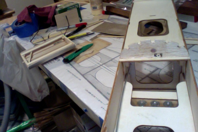

I just look at everybody's planes - new, old, scratch, ARF/RTFs. Some have creative bits and pieces.
The SSE canopy / cockpit hatch is made with a former up front, a former at the front of the cockpit (dashboard) and a headrest. Between the front former and the dashboard they use several 1/8" stringers with the front and rear formers cut to accept them. I just did the same using a lite ply base, lite ply formers shaped to match the HB "shape", cut some stringer slots, added stringers and then sheeted with 1/16" balsa. Also reinforce the sides of the fuse. Add a couple of cleats to the bottom that position the hatch bottom between the reinforced sides. I used 1/16" dowel to pin the front of the hatch into to back of the firewall area. A couple of magnets at the back and it's all good.
And, no, you can't have mine!
pic 1 - tank hatch on an SSE
pic 2/3 - top and bottom of cockpit hatch of an SSE

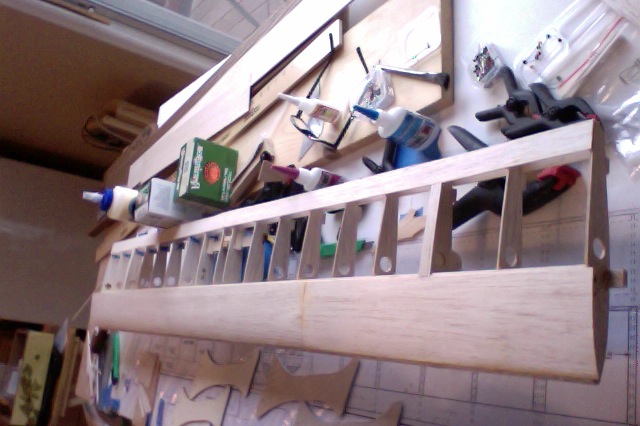

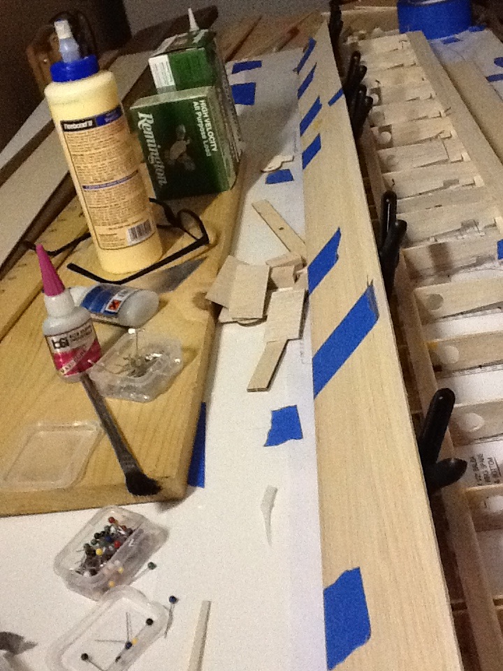

Moving along with the build , Balancing act between slow enough to build it right and fast enough to stay excited.
The clamps are there for the balsa to lean against so the sheet will have a flush fit with the leading edge stock.the blue tape holds it tight.
After the glue dries , a little water / amonia mixture to shape the balsa sheet to the ribs and TA-DA.

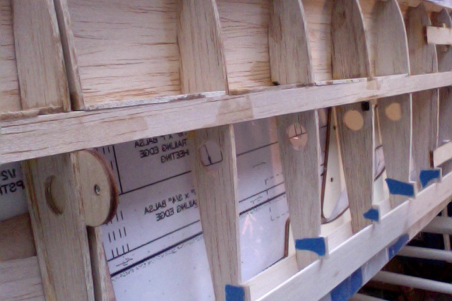

The leading edge sheet went on nicely and the water/ amonia worked well. Good joints between ribs and sheet .

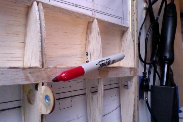

This is what he was referring to :
The red pen shows a gap . The other photo shows the proper position.
To fix or not to fix , that is the question . I think because the piece is close to where it should be and glued in tight - move on.
Seamus ( a very talented and veteran builder ) suggested that I dig it out and move it.<br type="_moz" />
