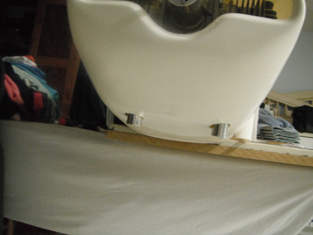

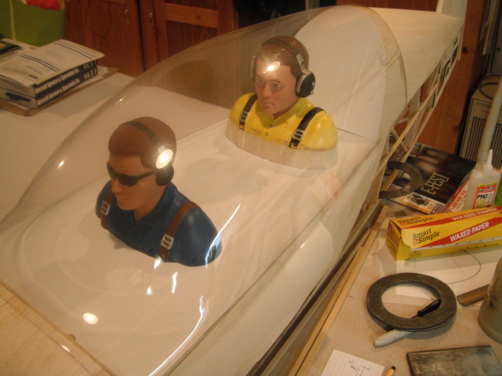

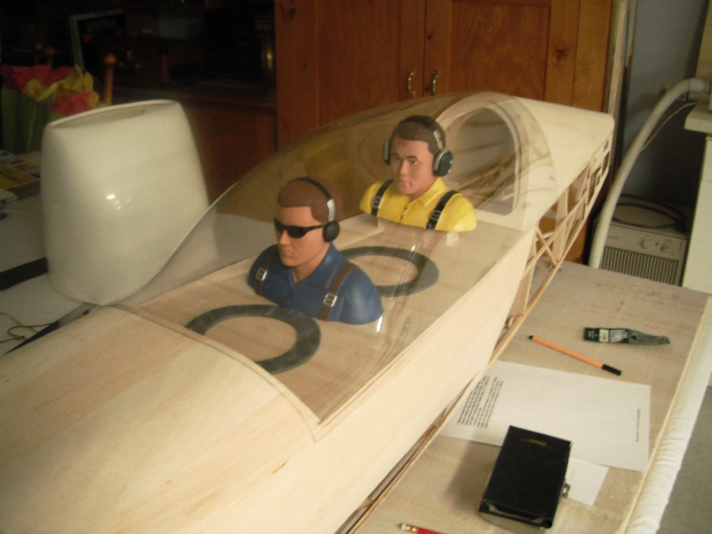

Found another pilot figure, this helps filling up the large canopy area, still have add a 1" block to the pilot.

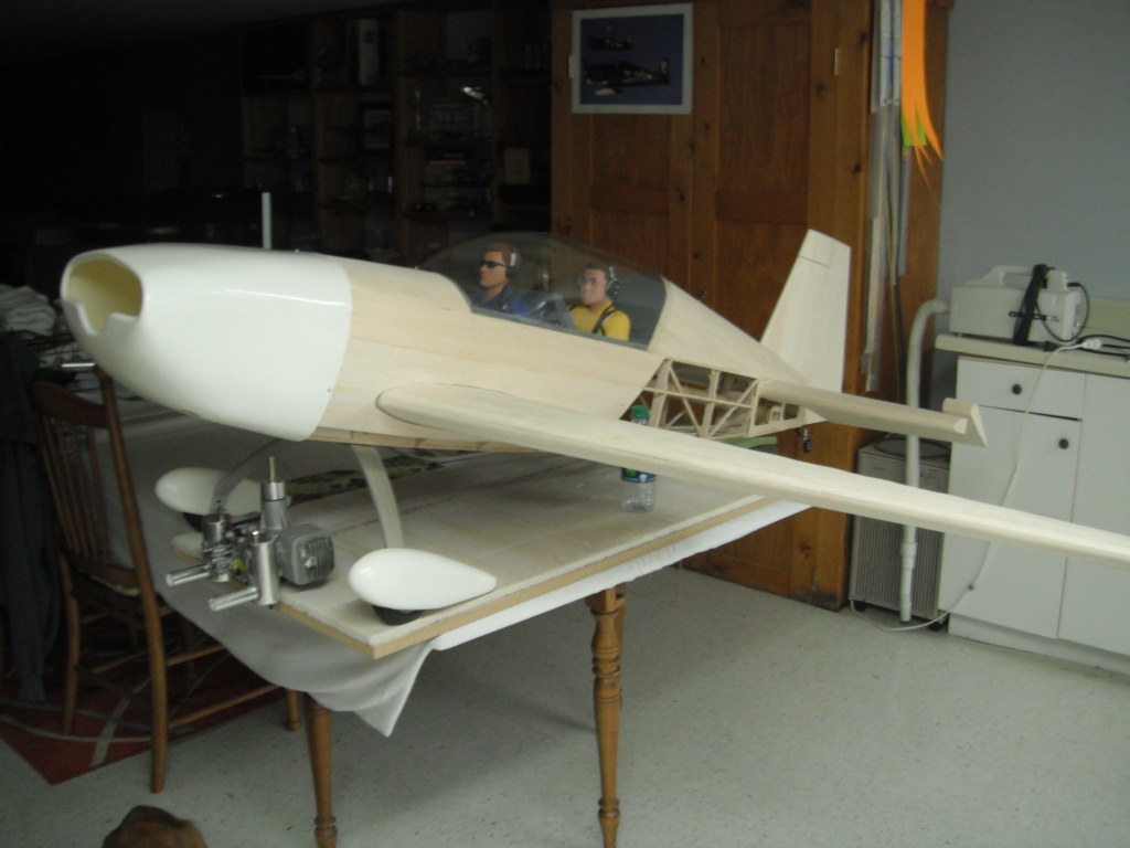

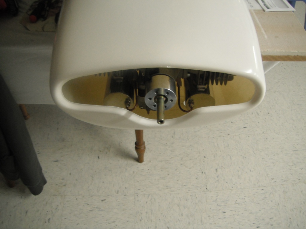

Not a lot of progress so far this weekend. Did get the exhaust fitted to the cowl and shortened the pipes about 1". These are the after market DLE smoke mufflers that i purchased for the GT-80, so with the change to the DLE-111 these mufflers fit perfect. Any advice on how the baffles and exhaust air outlet configuration should be done would be greatly appreciated. Please post any pictures you have the same or similar set up.
ID:	1766163   Click image for larger version

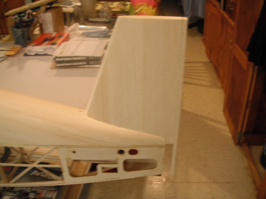

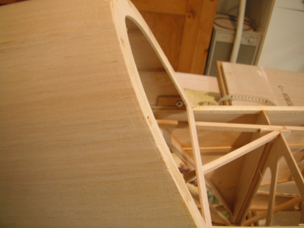

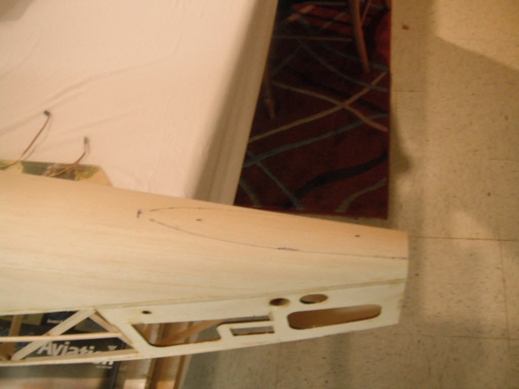

Bouncing around a bit on unfinished items over the past couple of days. Fitting the vertical stab is taking some time but it close to complete. The pilot now has a 1" block to get a more appropriate height. I used .040 white plastic sheet to form the floor and rear of the cockpit. More to follow on that as well. Nearing time to order the covering and paint.
ID:	1767098   Click image for larger version
ID:	1767099   Click image for larger version
ID:	1767100   Click image for larger version
ID:	1767101   Click image for larger version

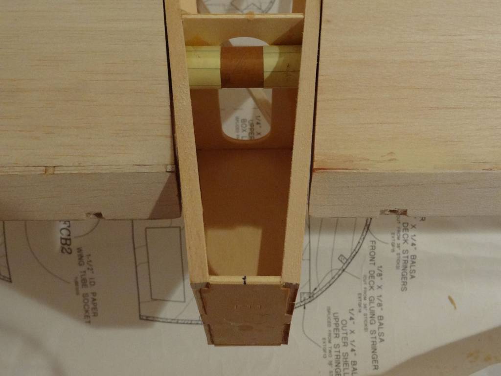

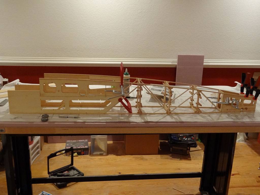

After another week off from traveling due to a family medical issue i have gotten some work done yesterday and today. The most significant deviation so far from the kit design is the attachment of the canopy. Instead of gluing the canopy to the floor, i have added screws for attaching it to bass rails and a machine screw and blind nut with a piece of 1/8" ply to the inside of the fuse to attach the entire assembly. The 1" block is also finished adding height to the pilot.
ID:	1772911   Click image for larger version
ID:	1772912   Click image for larger version
ID:	1772913   Click image for larger version
ID:	1772914   Click image for larger version
ID:	1772915   Click image for larger version
ID:	1772916   Click image for larger version

My experience with similar canopy installation as your is the canopy cracks in the screws that receive vibration from the frame. My solution has been to reinforce the interior of the canopy with packing tape. The type of tape that has nylon fibers. Of course, it is not nice but it works in preventing more cracks.
In your experience, how do you avoid that problem?

Good point. I have not assembled one of this size before. On my Goldberg Extra it has not been an issue. I will add the tape, the outer portion of the canopy frame will be painted hiding the tape on the inside. Thanks for the heads up.

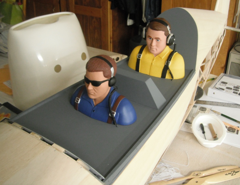

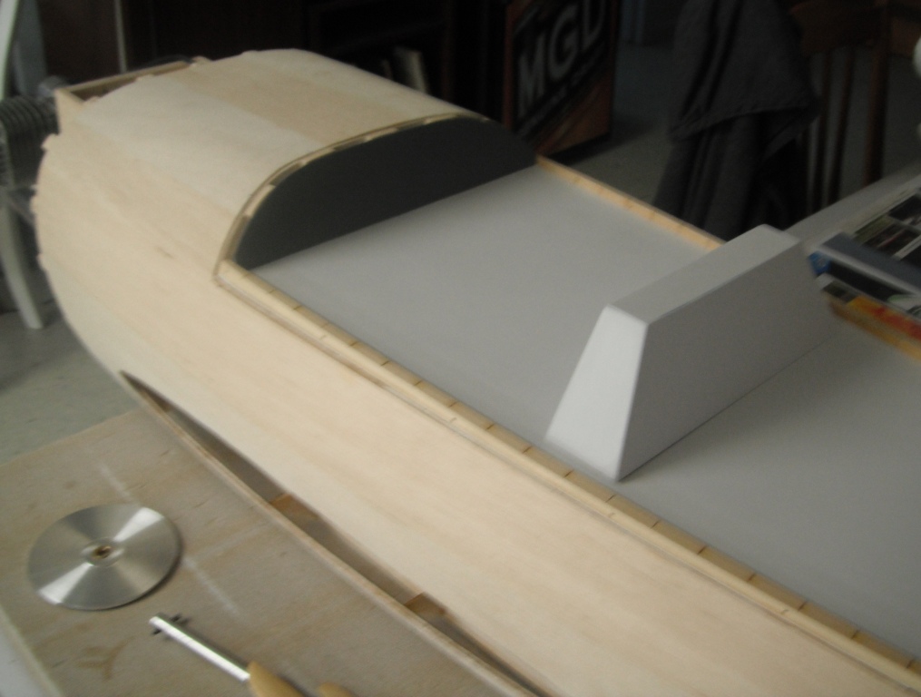

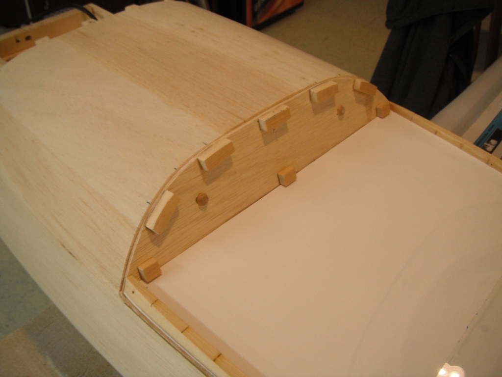

Cockpit insert is complete. The heat wave is allowing a bit more time to be spent in the workshop.
ID:	1779804   Click image for larger version
ID:	1779805   Click image for larger version
ID:	1779806   Click image for larger version
ID:	1779807   Click image for larger version

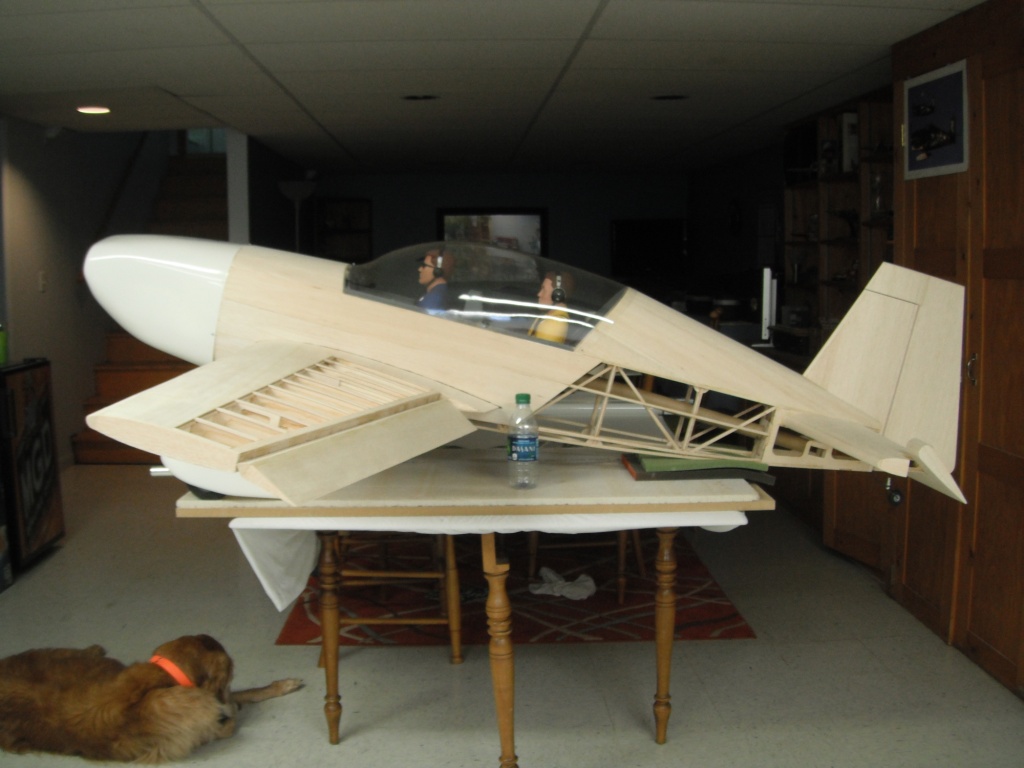

Hard to believe it has been nearly a month since the last update. This one is finally ready to cover. It has been a lot of fun building.
ID:	1789356   Click image for larger version

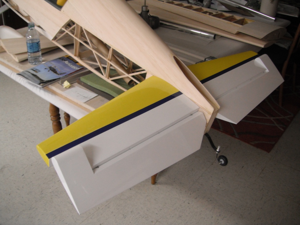

Horizontal stabilizers are now covered. A little color adds a lot.
ID:	1797988   Click image for larger version
