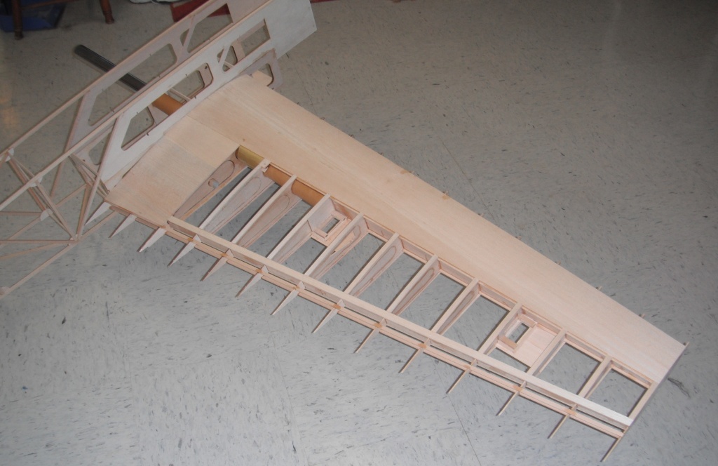

Made some decent progress on the left wing panel this weekend.

A couple of minor changes regarding the ailerons. Added 1/4 X 3/8 spruce blocks for the servos and changed the control horn mounting plates by replacing the 1/8 small light ply plate to a full rib width 1/8 (5) ply plate with the stock light ply plate on top. Just some added insurance.

As promised, here are some pics that show the rectangular holes cut in the ribs for the servo connectors and the small paper tube at the root of the wing panel for the connectors to pass through where the wing is fully sheeted. The aileron sheeting is close to finished. I am kicking the tires on making my own Y harnesses. Anyone ever try that?

Made some decent progress today. Both wing panels are ready for the ailerons to be separated from the main wing. Probably will not get to do much until next weekend. This working for a living is for the birds, darn bills.
