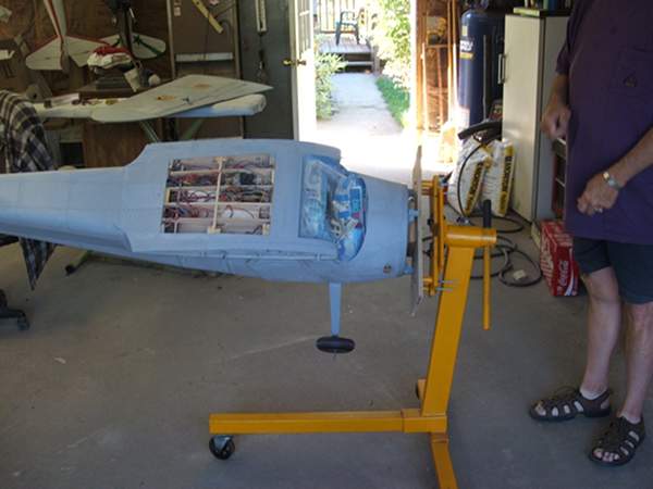

I install the control surfaces, too. I build fixtures to hold the wings. I mount the fuselage on an engine stand, allowing it to be rotated as I paint.
For paint, take a look at Warbird Colors. They have accurate color matching, and a realistic gloss. http://www.warbirdcolors.com/welcome.asp

The stand was $70.00 from the corner auto parts store.
I install my hinges with epoxy. This requires that I put Vaseline on the pivot points. This also protects the hinges from being penetrated by the paint.

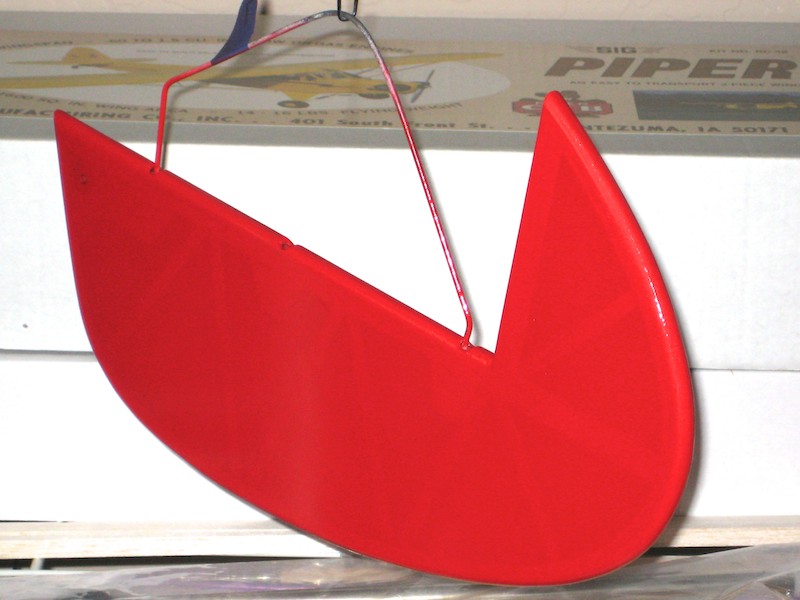

I use a coat hangar inserted into the hinge holes. The hangar is bent in a way I need to pull it wider to get it to enter the holes. With some tension built into the wire the surface will stay on the wire while painting. The wire makes for a nice handle to hold while painting. It is then used to hang the part while it dries. When done you just pull it out.

that looks killer I am going to use the coat hangar
