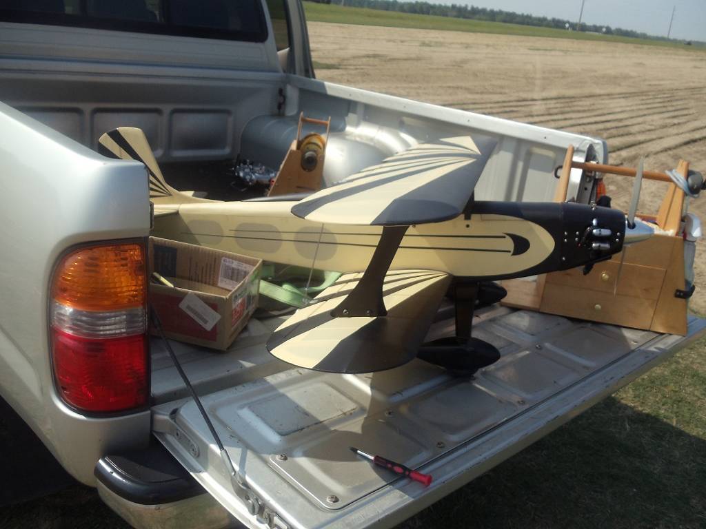

Hello all! Been kinda slack tending to the thread. A day or two has turned to 4 or 5. Lots going on with a house remodeling and the end of the hog build 'Betty Bumble' flew today for the first time. It went great and went through a couple tanks of fuel......And I still got an airplane! Thank You Lord! No real surprises and just a few minor mechanical hickups, mainly on the gear. Had a collet in the gear to slip. Even with a flat spot on the shaft and locktite. Caused a few gyrations on the last couple takeoffs with a tire rubbing on the pants.,
First flight setup was CG @ 25% (maybe more like 23 or 24) (I heeded your advice Daddyo) Throws were as set as close as i could get to the published numbers. exponential was at 30 percent across the board except rudder, which was at 20. A friend , Tommy Paterson, was kind enough to do the first flight and did a great job. Needed a bit of left roll trim and a few clicks of down. Hard to tell with that much wind
Raydar, you are spot on. You gotta love it!!!! Solid and smooth, and that was saying something with the winds we had today. The local club field is plowed under to be releveled, and we all met up on the sod farms. Through a mixup the .last half of the day we flew off a rough area that dealt me several noseovers. Nicked a prop on one of them.
Got one of the glow batteries that i can move aft about three inches, and i am out of bullets on shifting weight around to get CG moved aft unless i jump over former F5 and figure out a way to get the battery in the tail boom. Since i am running the Dubro gear i can block it forward. Also i will add a bit more up elevator travel. Hopefully between these three things the nose over thing will go away. The general consensus in the threads was to move the gear forward, and i should have listened. Especially as heavy as that twin is. If all else fails i can redrill the gear plate. I built it over sized just in case.
Can't get over how well it flew! Really look forward to getting it dialed in and start getting the feel of it. Gunneredwards good luck on the job thing and your hog build. You are off to a great start! Just don't rush it too hard. After all, the build is half the fun!
Got a few pics and a piece of lousy video that i will upload later. Regards to all!

Daddyo, Yup she flew good..... cg was way forward. Tweeked my homemade balance stand design tonight. It had some possible interference points that i was struggling with before the maiden flight that called for some rework. That, and i have a better handle on what i am doing. First flight cg was about 23 maybe 24 percent if that. Well forward of the forward limit.. With that cg, across the speed range, it still needed some nose down trim which turned out to be about 1/8 or so down. Three clicks. Not that much. That would seem to me to be in conflict with what you would think it should be with such a forward cg. In fact, when i read your post this morning, it kinda jared me because my first reaction was the same as yours. Why am i needing a bit of down elevator with such a forward cg? This is in addition to the known .3 to .4 nose down incidence, (trailing edge of stabilizer is slightly lower than the front edge), that i inadvertantly built into the tail. Again, it was hard to tell how much down trim was needed over the full speed range as windy as it was yesterday. I feel good about the wing incidences. Spot on according to the meter, and it is not exibiting the nasty charastics that i understand happen if those numbers are out of whack. All control throws are set at published recomendations with 30 percent exponential across the board with the exception of rudder which is at 20 percent.
That being said i feel sure the need for some down elevator lies in needing some down thrust in the engine mount. You think? For sure the cg needed moving aft, the balance stand don't lie. The cg needed moving aft at least into the forward part of the cg range,
I have moved the radio pack into the tail boom. It is now installed in the turtledeck in front of F6. With it in that position, on the stand with the thrust line level, the cg is at 27 to 28 percent. Well forward of the aft limit and close to the front limit. . Before you think i have lost my mind and not reading the stand and situation right, i have that twin in the nose, and it is way heavier than a single cylinder engine. The airplane would nose over at drop of a hat is another indicator. Now that i have moved the battery pack back about 4 inches, i know this will lead to needing a bit more down trim and the need should be just a simple matter of not enough down thrust. Two things going on there concurrently is my thinking. I am definately open to you thoughts my friend. I sure don't want to do somthing stupid. Any advise from the hog community on this and as to wheather anyone has had to add downthrust would be greatly appreciated.
The other things in your post.... Wheel pants .... I ditched the screws and and am using steel axles. I cut the axles long enough that theyy went through to the outside of the pants and landed them in a hole in a ply plate glued to the inside of the outboard wall of the pants. Increases the toughness of the assembly tremendously. With any luck they will last a while that way has been my experience.
I have no experience with the 90 twin. The published power output of the 100 twin is 1.6 hp. I understand the 90 is considerably less. If you are thinking aabout installing a 90, i would think it would do well. We both need to weigh these airplanes and kick it around some more. I do not have my needles set properly yet. Just running safely rich and relying on the glow system to keep the fire in both jugs lit. That and not really putting my foot in it till i sort out the other issues.
As far as all i said above on tthe trim issues, i am in no hurry to fly again till i get it sorted out. Good luck on catching some decent weather my friend!!!!

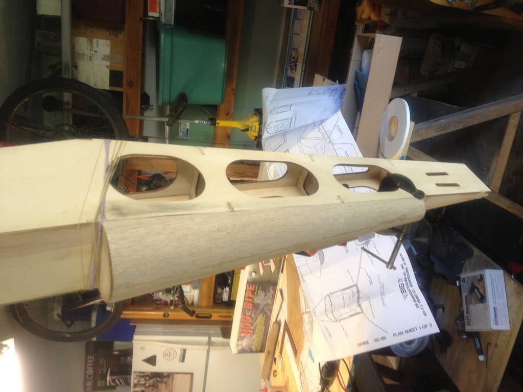

Well I ended up running out of glue... did'nt see that coming. Got plenty now and finished the fuse and upper wing last night. should have the bottom wing done today and the tailfeathers done tonight if nothing comes up. Looks like your hog is operational, but I will have to side with you to take it easy for the first couple flights with low wind to get it all tuned up-can't be too safe.

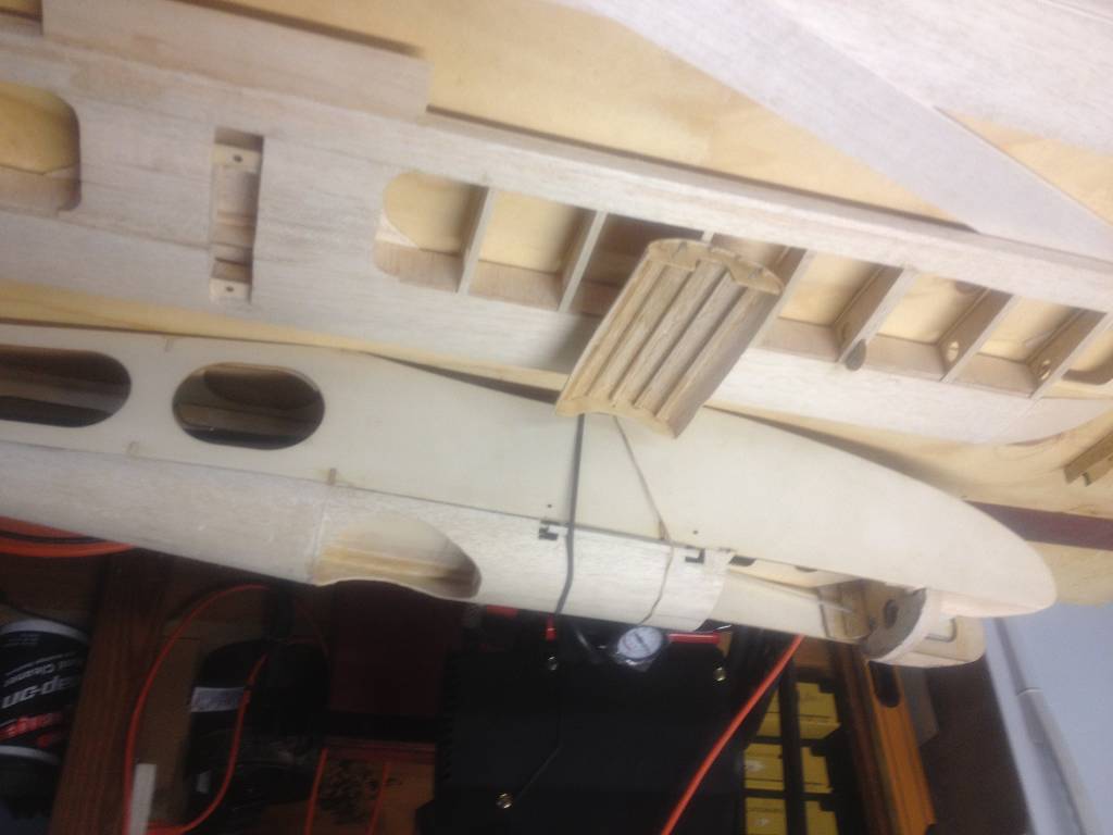

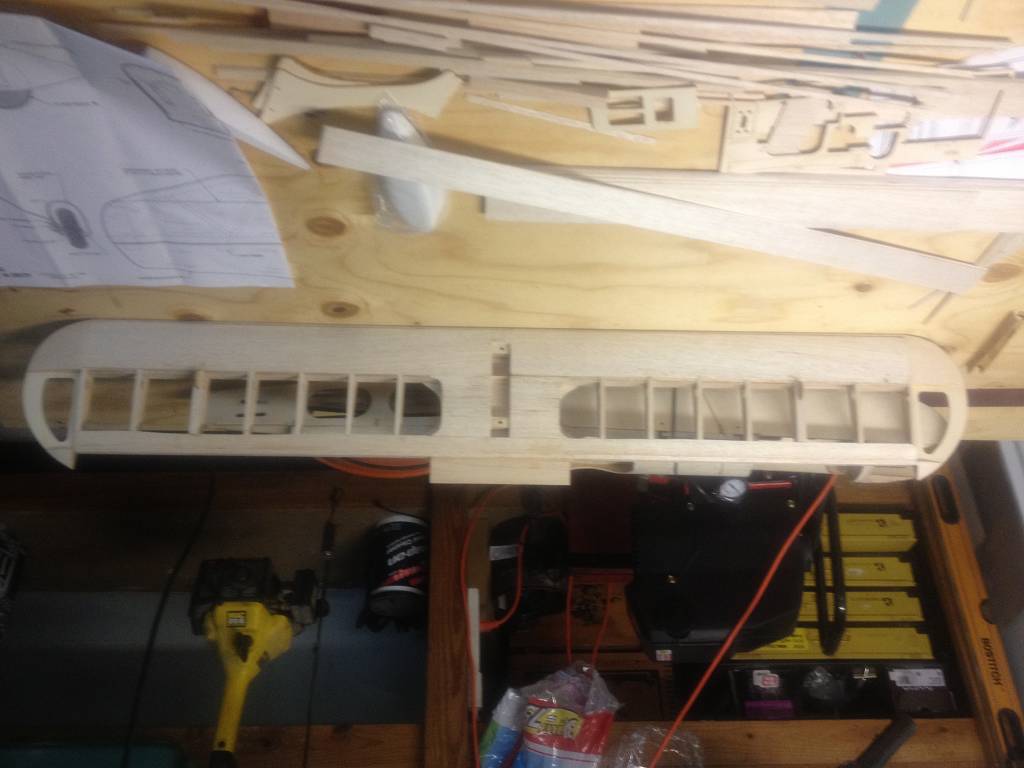

I'll post some today... I have been busy with house things. The fuse and upper wing are done, working on the lower now & yes I will install a fillet on the bottom wing & dual servos. You know I'm used to flying my dazzler and I have lost aleron servos before... so If at all possible I will always go with 2 instead of 1 when possible. So far, I have never had a accident with my dazzler more than having the wheels snap off in the snow and ice on landing. I hope that I will be that lucky with the hog. I have a set of skis that I will try out on it if it ever gets that cold here. (used skis in denver on my cub)

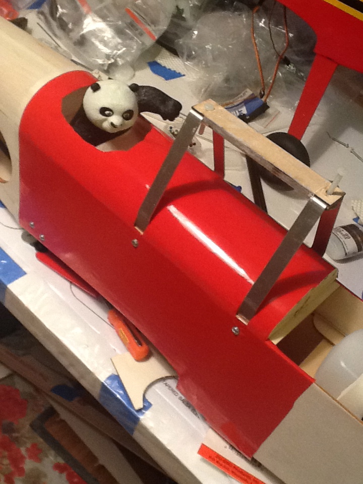

Trying to decide on the pilot. What does everyone think? Post your reply here.
I wish I could pick your brain Steve to help with the covering.<br type="_moz" />
