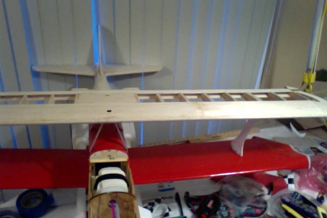

Hey Steve, Just like you said , step by step.
Here is a quick assembly to locate the holes for the interplante strut.<div></div><div>BOTTOM WING COVERED!!!!!!!</div><div></div><div>I am putting the 4-40 blind nuts in the struts then drilling them out so they act like spacers.</div>

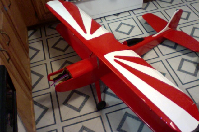

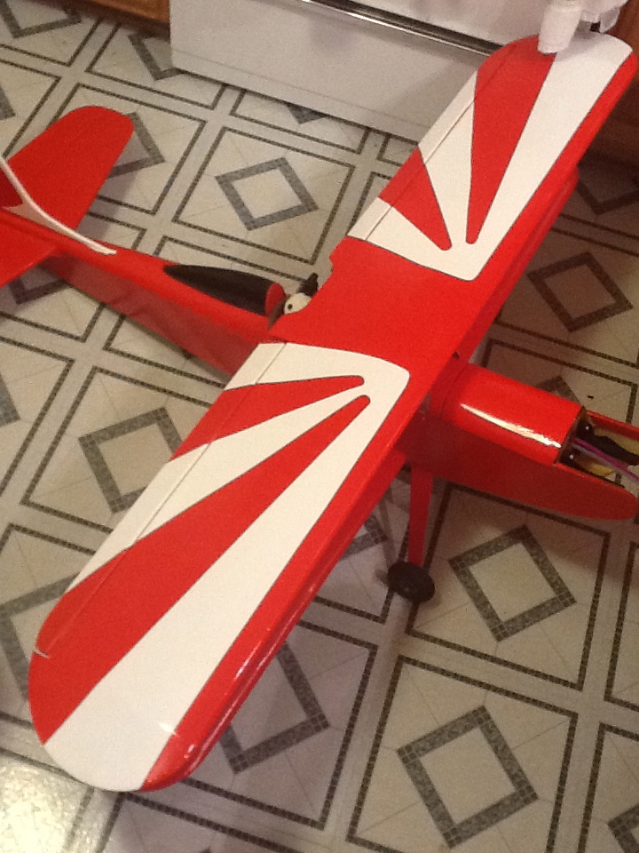

Progress !!!
I still have a lot of work to do but some progress is exciting. Here she is so far.

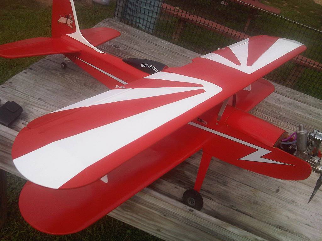

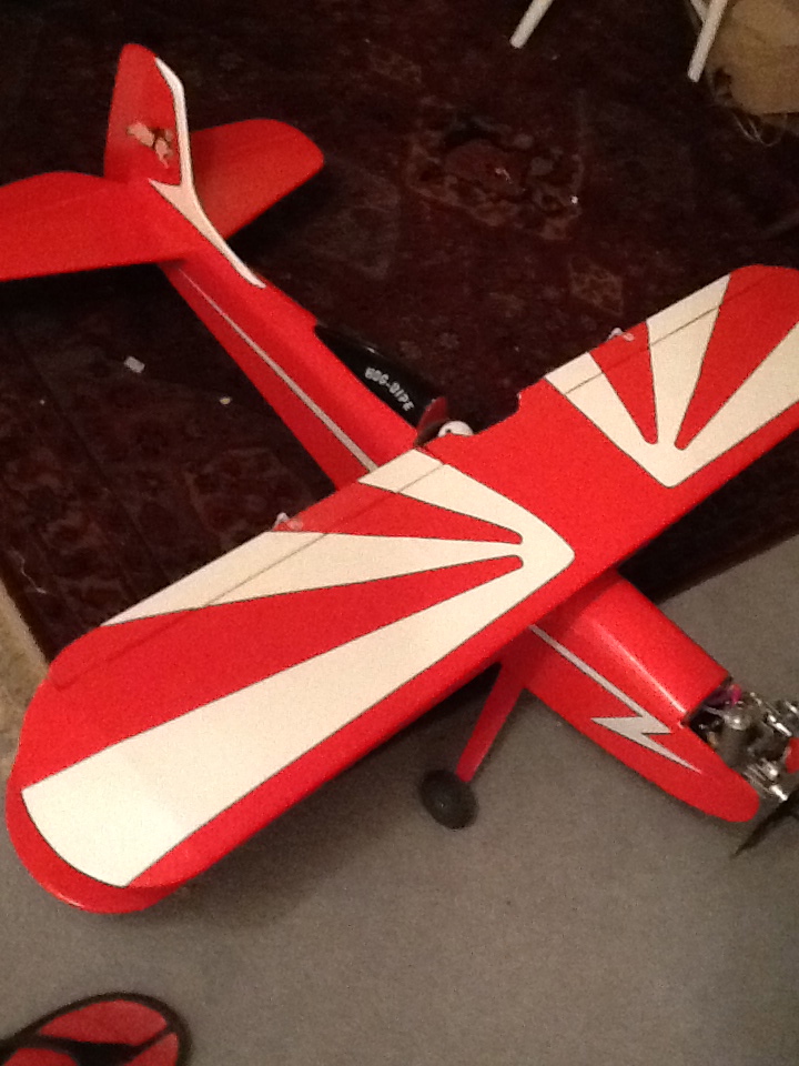

<span style="font-size: xx-large; "><span style="font-family: 'Comic Sans MS'; ">Finished !!!!
<span style="font-size: medium; "><span style="font-family: 'Courier New'; ">Put</span></span><span style="font-size: medium; "><span style="font-family: 'Courier New'; ">it all together and the CG was right at 3 3/4". perfect nothing to move</span></span>.<br type="_moz" /></span></span>

<span style="font-size: medium; "><span style="font-family: 'Courier New'; ">Steve , Thank you very much for your support, encouragement from you and the members of this forum helped me more than I can put into words.
OK maiden report :
Cloudy with a slight cross wind. Assembly at the field went smoothly and needed to take the bottom wing off to adjust the throttle cable. The Saito 100 started right up !!! and ran smoothly . Fine tuned the mixture and set it on the ground. Kept telling myself to get plenty of speed on the take off roll and off she went . A really wild ride ! Took it around for a few laps , very pitch sensitive. So the first landing attempt was a go around only to realize I had limited throttle control. I knew I had to bring in the next one to a full stop as I did NOT have enough power for another go around. It took all of my concentration to get it on the ground in one piece. BUT SUCCESS !!!
SO guess who forgot to tighten the throttle cable cable .
Second flight was just as "pitchy" . In the turns the tail seems to "drag" and stay low . So I think I will move the CG forward. </span></span><br type="_moz" />

I moved the battery forward and I moved the engine as far forward as it would go. now she flys really nice.
