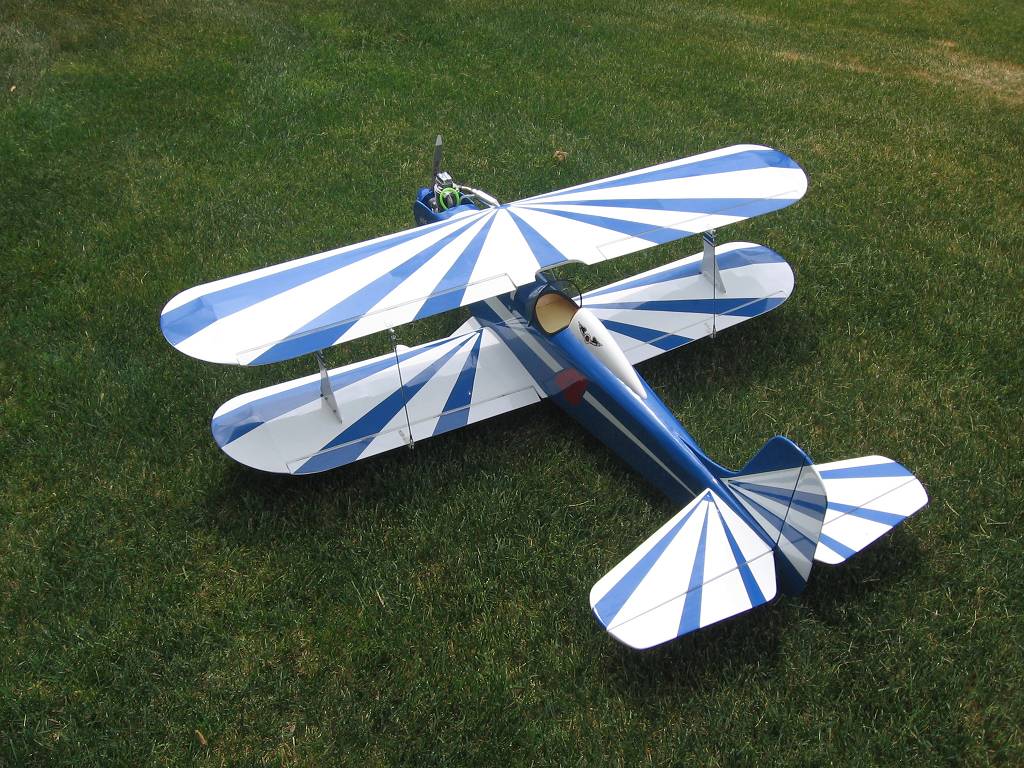

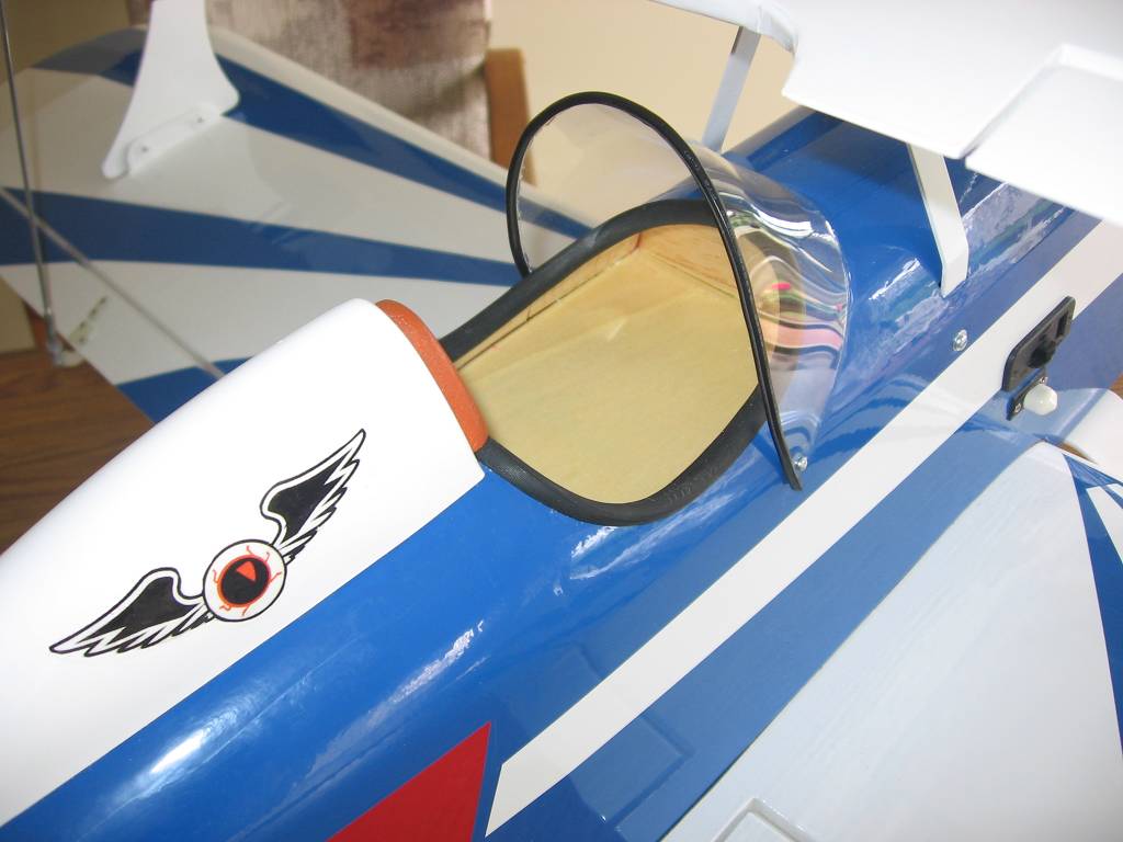

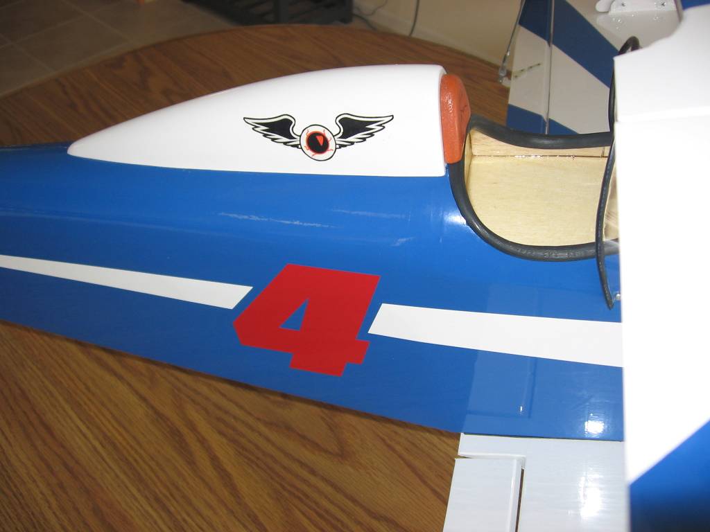

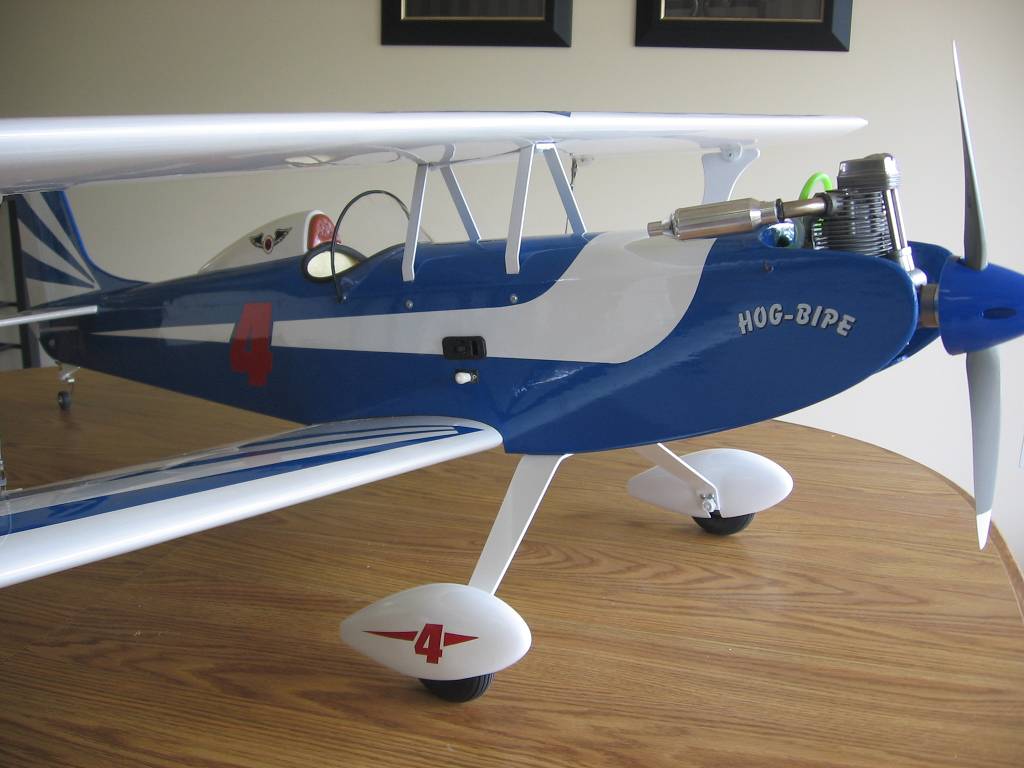

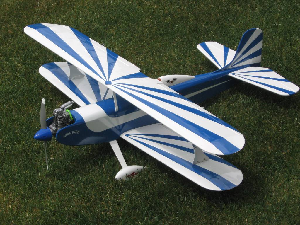

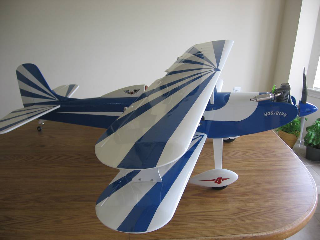

Well, I finally finished my Hog. Haven't maidened it yet, but hope to soon. I'm keepin my fingers crossed.
Pretty much stock except for a few things.
1. Dual Aile servos
2. Moved gear forward 3/4 inch.
3. Top wing bolts insert from the bottom. (eliminating the holes on top of wing).
4. Sullivan tail wheel gear.
5. Battery mounted in front under tank. Balanced perfect with no weight added.
6. Running a OS FS 91 Surpass.

Tacx. Outstanding build! I really suspect that you have out built me from what i can see
Have you had a chance to weigh it? I am curious how you came out there....... I am hesitant to offer good luck wishes after what happend to Squirrel, but good luck anyway, and i will keep my fingers crossed for you. I don't know what kind of airplanes you have been flying or your experience level, but keep your speed up on approaches till you get a handle on the stall speed is about the best insight i can come up with. Best wishes!!!!

Thanks for the compliments. My total weight with batt, etc. is 8.75 lbs. I am an experienced pilot, but this is my first bipe. Thanks for the heads up on the landing speed, I think landing will be the biggest issue. I have no fear once in the air, but landing, as you know, is a whole different animal. I will keep you informed.

You are carrying a little more weight than me. With your twin, on board glow batt., and the extra servo and switch, thats going to add up.
My one concern is the gear. It's kind of flimsy. Has allot of spring to it. I don't care for springy gear. I may have to change it later.

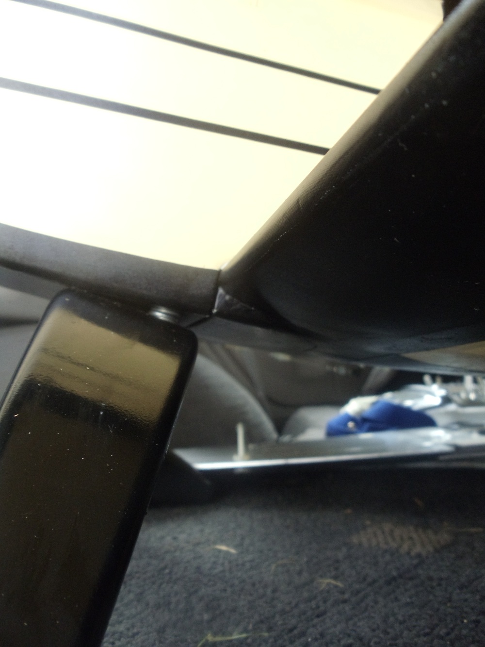

Yup, i know on the weight. That much really makes a difference. ......I got to looking at the batteries i am using on the glow system. Way overkill on capacity by using two of them. 4200 milamp nimh and 2.33 ozs. The specs show a discharge capacity. of 30 amps. Wow. Should be ok to ditch one of them i would think. Both plugs shouldn't draw more than 2 amps. My cg will creep a little forward, but i can be rid of two and a third ozs. As far as the rest of the glow sys, i don't have a dedicated servo. Just a bellcrank, a couple micro switches,wires and plugs . Shouldn't weigh more than a couple ozs. Just a fat girl is the bottom line. Lol, the specs for the hog call for a build weight of 7 to 8 pounds. To come in at 7 would require one of Daddyo's extremely light Uproar builds with just a rock in the nose and a sailplane highstart for power it looks to me. One line of thought i am considering is going with a lighter battery pack of some type and putting a hatch in the tail. My cg is presently around 28-29 %. The 6v hump pack i am running weighs 5 ozs and it is located just forward of F-4. http://www.onlybatterypacks.com/show...ItemID=10429.7 might would work, but would only save 1 oz. Hardly worth the effort it looks to me.
I understand your concern about the gear. I am running the 789 Dubro and I swear it looked like the wheel pants were almost touching the bottom of the wing on some of my 'arrivals'
The wheel pants are hanging in there, but i have been rough on them. As a note to anyone thinking of building this (or any other kit with pants), i suggest running steel axles and landing them in a plate mounted on the outside of the pants. Increases the strength of the assembly tremendously . Without this, i imagine the pants would have already been in the garbage can because of runway belly flops.
Repost of glow setup attached
The wheel pants are hanging in there, but i have been rough on them. As a note to anyone thinking of building this (or any other kit with pants), i suggest running steel axles and landing them in a plate mounted on the outside of the pants. Increases the strength of the assembly tremendously . Without this, i imagine the pants would have already been in the garbage can because of runway belly flops. Repost of glow setup attached
