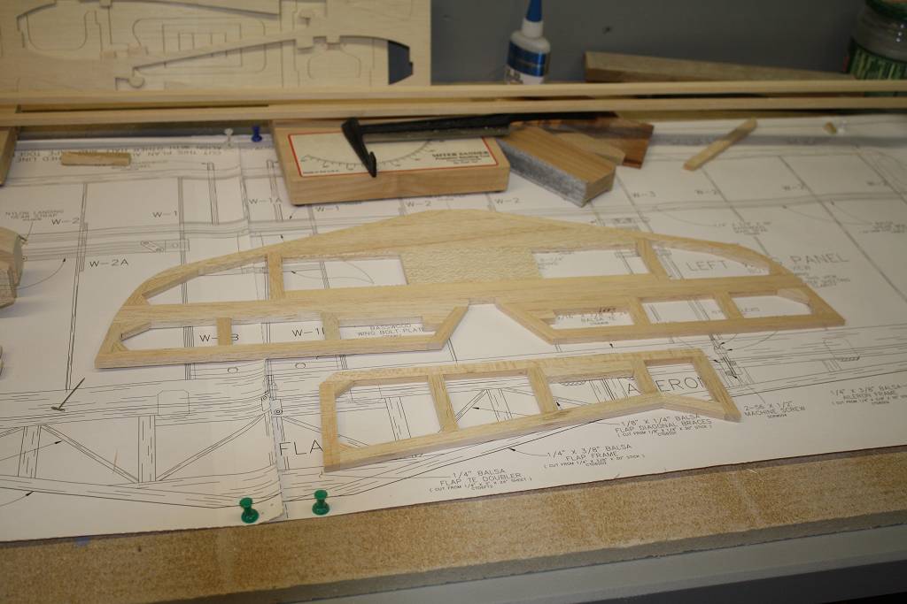

Hi all,
Here is the beginning of my TF Contender build.

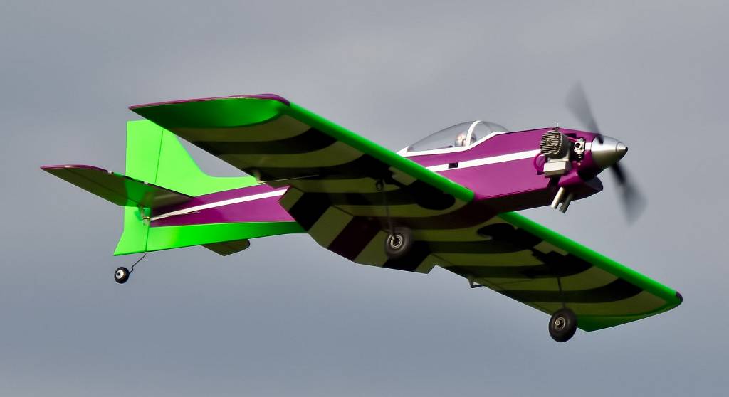

I modded it into a taildragger with retracts, also added 1" to the rudder but kept the original shape. The rudder does cause some serious adverse roll, but I also found that with the flap down it doesn't. You can cruise around with the flap down right on the deck just above idle and it handles great doing all rudder turns. I wonder if that was intentional or just lucky. Two other friends that built them at the same time as me enlarged their rudders and made them like a Cap rudder. They said it helps a bit but does not solve the issue of adverse roll. I'm not sure if it has any effect, good or bad, with the flap down.

Great looking plane smithcreek. That thing must of picked up with the retracts. Its pretty hot with out them.

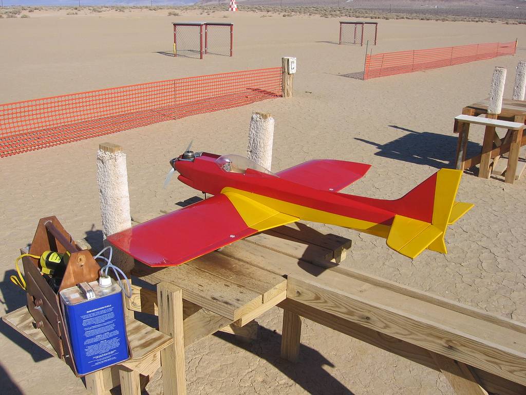

Here is my Contender that I completed several years ago. Powered by a Jett .46, which is more than enough for this aircraft. The upturned wingtips apparently help with the roll-coupling though I haven't played around enough with it to determine how much of an affect they really have.

The adverse roll was taken care of by the upswept wingtips in the instructions. I built mine that way and it was solid as a rock. This was a known problem with the original design and that's why they suggested building with the upswept wingtips if you didn't want the roll coupling. Mine met with a different problem. I was flying one day and a fellow club member turned on his radio and it happened to be the same frequency that I was flying. I had the pin but he made a mistake and my plane paid the ultimate price..........it went straight in at full throttle.............[&o]

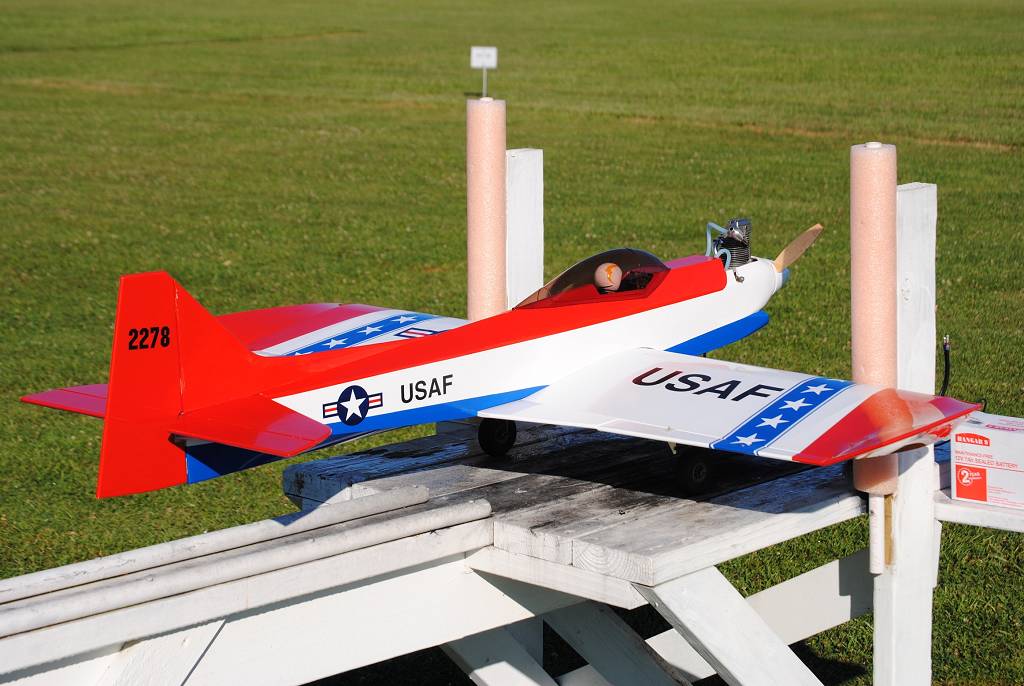

The original Contender was designed to be extremely fast to build. The original kit could have the "bare bones" assembled in 8 labor hours! The wing was flat because you could use 48" pieces for the wing spars and leading and trailing edges. That made it simple and light!. The thick wing made it stronger as well as made it have good low-speed handling. A lot of good ideas went into the original design.
The more-recent kit was re-engineered because all of the original tooling had been worn to the point of uselessness when Top Flight was acquired by Hobbico so many years ago.

When I built my Contender I had read about the issues with the adverse roll so I built the upswept tips and added to the bottom of the rudder. This seems to have corrected the adverse yaw problem. I can jab the rudder stick back and forth and the plane will just wagg it's tail and no tendency to drop a wing. Rolls are nice as well.

Here are a few pics,
I left the top of the rudder the same chord and doubled the chord at the bottom of the rudder. The problem with the original rudder design is there is 70+% of the rudder above the thrust line, as rudder is applied the plane will roll opposite of the rudder input(left rudder=rolls right). The change I made in the rudder brings the surface area lower on the rudder and closer to the thrust line.
I just drew the change out on the plans before building. I sent my plans to a buddy who is supposed to put them into CAD and laser cut 2 of them in a 30cc size.
