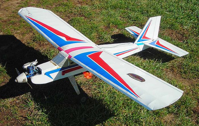

You will like the LT40 kit, I built one myself but made it a taildragger with bolt down wing. I have a build thread on this forum too, if you want to see the bolt down mod. Only extra needed parts is 1/4" plywood, and nylon 1/4-20 bolts. I used the dowels that came with the kit for the guide pins.

Well I had my first flight with the LT40 today with an OS 52 Surpass 4 stroke. The plane is one sweet flyer. Man I am just thrilled with it. Now if I can just get the engine tuned right, this will be my go to plane for sure.
The one I built is modified though, with 1 inch Dihedral, and it is a tail dragger, but even with that it is very stable and gentle, it doesnt have the self righting that the stock one does, so banking turns are nice, just pull the one wing down a bit and let it go, the plane just holds that turn until you move it back.
Man what a great 2 flights I had with it today. I highly recommend it for both building and flying.
With the 52 in it, takes offs are 3/4 throttle, leisurely flying at just under half throttle. I dont know what it will do at full throttle, the first time I went full throttle after a few minutes flying the engine quit, so I had a dead stick landing, but it settled in and landed on 3 wheels in the soybean field without a scratch. I wish I could say the same for my second landing, but not going into great detail on that, just going to say I had some mud to wipe off the nose cone and prop.
The plane is the biggest one I have flown so far, so I need to work on my distance judgement, I came in too far out. but it lands so nice and slow.

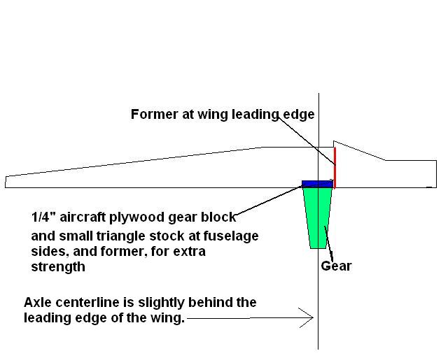

Engine choice will always be a debate. I would use a Thunder Tiger GP-42 or OS 46LA. These engines are 'relatively' inexpensive, easy to run and maintain, and perform very well on trainer planes.
Some say 'buy a more powerful engine so you can use it on the next plane' but I disagree. My opinion is to keep the trainer totally intact and get all new stuff for the second plane. That way you have two flyable models.
For a tail dragger conversion on a different model I glued a 1/4 inch aircraft (lots of very thin plys) plywood in the bottom of the fuselage. I used this gear http://www3.towerhobbies.com/cgi-bin...?&I=LXNM65&P=0 attached with nylon screws. The way the tail of my plne was designed I installed a pushrod to steer the tail wheel. I have no experience with wheel pants.
For a first build I would not deviate much from the original design. Walk first, then start running.

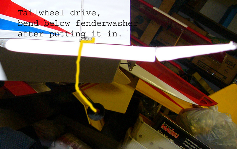

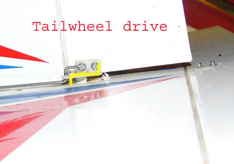

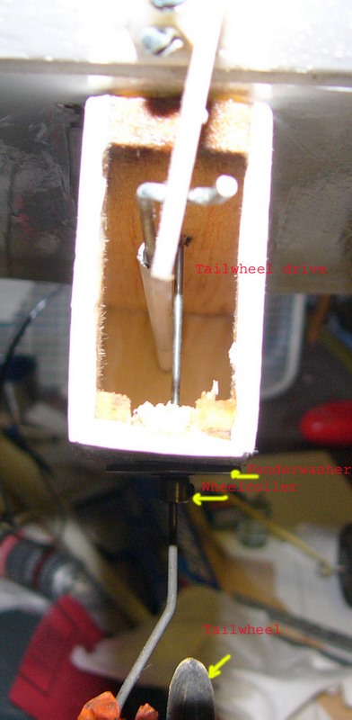

I have a build thread under kit building detailing the plane. Look for Kadet LT52 mod. I have some pics of the mods I did. <div>
</div><div>You need to use a pushrod for the tail wheel since the rudder is above the elevator, so tying the tail wheel to the rudder would be difficult. I had a tail wheel from a TF P-51 that I wasn't using and it has the link inside the fuse. It was a little tricky to get it installed, but it worked. Actually worked better than I had thought it would, the plane ground steers much easier than either of my tri gear planes. </div>

soarrich,
You are right. Ideally the axle centerline would be even with the leading edge, or slightly forward, for best handling and reduced nose over tendencies. With a kit build I think it would be easy to put the gear mount exactly where you want it.
My conversion was a Big Stik ARF. I probably could have used two smaller ply pieces (one in front of the bulkhead) but it never tried to nose over with the location I settled for.
