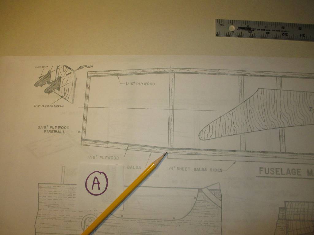

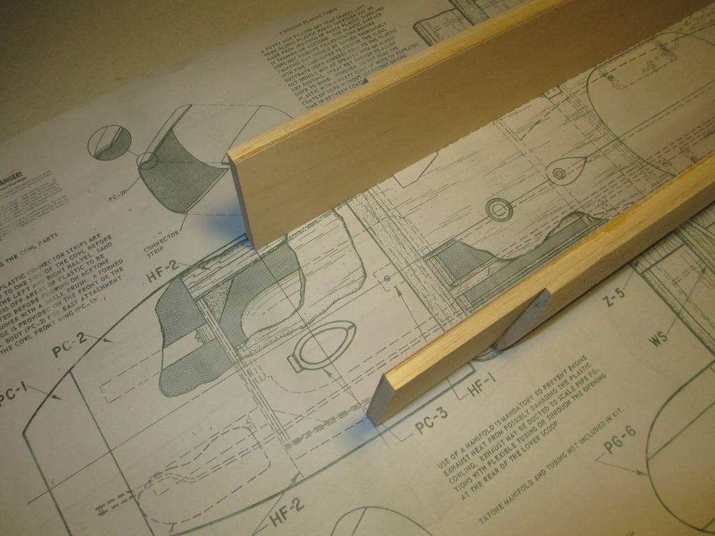

Today I decided to actually start to cut some balsa! I decided to start with the left and right fuselage sides which are made up of a framework of 1/4" square stock which is sandwiched betweena 1/4" thick cresent shaped outside balsa sheet and 1/16" plywood doubler for the inside.There is also a 1/4" front fill-in piece which will ultimately be secured to the firewall. This is where I would like to focus your attention to (Pencil A in photo).Instructions will have you glue up this whole assembly flat on the building table, when in fact the plans clearly show that they are angled in toward each other. This seemed odd to me so I studied the plans some more and still came up with the conclusion that the instructions must be wrong. Reading well ahead the mystery was then revealed...After the fuse side is assembled you are to then take the firewall and<u>bend</u> the front fill-in piecesso that both sides can be epoxied in place to the firewall. Now far be it for me to criticize but my gut is telling me that this is not going to bend but crack and break! I would highly recommed that these pieces be glued up inthe shape that is shown on the plans and not bent. I did neither as you should be able to see in the photos that by moving the firewall back I was able to keep these fill-in pieces flat and far enough away from the inside of the cowlmaking this area much more secure.</p>

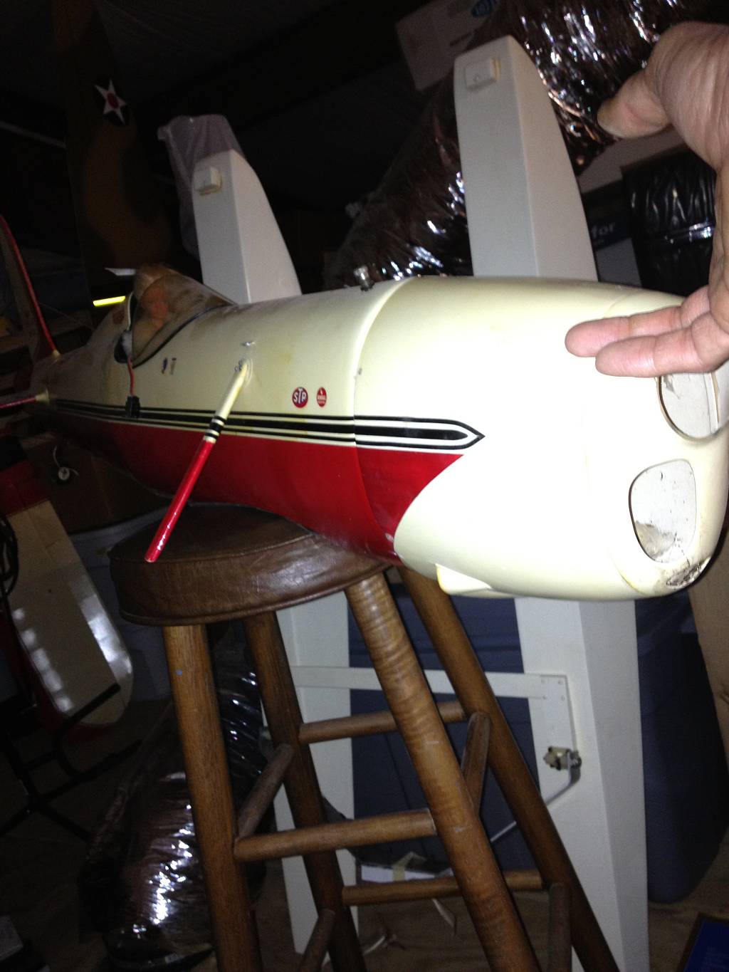

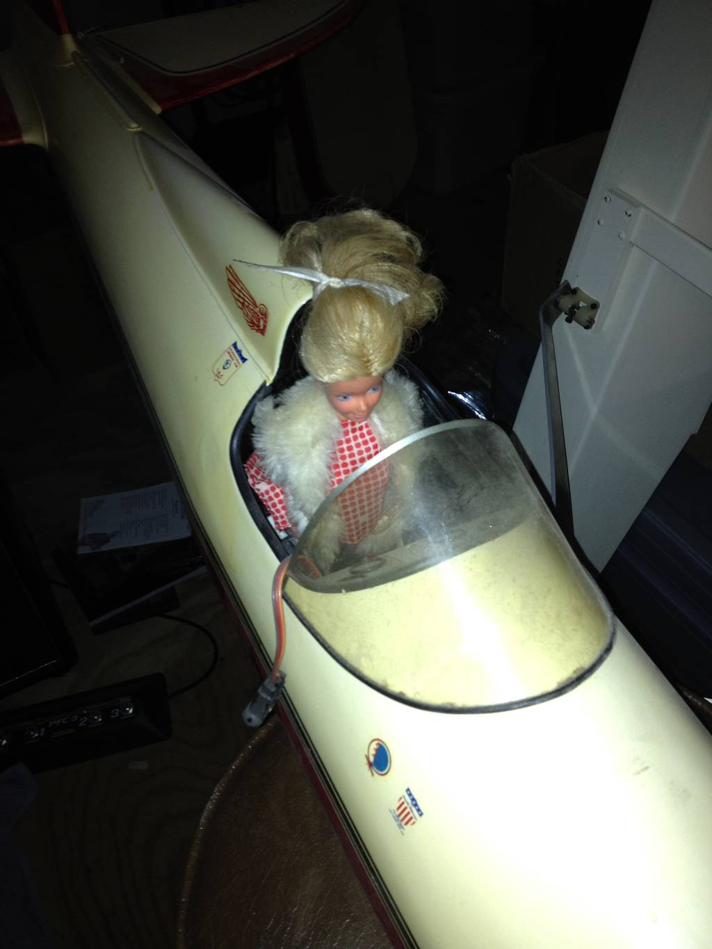

here VJ...gonna restore it one of these days and will go with the English military camo colors when I do

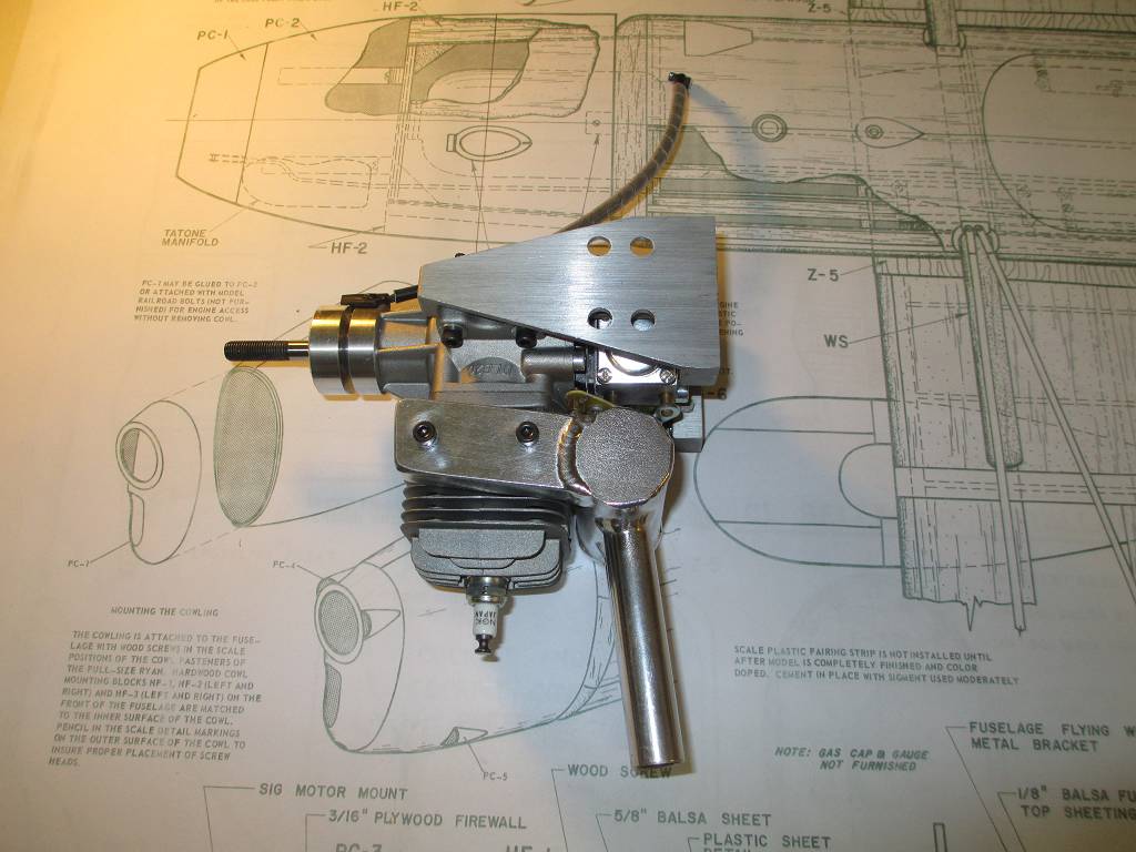

Robert no need to get the exhaust tapered like on your Cub, this one fits with plenty of room to spare!
Granpooba, here are the photos you wanted to see.

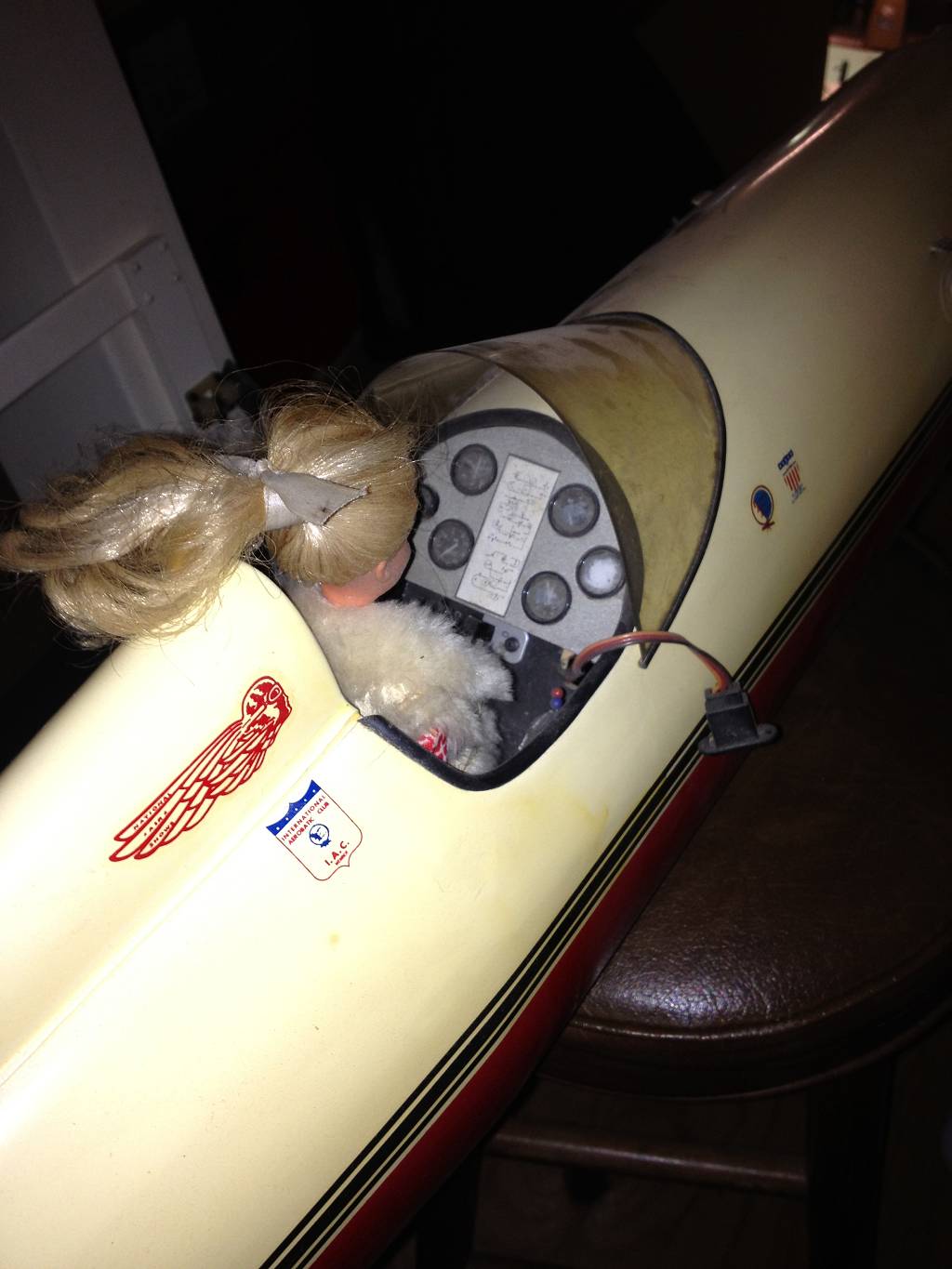

here are some more

Jimmy looks like a project worthy of restoring!

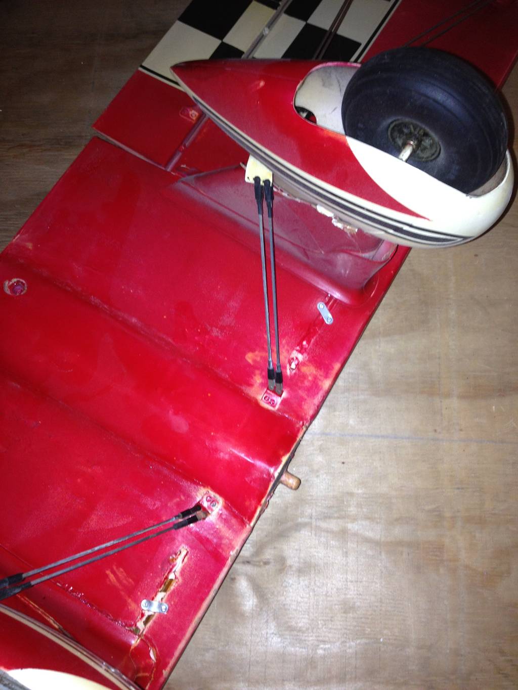

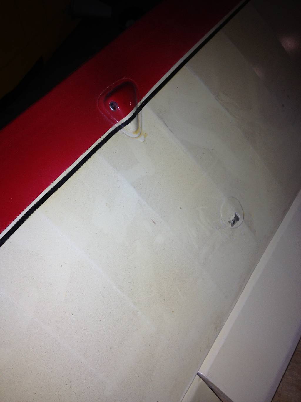

last ones

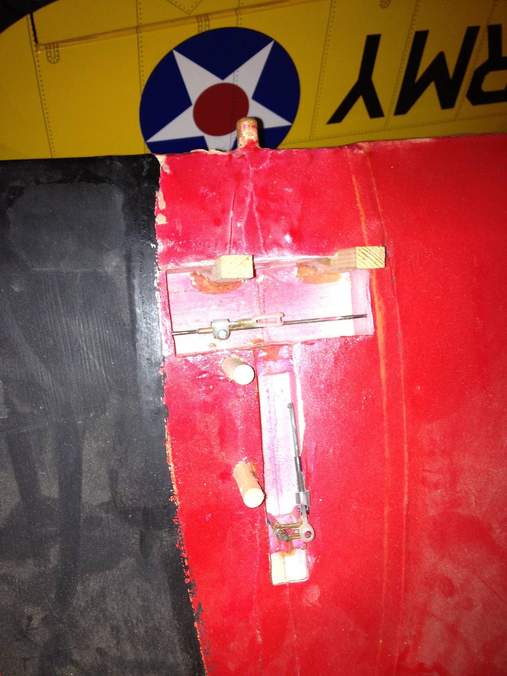

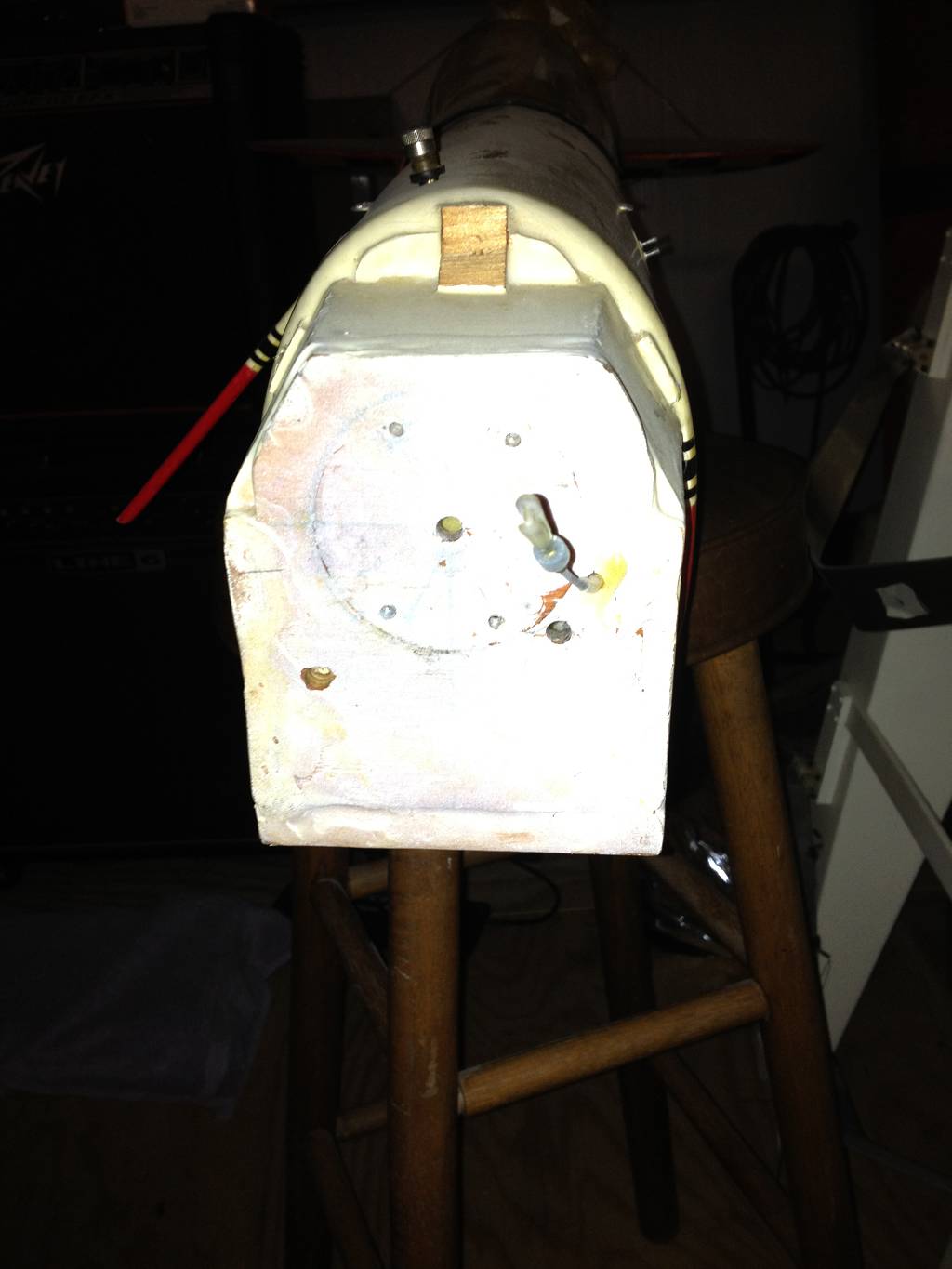

It was powered by an inverted Supertiger .75 mounted with an Edson adjustable mount, which I never had any trouble with....they are made form aluminum. The model had plenty of power but if you wanna gasoline, and I would, you might look at the NGH 17 from Agaperc. Looks to be a good engine.

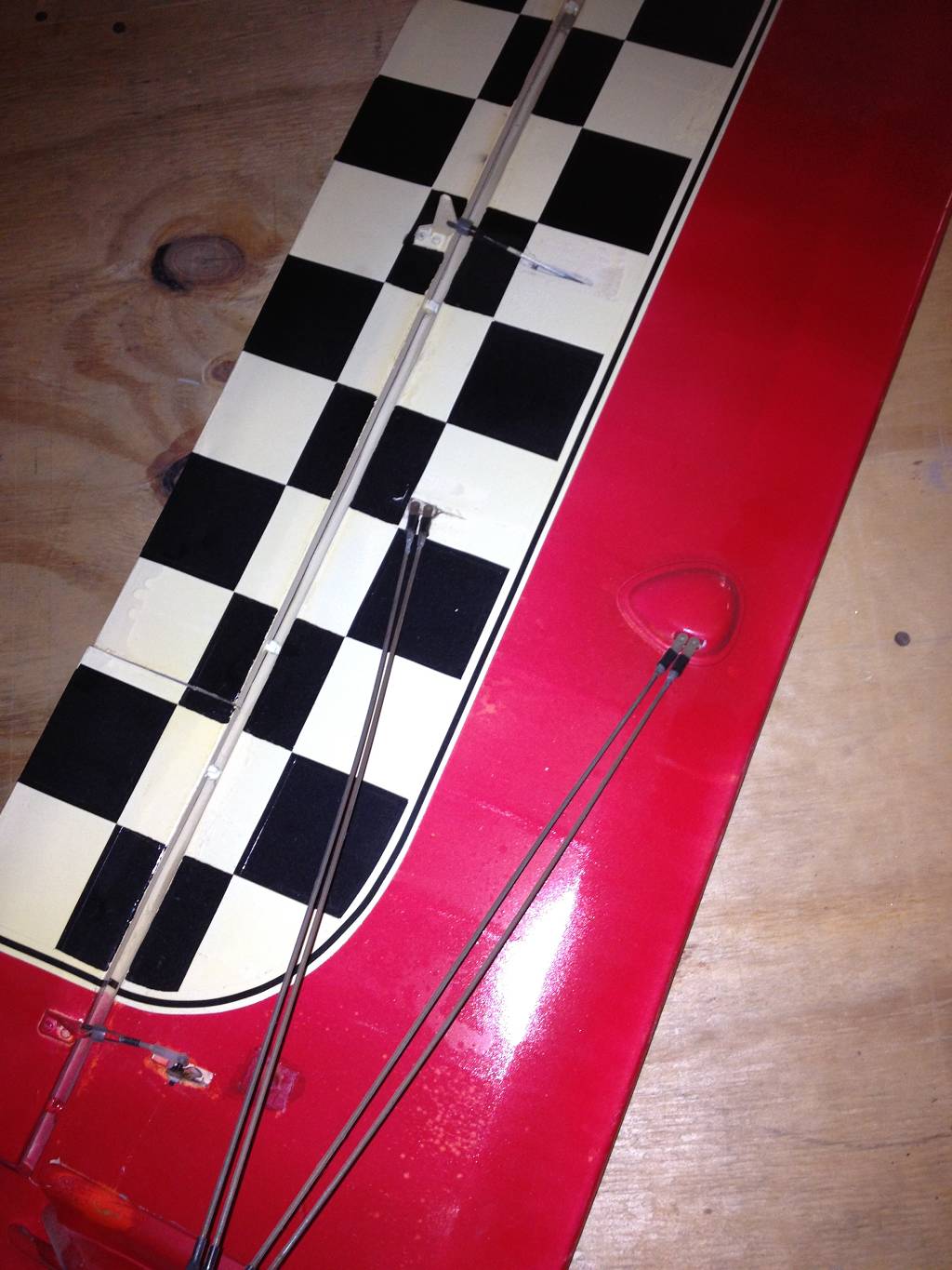

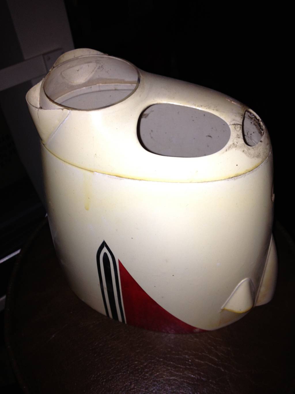

Ya I called Sig nine years ago and purchased all new fairings, cowl, flying straps (they are not wires that it come with), and decal sheet. I have everything original to go back on it

BTY...the bellcranks will go into the garbage can...thats all we had 30 years ago

Hey Jimmy those photos are great! When you get ready to restore your Ryan make sure there's room in the budget to get Barbie a new hair dew.....LOL

Ya I'd say she's due for a new do

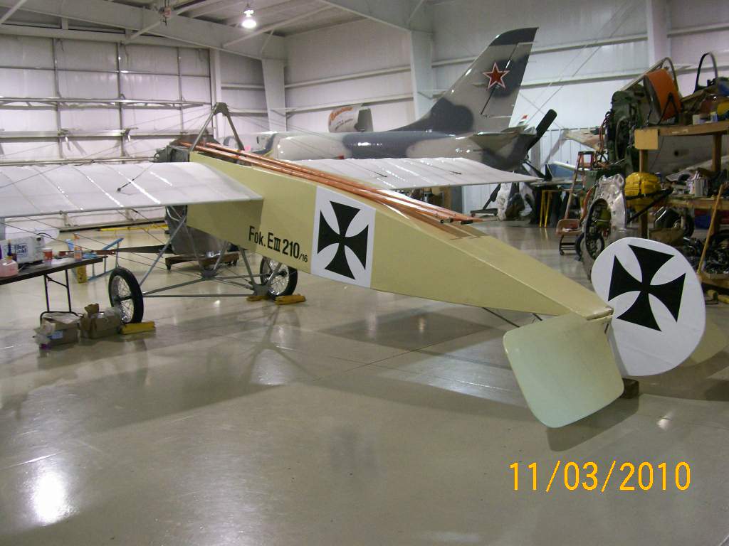

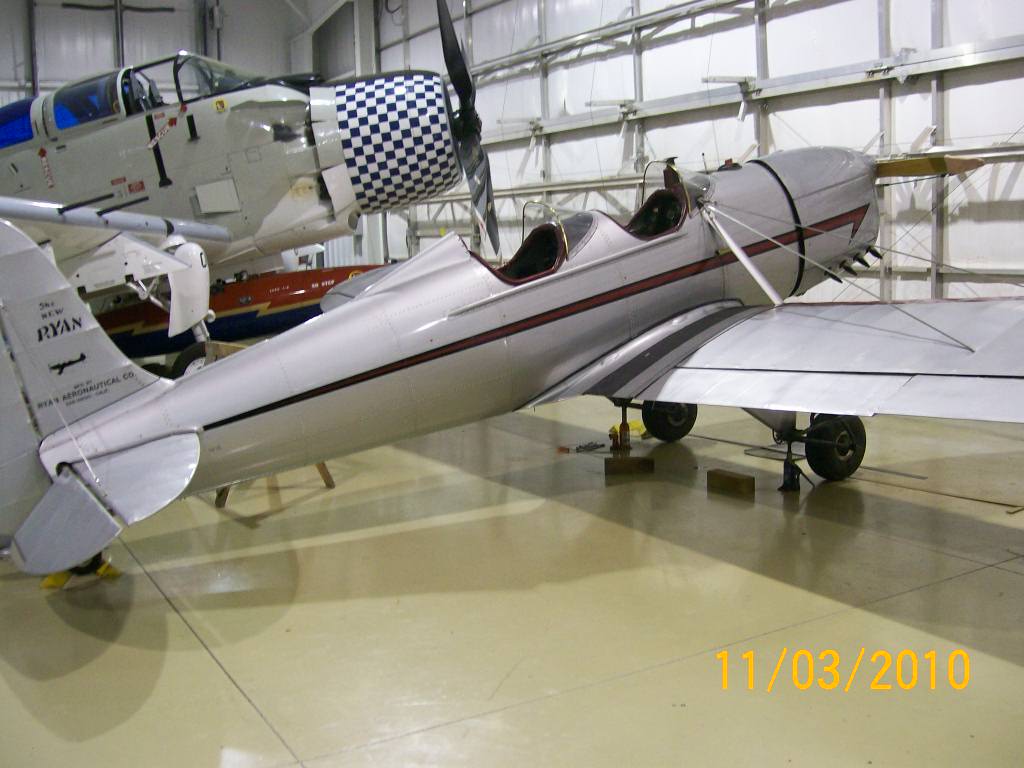

Also, in OKC at the Wiley Post Airport, there is a full scale RYAN STA in the Oklahoma Museum of Flying, off of Rockwell, first street south of NW 63rd. The Miss America P-51 is in the hanger and they are building a full size WW1 German E-III replica. Stop by and talk to the friendly mechanics. The Museum is open during week days and 1/2 day on Saturday. Donations are Welcome.

Ken thanks for posting those pictures, they are awesome. Next time I'm in OKC I will be sure to stop by and check it out. I would love to photograph more angles of that Ryan.
