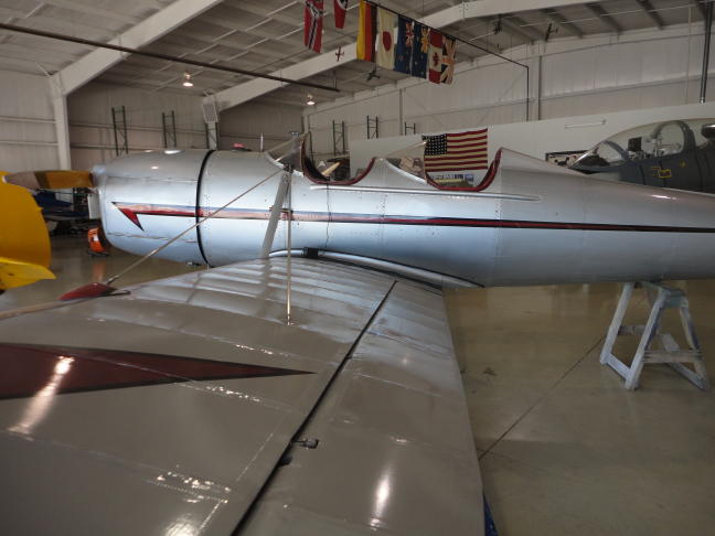

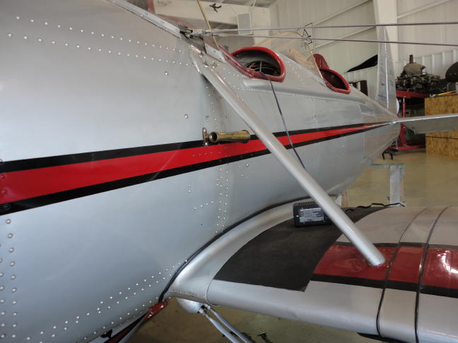

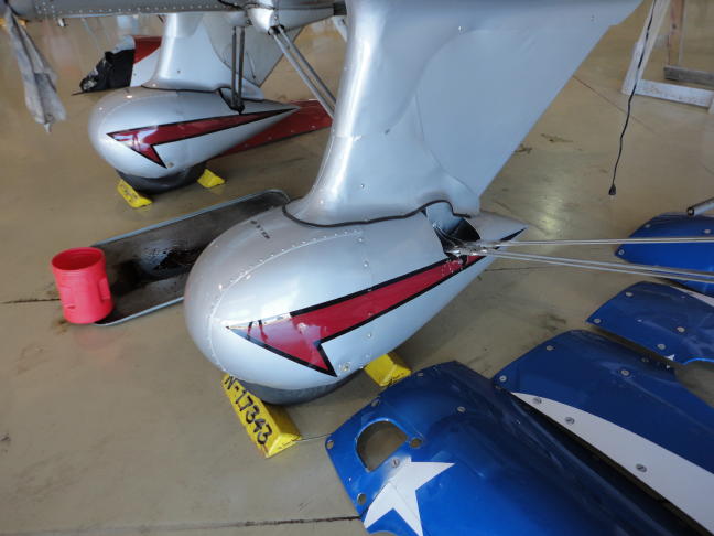

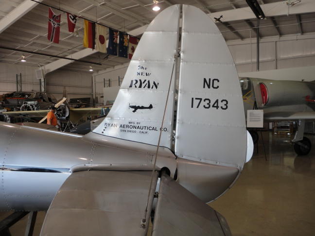

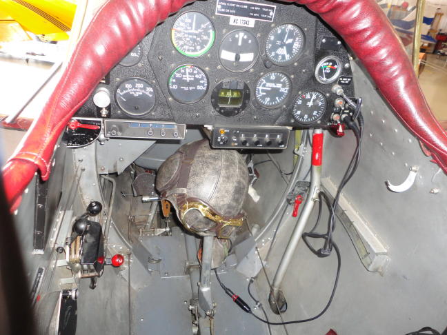

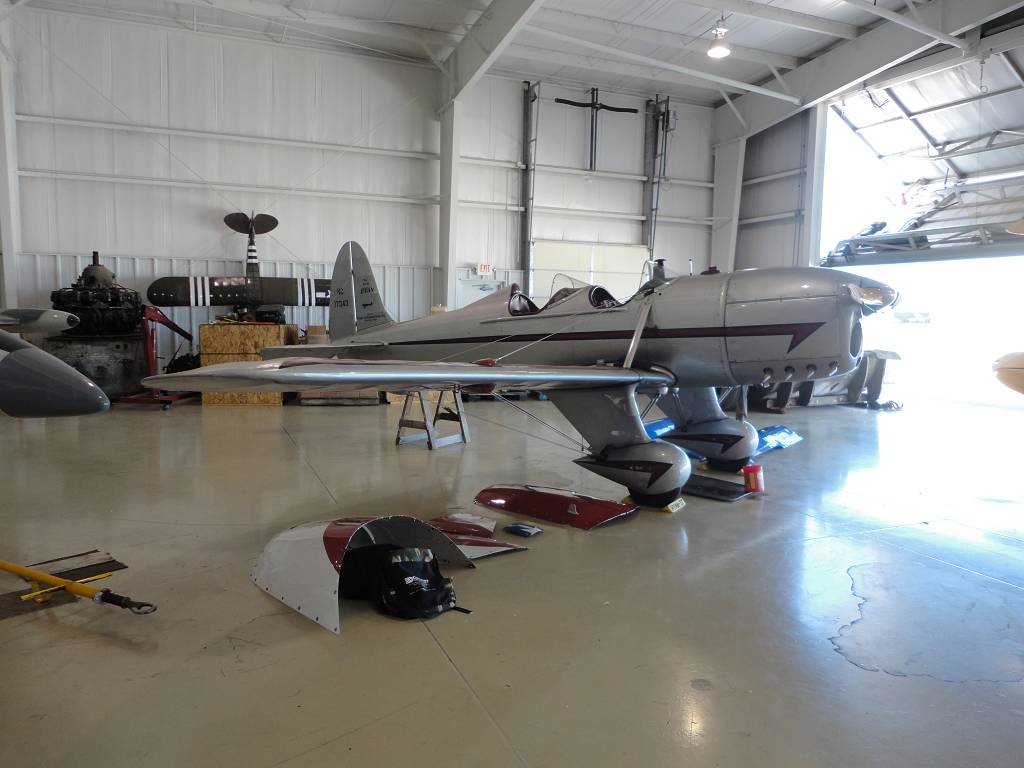

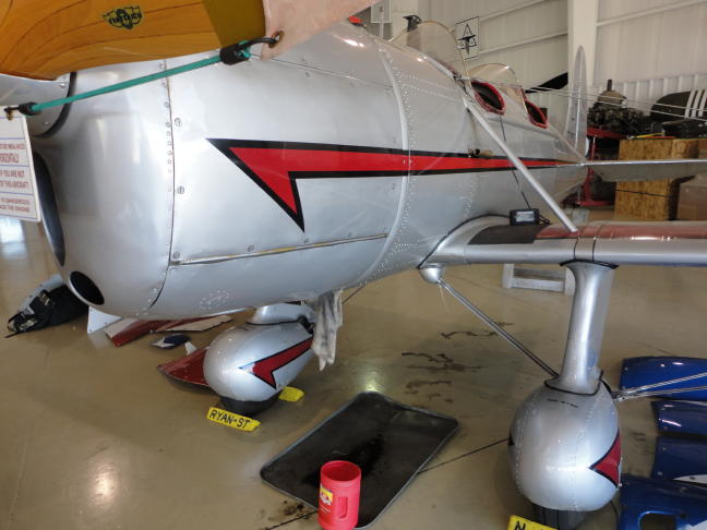

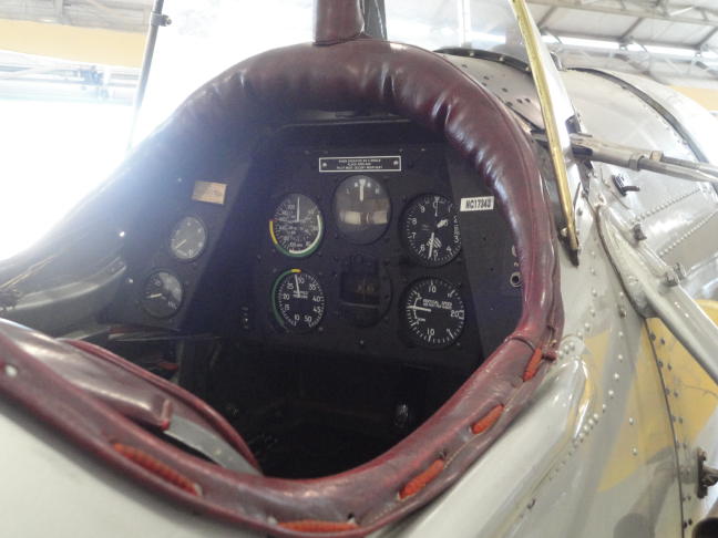

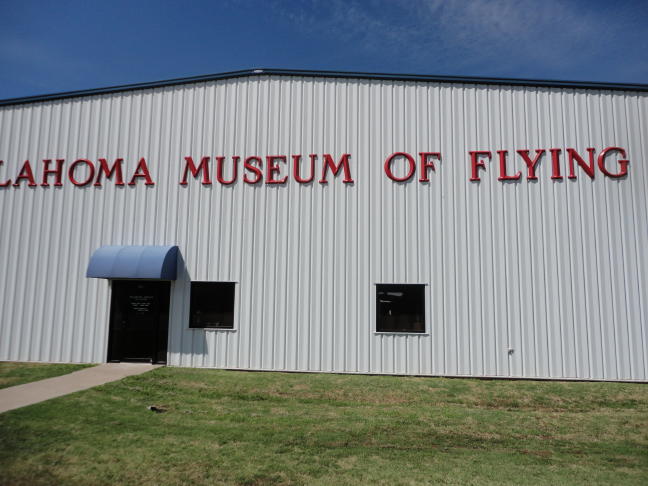

Hi Vincent J and other STA-STM Builders:
Here are a few more photos of the full scale RYAN STM in Oklahoma City Wiley Post Airport.
I'll post what I can and send you the file if you would like. Send me your e-mail address if you would like a copy of the photo file. I also own the Harold Osborne Model plan Service, I'll send a listing to your e-mail address if you request it.
Ken Kehlet [email protected]

Nice pics! Is it normal for planes to leak oil like that? Thanks for the pics!

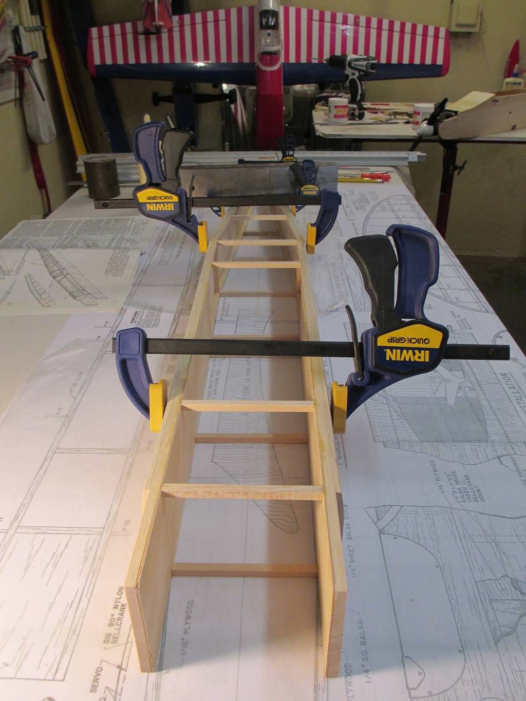

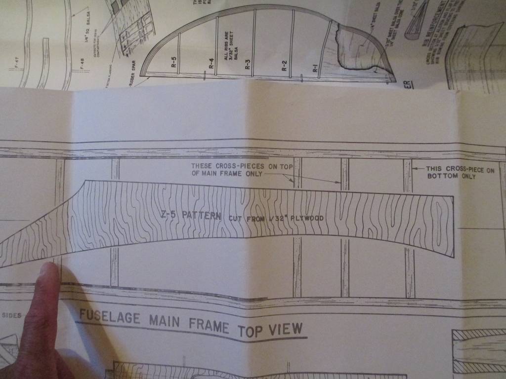

When placing the cross piecesthat attatch the left and right main frames together, I noticed an error in the plans (plate #3). In the photo below notice that some of the cross pieces occur only on the top and others only on the bottom. The crosspieces that are not identified for the top or the bottom only are placed on the top <u>and</u> bottom of the main frame. Have I confused you yet? Notice where my finger is pointing, you do not see and warning of placement position,if you assumed that this crosspiece would go in both locations you would be wrong, it on goes on theBOTTOM main frame only. Why didn't they label it on the plans like the others? I hope this may help others getting ready for this build.
When building the main frame take care to make sure everthing is true and square as this is the foundation of things to follow......

Sorry forgot the photo!

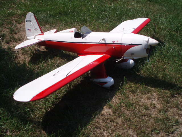

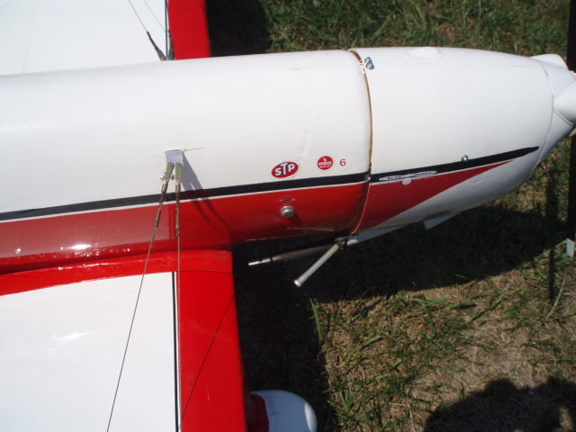

I have a RYAN STA by Sig. It took forever to build it exactly the way it is shown in the plans. The bell cranks work just fine so why change a good thing? The only things that gave me some difficulty are the plastic parts like the cowling and wheel pants. It might be much easier to just purchase the fiberglass ones that are currently available. The flying wires were also problematic because the ones with the kit are aluminum and I did not know how to solder aluminum and I did not trust epoxy to hole them in the clevis'. I'll try to post a few photos of my Ryan; I flew it today.

I want to add that there is a Supertigre .90 (Italian) for power and all basic Futaba servos.

FCABARLE, very nice job on your Ryan.How long ago did you build it, and what did you cover it with? You should be proud of your work, I believe you when you say it took you a long time. It's not for faint at hearts to build. Does your Ryan exhibit any nose overs/ground loops?

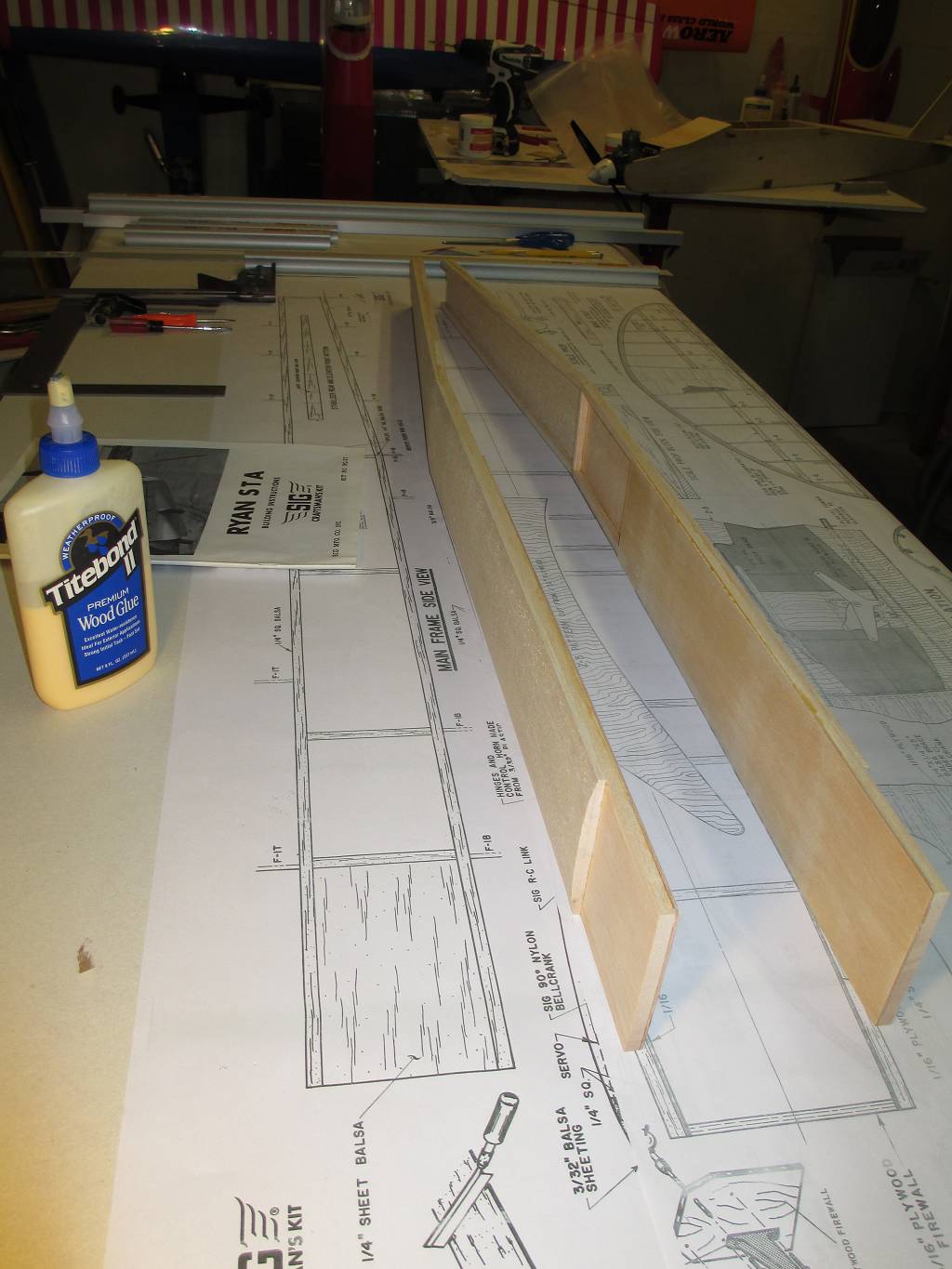

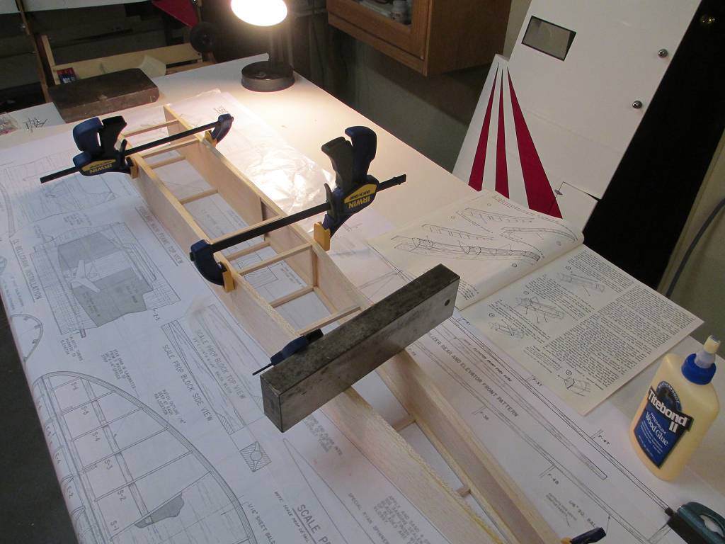

This morning I started to glue on the bottom formers (F-1B, F-2B, F-3B, F-4B and F-5B) to the main frame. I suppose there many ways to accomplish this but this is the method that I used. I have a piece of machined steel approximately 2 1/2" x 10" x 1 1/2" thick which I use quite often during building. Had it for so long I don't remember where I got it from. By butting up each Former to this piece I am assured that each Former is glued up at exactly 90 degrees to the main frame. I let the glue set-up for 20 minutes before I move on to the next Former. Slow but it works great, anyway who's in a rush were suppost to enjoy the journey!

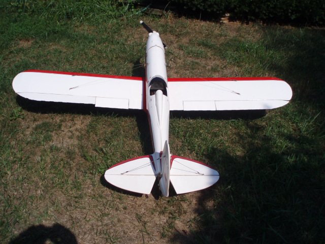

Joined: Mar 2011
Posts: 4,994
Received 186 Likes on 166 Posts

Photo #2

Never any problems landing or taking off. This airplane flys like a trainer, slow and stable. I've never deployed the flaps on landing, the airplane floats when landing. The bellcranks work just fine and I would follow the plans if you are not an experienced builder, but if you are talented I might go with a servo for each airleron. My airplane is covered with monocote with exception of the tail feathers which are some kind of iron-on fabric and painted. The bottom of the wing has a check pattern. At the time the local hobby shop had only the smaller checks so I used it; I would have prefered the large checks like on the full scale airplane but no one has noticed the difference. It would have taken just too much work to cut squares out of the monocote and place them onto an all white covering under the wing. A lot of people have commented about how nice it flys and how neat looking the color scheme is.
Did I mention that I have two of these airplanes? The other is already covered; all in ultracote and it has the large checks under the wing. I have to install an engine. I have difficulty finding a muffler for it because the cowl is so narrow and I really did not want to alter the smooth lines by cutting holes for the muffler. On my first airplane I used a Tatone "muffler" with hoses to extend the exhaust out of the cowl. It works fine but the "muffler" is nothing but a header so its loud. Sorry, no pics of the engine and muffler at the moment. I'm anxious to see photos of your completed airplane.

Yes, we are supposed to enjoy the build. I like the steel block idea too, if my calculations are correct it weighs approx. 10.5 pounds, perfect for holding down the structure and keeping your formers square. I too use as much Titebond as possible, it is slower but it adds very little weight when dry, is very strong and much less cost than ca. The bellcranks are fine if they are set up slop free but personally, today, i would go with seperate servos.

Found a few more errors in the plans and building instructions tonight. After all of the bottom formers were installed the instructions direct you to glue a 1/8" ply former (Z-1) to the front of the second F-1 former. OK... there is a nice schedule on Plan #3 that shows all of the Formers except - yes you guessed it Z-1 no biggie just annoying. The other mistake is that Z-1 is supposed to be 1/8" thick, the Z-1 ply is actually 3/32" not 1/8". Again no big deal just not acurate. Hopefully anyone building this model in the future will have this info.... Note: the side strigers are left long as I like to trim them all flush by sanding when they are all glued in place. Ply Z-1 is visable in the photo.
